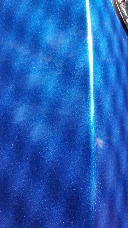

Patches of what looks like respray / fingerprints on bootlid
I noticed this when I first got the car a few months ago, I thought maybe it was a greasy mechanic's hand, a quick polish with the colour magic and it seemed to go away, but yesterday I shampooed it and today in the sunshine I can see it is back.

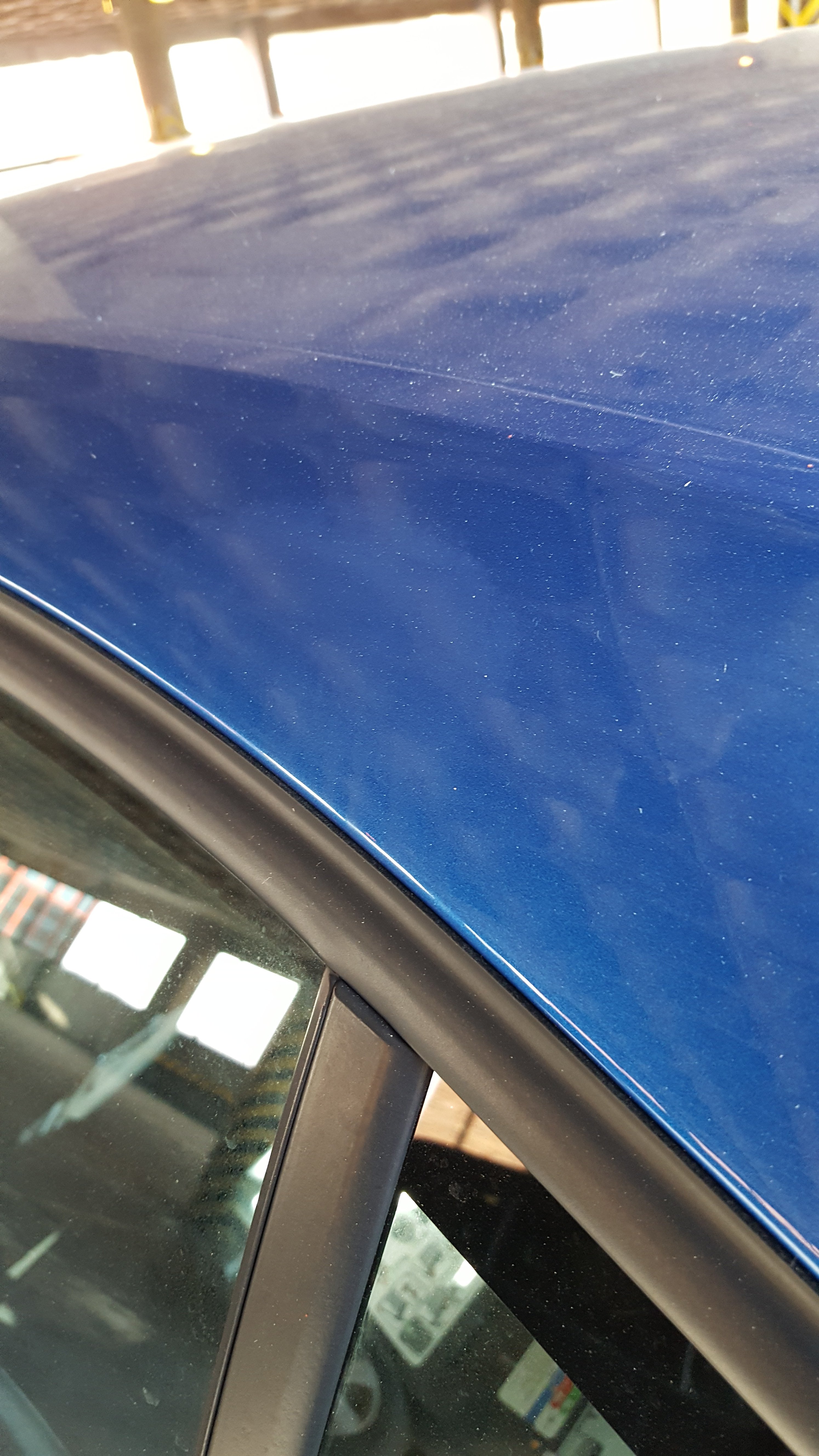

Basically, the top of the C pillar, there is a patch that almost looks like a bad respray that has ran.

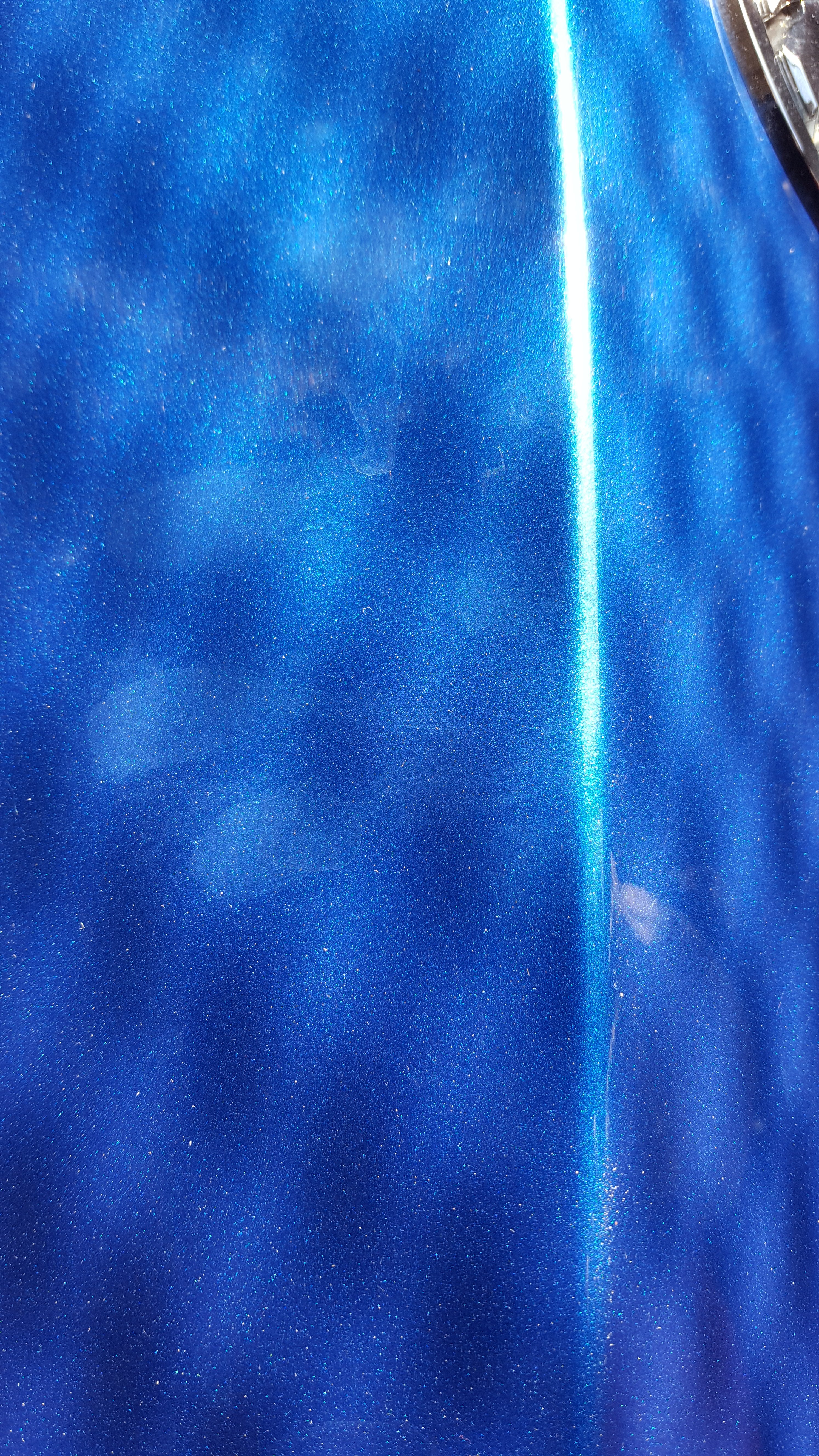

Also there are fingerprints on the bootlid, look similar.
(I have read elsewhere that fingerprints can be caused by suncream etc.)
I'll try and get pictures, if I can capture the light correctly with my camera phone.
Would there be any tips for remedying, or at least blending these defects?
I've read that Autoglym Super Resin does a good job. I'm loath to use T Cut.
Despite being cleaned yesterday the car is dirty and sand dust covered again.
But you can see the bad patch on the pillar, and the fingerprints
First pic looks like a flatting mark - someone previously may have attacked that area with some wetsanding action to remove bird lime etching or similar.
Bootlid does indeed look like suncream defects but these would usually be a creamy white colour rather than greasy marks.
Both can be rectified with some localised machine polishing - would probably take all of 20mins.
Please don't use t-cut it is one of the most abrasive polishes available to everyone on the high street - you'll make both area's far worse.
Super Resin is ever so slightly abrasive but contains a ton of fillers so should be viewed as a paint cleanser rather than an abrasive polish - this make temporarily fill/mask these defects but they'll reappear after a couple of washes and in doing so washing away the fillers.
cheers
Chris
Those finger prints look like oils either from children's fingers or moisturisers.
I come across them all the time, normal locations are as on yours, the top of the doors, B pillars, bootlids and rear wings. Trick is to use a polish and keep going. Use the polish till the cloudy marks have gone, and then continue for a few more wipes. If you don't, it'll look like it's gone for about a week or so. It's annoying but other than constantly telling children to only use the door handles and telling the other half to use the door handles because her favourite hand moisturiser is leaving marks and the ensuing argument isn't worth the hassle.

Thanks Chris.
The C pillar from the first pic, it isn't really visible from the pic, but it looks like whatever it was has run, like a liquid. Perhaps as you say someone has wet sanded.
We have a section on the wing of my wife's Leon where bird dung was left too long then scrubbed off that has left it matt, it too needs a good rectification.
Could the bootlid fingerprints be oil, as in the car being worked on before I picked it up?
Have been warned off T-Cut as it seems to be harshly abrasive on paint on modern European cars. I've had the bottle for years but might consign it to a "do not touch" / "Japanese car paint only" section of the garage :)
Don't have a machine polisher, might phone round some bodyshops.
Did get rid of them temporarily after a quick wash with a tiny amount of super resin, polish, then wax. But as you say, like last time I got rid of them, they'll be back.
