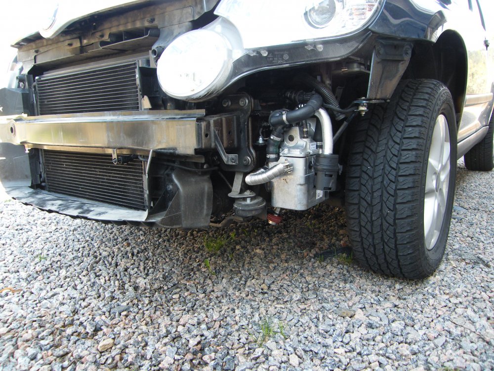

Will this do?
Perfect thankyou
1 hour ago, 175GDY said:
Will this do?
[OT] 175GDY - That looks like serious rubber.  Could you say what?
[More OT] They are Yokohama Geolandar A/T-S 215/60R16. I thought they would be noisy, but actually they are not. The deep tread pattern make them quite soft when new, but as they wear down the steering gets more precise. I seriously considered buying same again, but now the Yeti is up for sale. Replaced by a 2017 Mini Countryman Cooper All4.

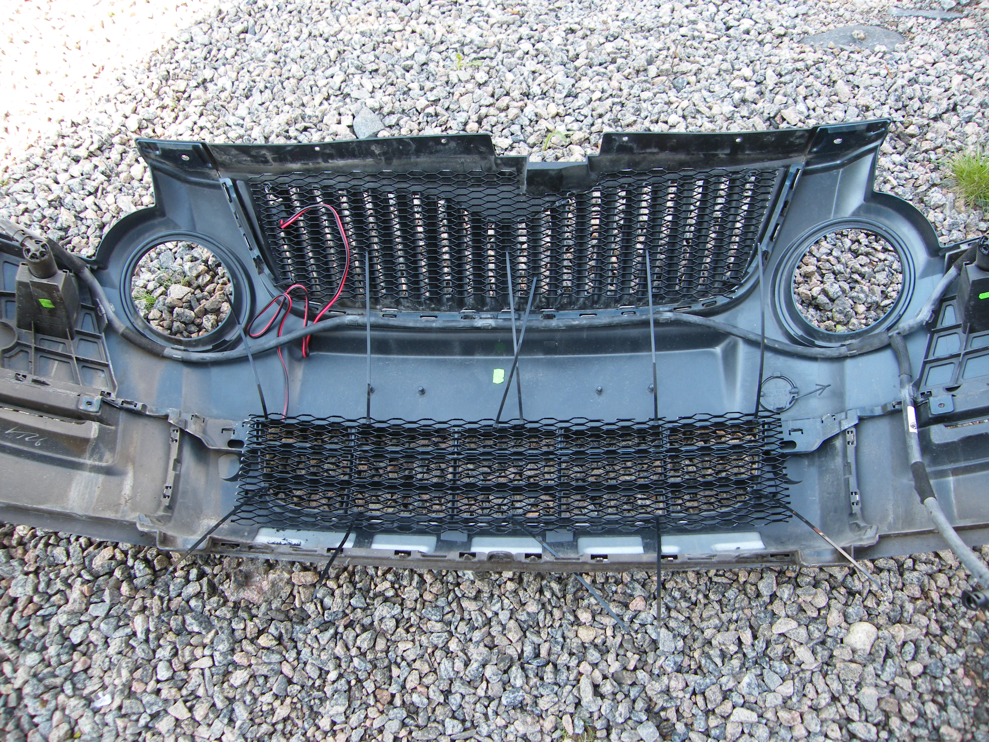

I never removed that lower part of the grill. Here you can see what the rear side of the front bumper looks like. Can't tell if the grill can be unclipped from outside.
2 hours ago, 175GDY said:
Might try and give it another bash tomorrow. I can't really see how clips out. Lol
Can I put my bumper back on now? :D
Lol. U may
