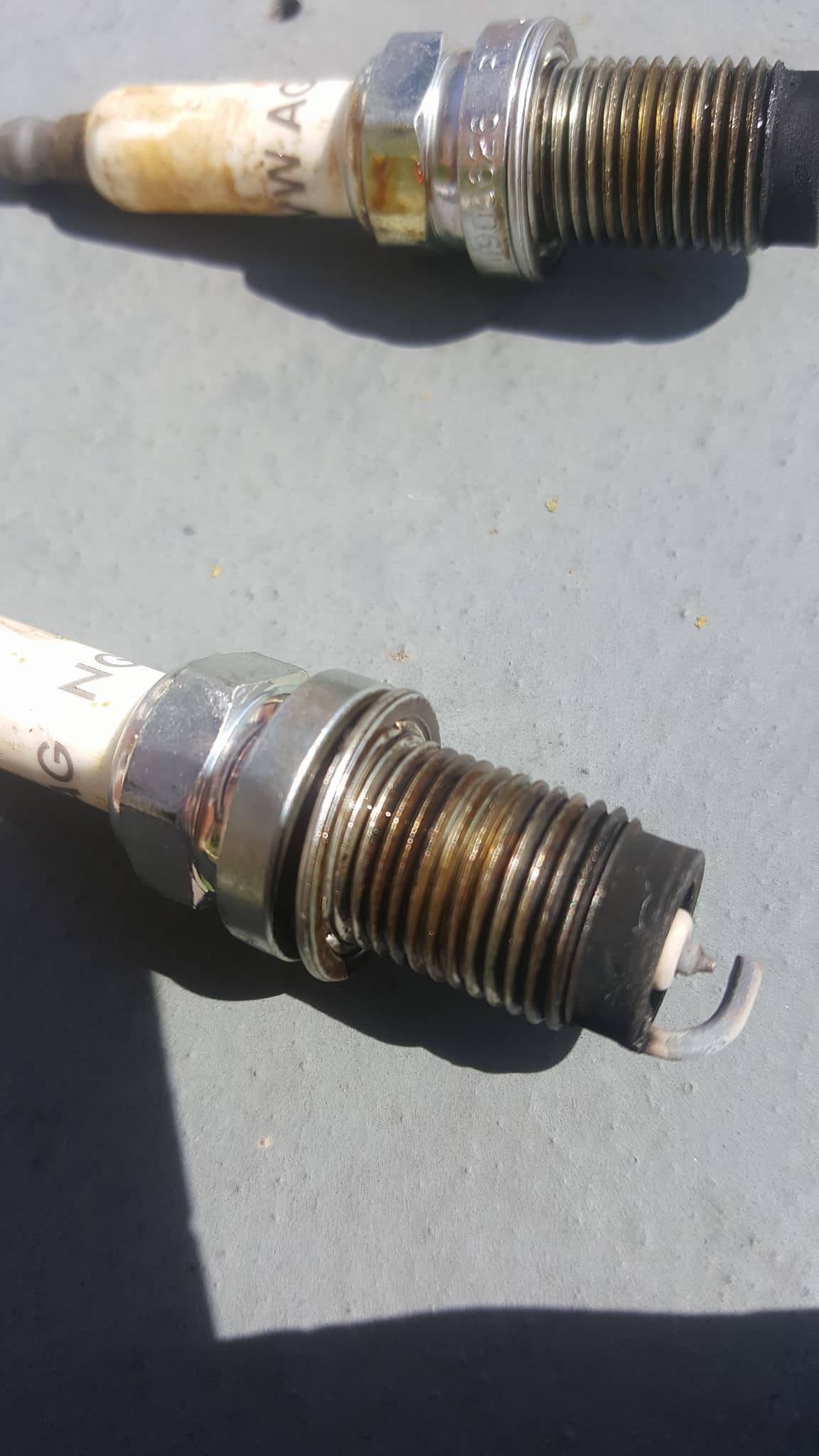

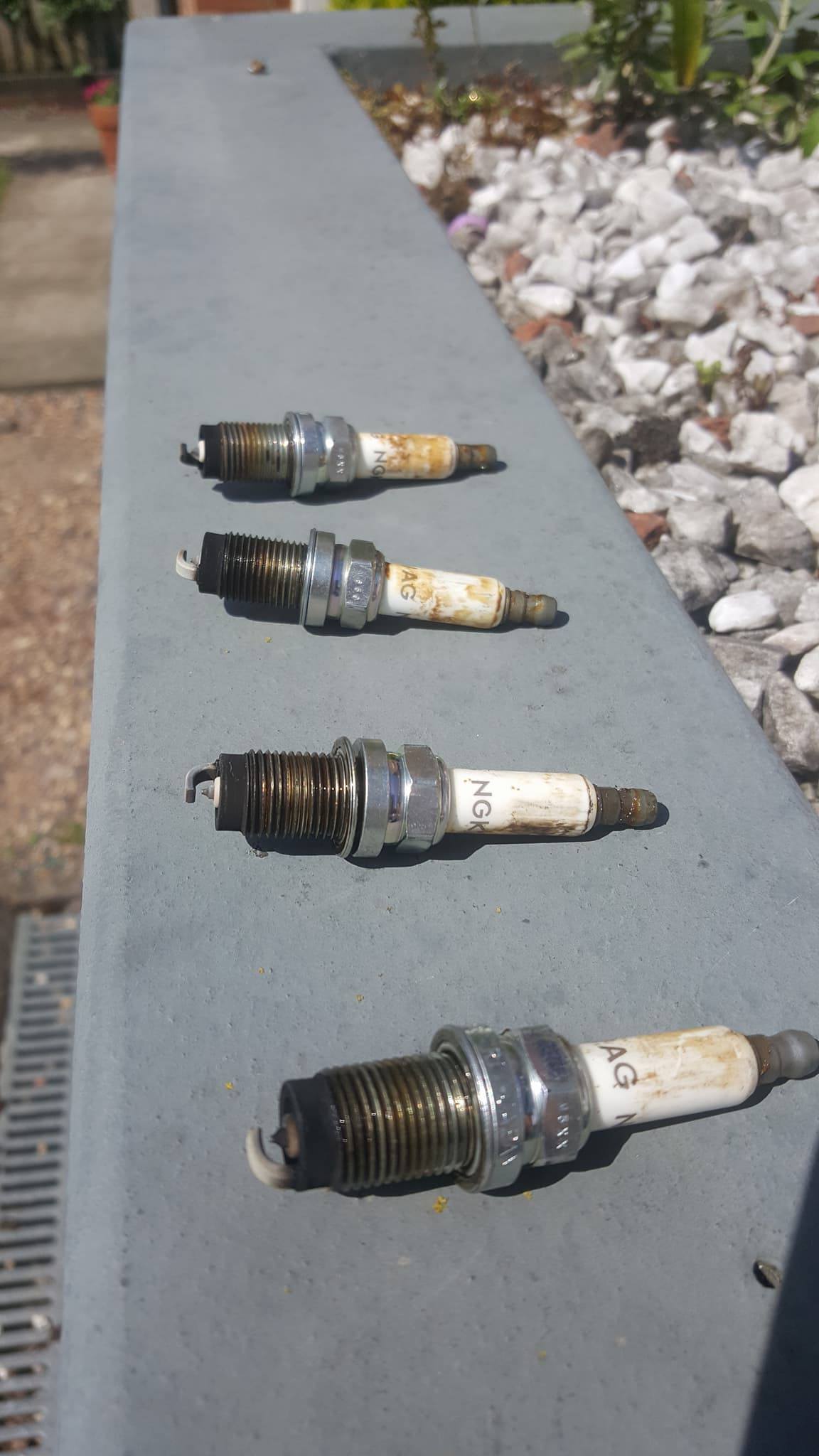

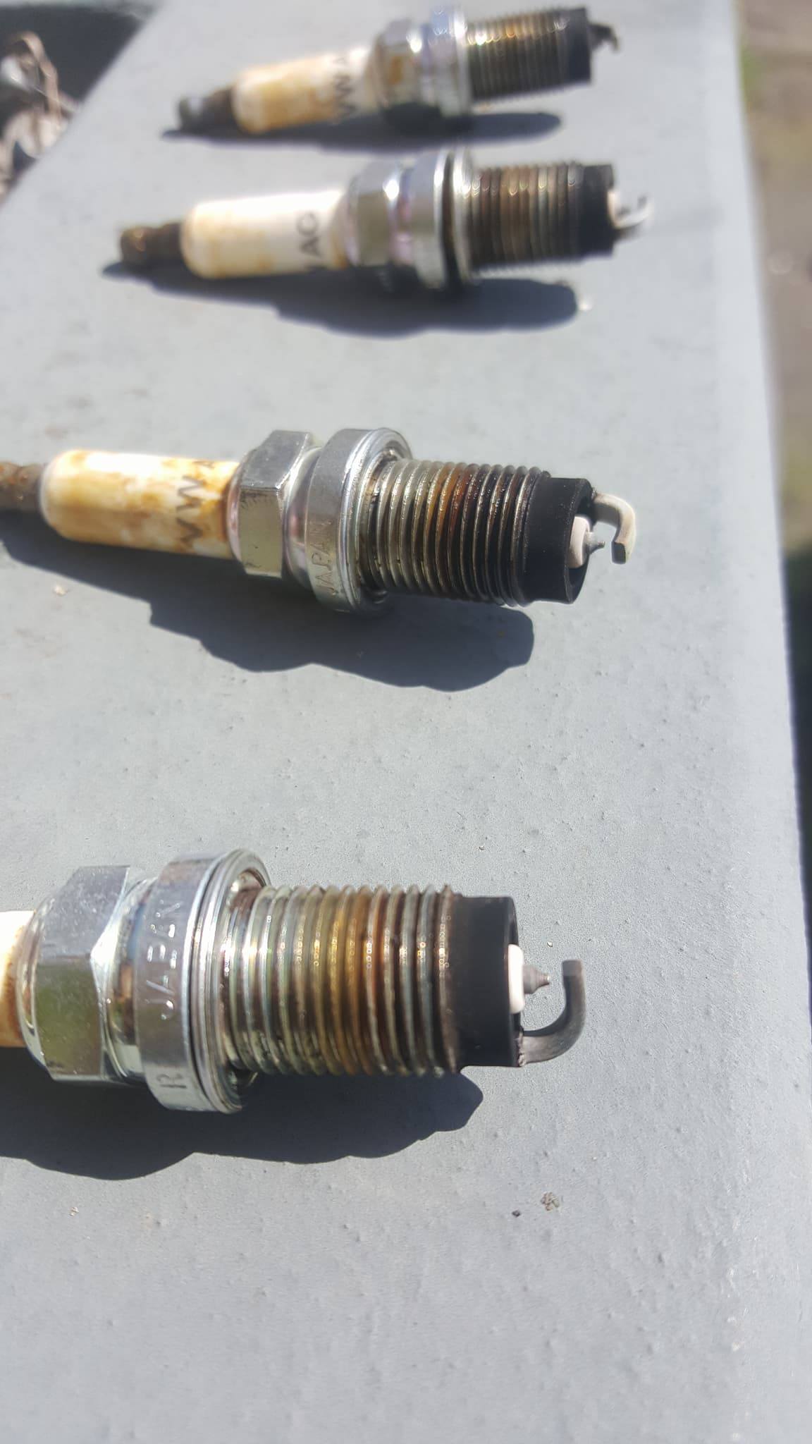

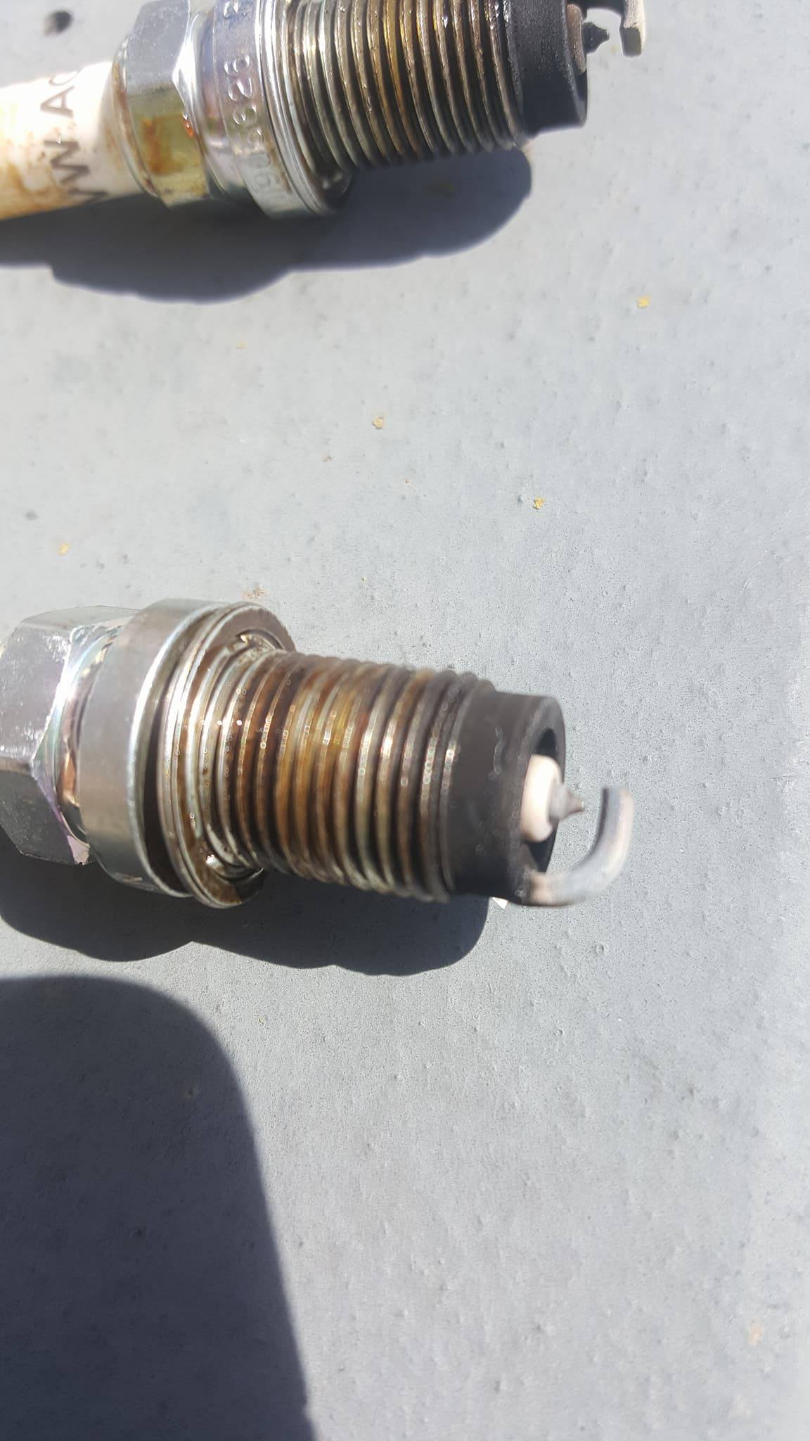

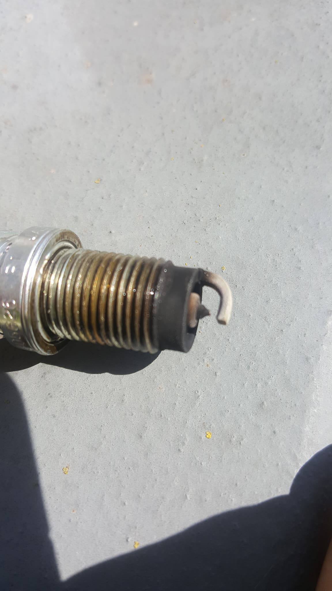

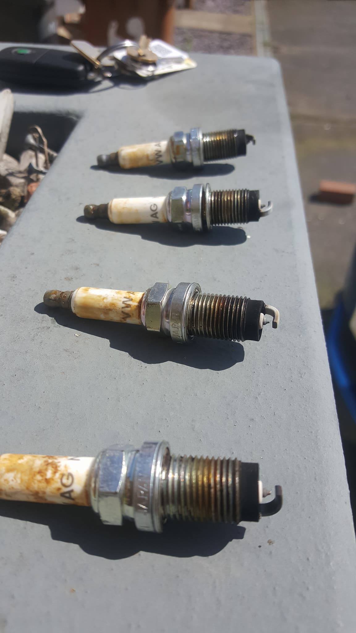

right.. plugs done today. sooo easy the second time round! :) The OEM ones that skoda fitted on the service have been photo'd and measured.. all came out to a loose 0.84mm and were covered in yellow gunk?? pics to follow. @Awayoffski what u think?
To me they look like you had them nice and hot before they were removed, maybe running lean.
Looks to me like they have been pretty sooted up and maybe rich before that.
Gap was wrong i imagine.
Are all 4 pretty much the same or is there an odd one out?
Someone with more knowledge will say what they think hopefully.
Edited by Awayoffski
They have been in since the service in January. The car hadn't been driven for 2 days before I took them out today.. and all 4 had same gap at around 0.84mm. :)
