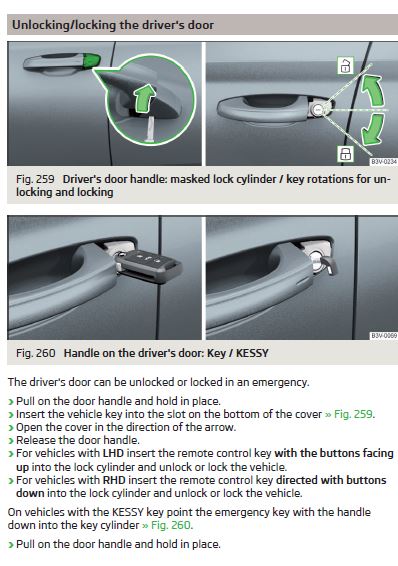

I have discovered a synchronising procedure of sorts on page 57 of the owner's manual. It involves unlocking the driver's door with the key. This is not so easy with a Kessy model as the lock cylinder has to be exposed by removing it's plastic cover which is part of the door handle. If it is anything like my old Seat Toledo this is accomplished by inserting the key in the hole underneath this plastic cover. I never quite managed this as I was afraid of breaking the cover. Has anyone done this successfully and is there a particular technique to it?

Just use a blunt tool to remove the cover, maybe wooden or plastic, or covered with a cloth, you wont damage the paint then.
Thank you all for the info but the plot thickens . I managed to remove the plastic cover of the key cylinder barrel (quite easily actually) but found that neither key from the " faulty " fobs would open the door . The keys are a completely different pattern to the key in the fob that works. This key opens the door. Tried improvising by using this key to lock and unlock the door to synchronise the errant fobs without success. Have now emailed the dealer demanding my missing fobs. A question for any L&K owner...... do all the key fobs supplied to you have chrome embellishments or are the spares plain plastic?
Been scratching around the internet trying to find how to pair my key that has stopped operating the remote central locking. This procedure sorted the problem out straight away. Many thanks. 👍
