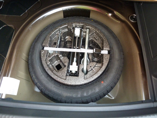

Secondly I've noticed one of the bungs in the boot is letting water in to the spare wheel well slightly. As it's just a trickle I can imagine it only occurs when I've opened the boot and the water is channelled down. I don't have a picture but it's on the left as you look at the picture below and on the back wall.
There is a loom coming from the one on the right hand side although this doesn't appear to be leaking.

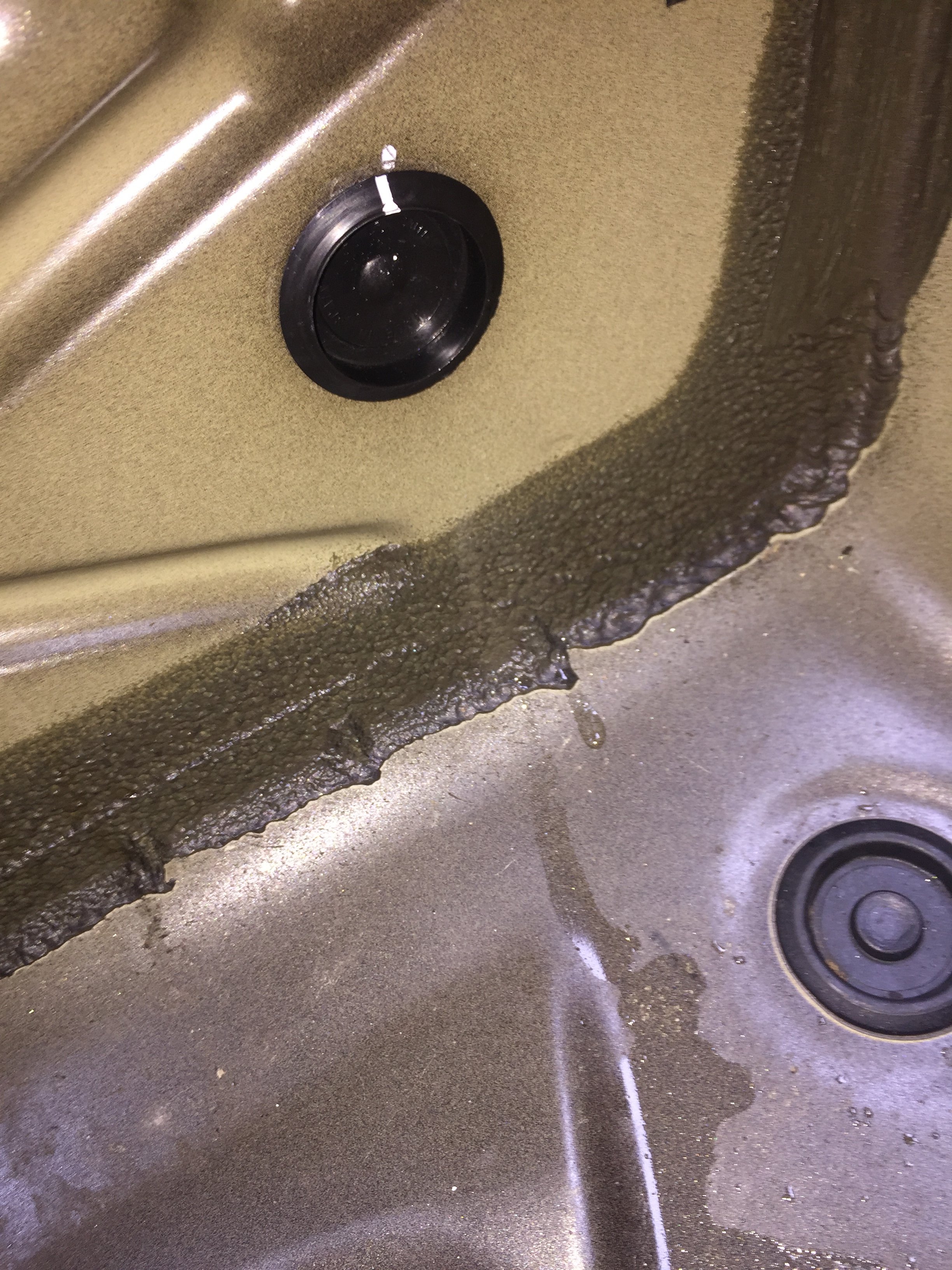

Here is the offending plastic grommet. Turns out it doesn't actually cover anything so will replace with a rubber one instead.
If you're referring to the one with paint markings on, it's for the towbar electrics.
Thats the one. I won't be fitting a towbar so that'll be getting a new rubber grommet and some sealant!
You could probably just apply sealant to that bung if it's lose. I'm surprised if was that is leaking as it is tucked up high behind the bumper. If you dry the area off and apply talcum powder above and below the bung you'll if water is coming from higher up and collecting around the bung as runs down into the boot.
BTW the outer flange on the tow bar bung is usually larger than the inner one to keep it water tight.
