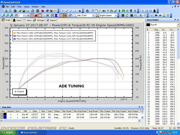

If you do a map then add an intake first, i gained another 8.4BHP (maybe 2BHP of that was  switching to Shell Nitro Fuel)  200BHP was a nice target to get to,
The tuner man at ADE rightly pointed out on the third Dyno (after another month passed and fitting an intake) it would have been better to put the intake on first , then map, not map then add intake.
So it should really be 205-210BHP if they were to tweak it but i decided to leave it at 201.8bhp
Anyway have fun modding
