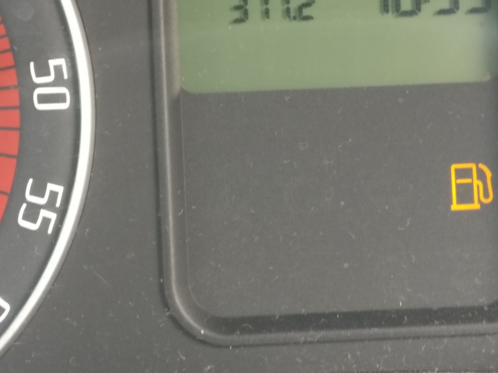

My car's oil light came on and started flashing and beeping on start up
It is a 2.0tdi vrs what could the problem be
I have left it on the drive and not driven it since
Not the fuel light but the light that is the same as the oil temp
Edited by mobo
assume you've checked your oil ....
have you had it scanned and codes?
what colour was the light ?
tbh the picture you have uploaded doesn't really help , could also do with a bit more info like ago of car although as I guess I'm thinking 00-09 mileage
haha sorry, I've not been with it recently I panicked a bit and went to work in my dad's car. when I got home from work on Thursday thought id double check before having it taken to the garage and realised it was the coolant light with it being slightly low
