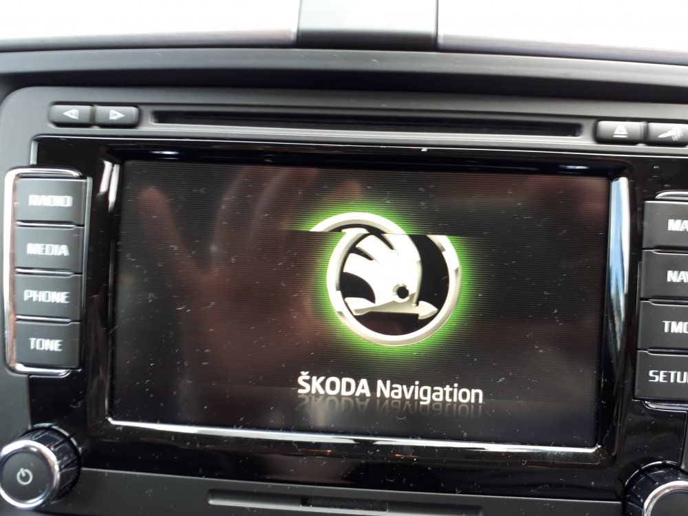

Screen appears faulty on start up, is this an issue to worry about or anything to sort it out??
Sometimes "system starting" comes up after a while also
I've had the odd one or two which have shown this fault occasionally. I seem to recall a software reload usually fixes it.

What do you know about the unit? What firmware has it got on it at the moment and map details?
Taken this off setup
DEL PART NO.: 3T0035686H
HW-VERSION: H21
SW-VERSION: 6270
ACTIVE MAP COVERAGE: WEST EUROPE
ACTIVE MAP SUPPLIER: NAVTEQ
MAP VERSION HDD: 8048
 hope this helps
Right, so it's an SSD version.

The software version. All SSD units are 6*** software based, HDD are all previous versions (0***,1***, 2***, 3***, 4***, and 5***).

 Hi
i do have the same issue, since i bought my superb, is there any chance you could send me message how to reboot columbus? Screen at start up is kinda cut in half. Tried youtube and rest of the stuff bug not much came up, just some replacement for money.

Hi, got the start up issue sorted, my dealer left the car in with Skoda who reloaded the system.
