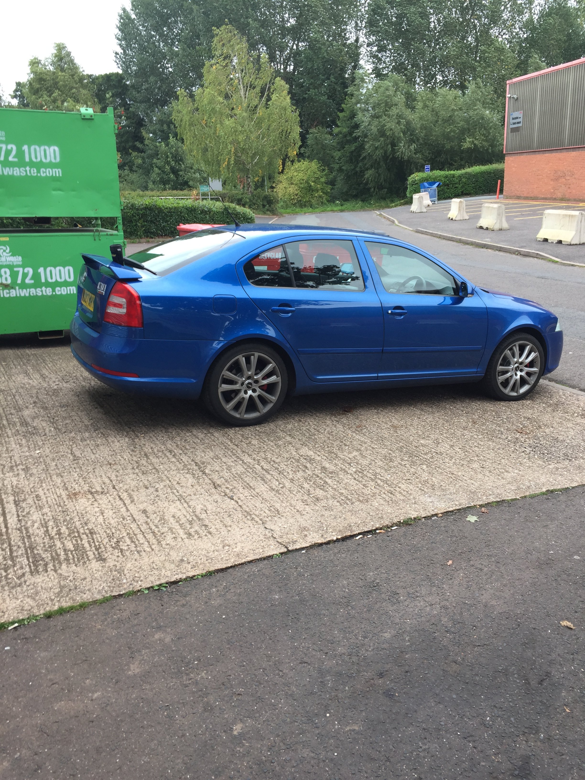

Hi guys I brought a skoda 7 days ago and loved it for them 7 days,
however saturday it took a while to start
so I brought a new battery, drive to work
and it just stopped again so my cars been at work two days.
my father in law took a look and noticed the fuel filter had been leaking and he said it could be the o ring inside.
today I changed the filter and ring and it just try's to turn over but will not.
i do not have any equipment to plug my car to check for faults and I can not drive it to garage.
has this happened to any one else ?
Its a skoda octavia vrs diesel 2.0
any information you you guys could give so I can try sort it would be fantastic
