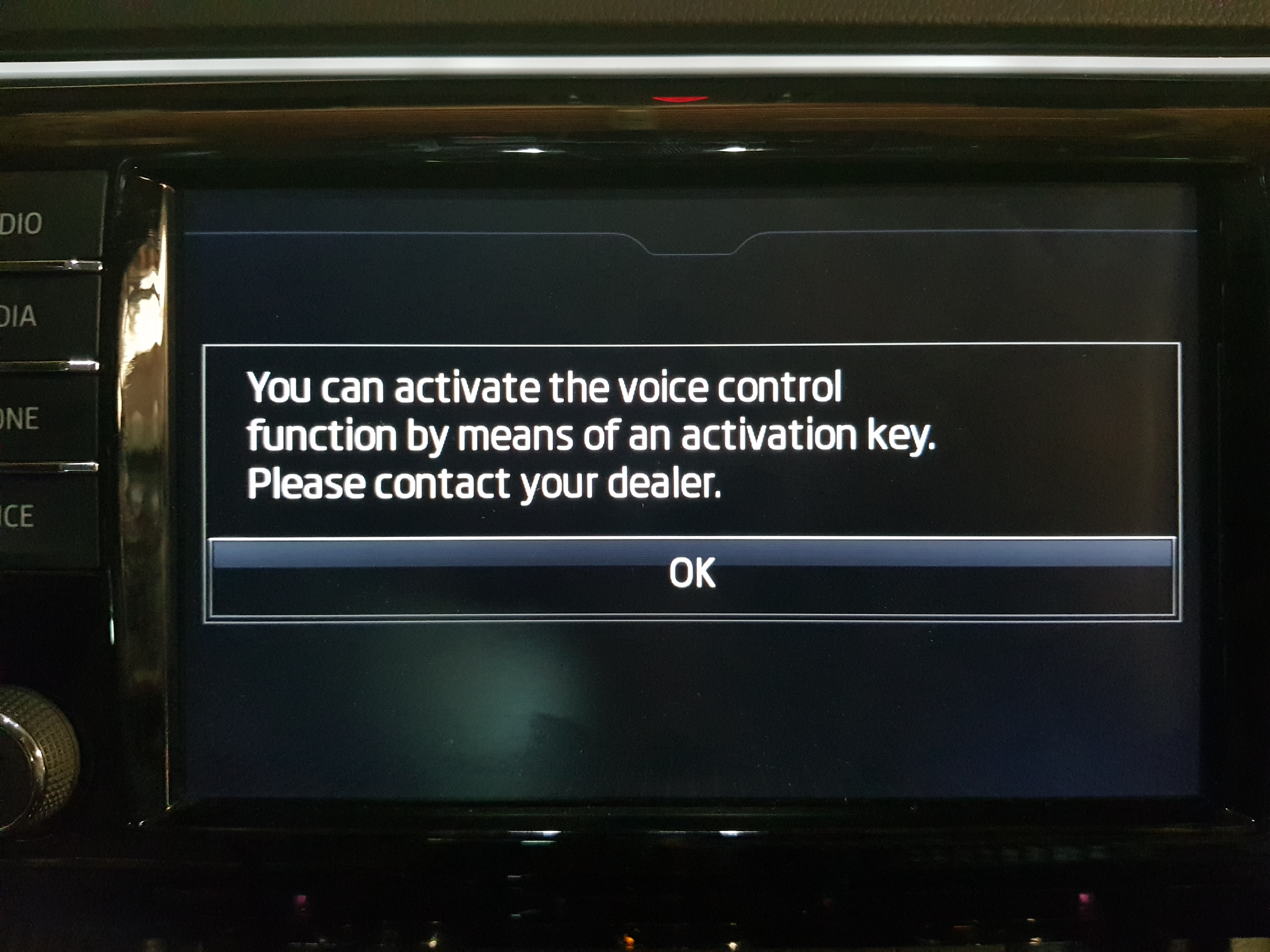

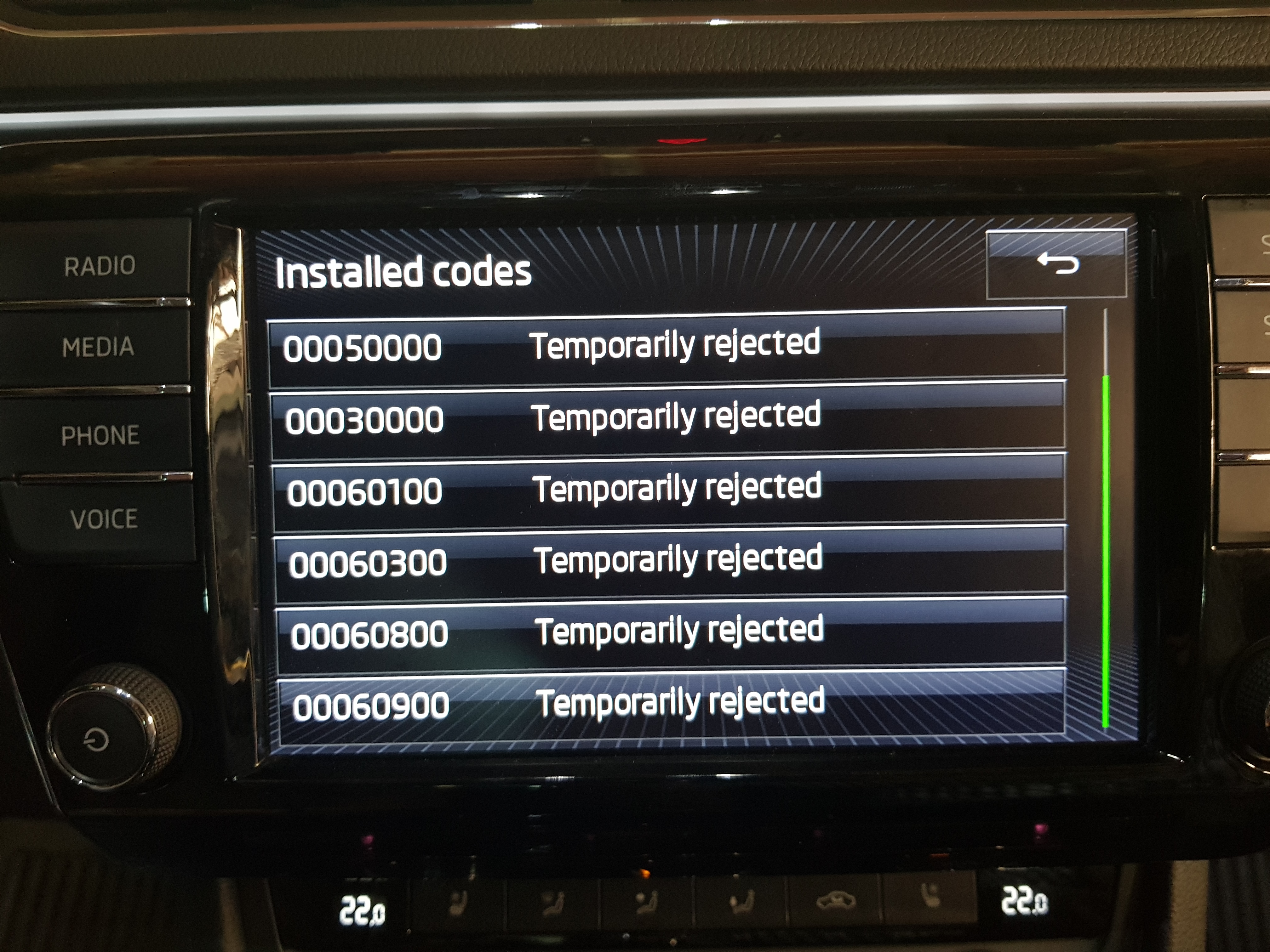

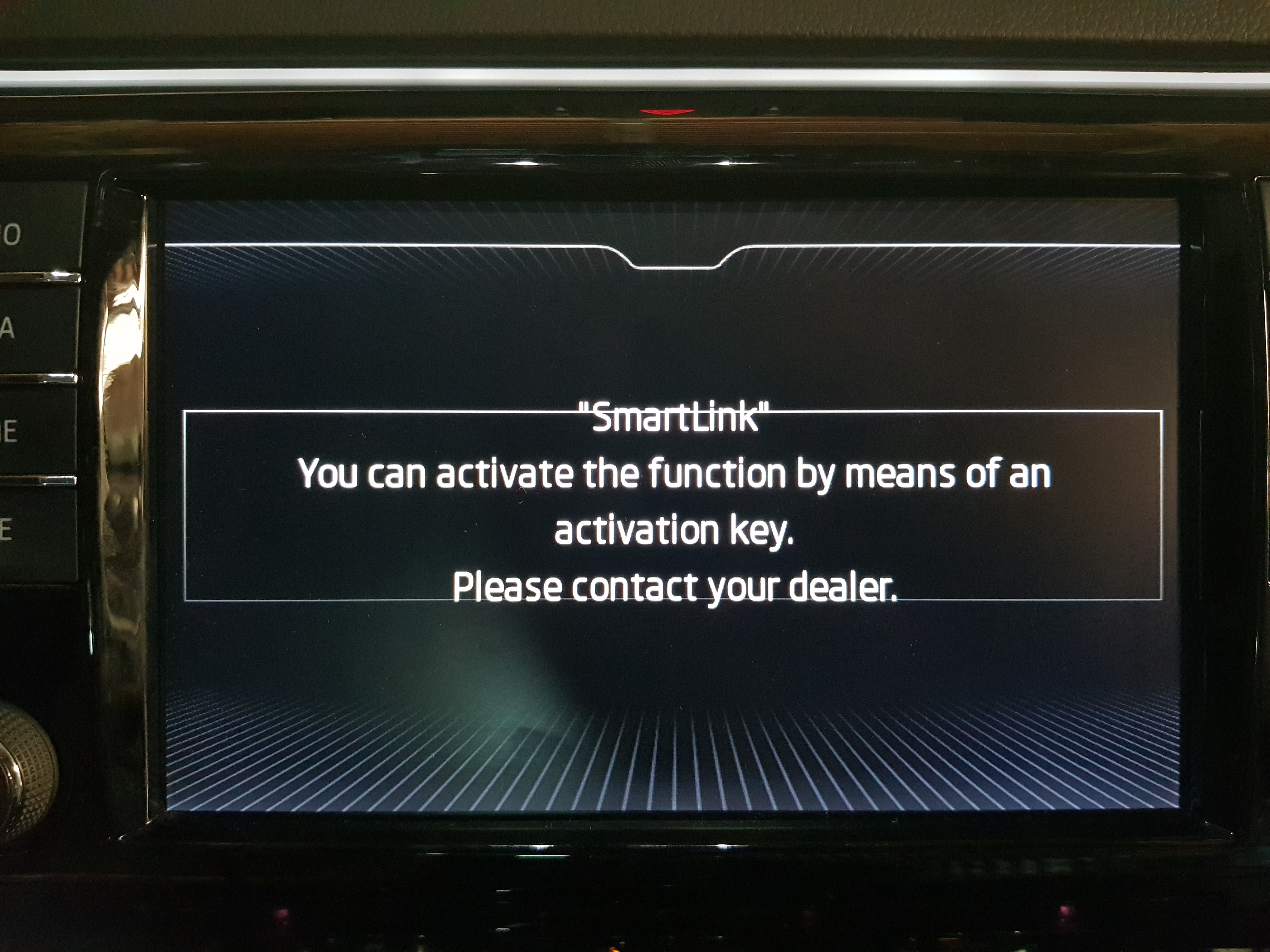

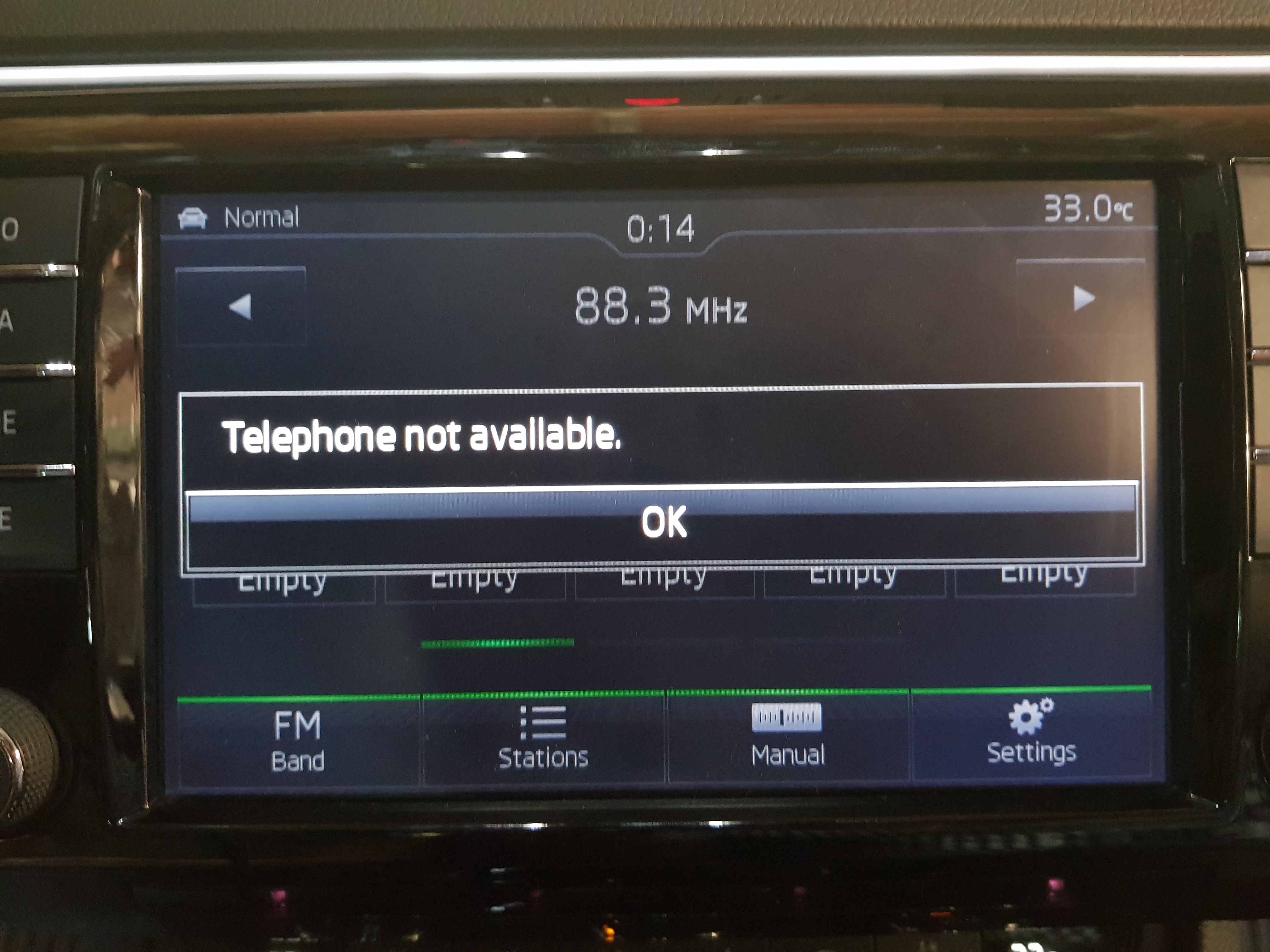

I removed my mib bolero from my superb s3 and when trying to put it back there was component protection.
I went to dealer shop and removed the protection .
I went home and had no bluetooth.. smartlink...voice control
Please help me what to do
6
go back to the dealer?
Have you used VCDS to recode the unit to tell it what the car has so it knows what to communicate with??
