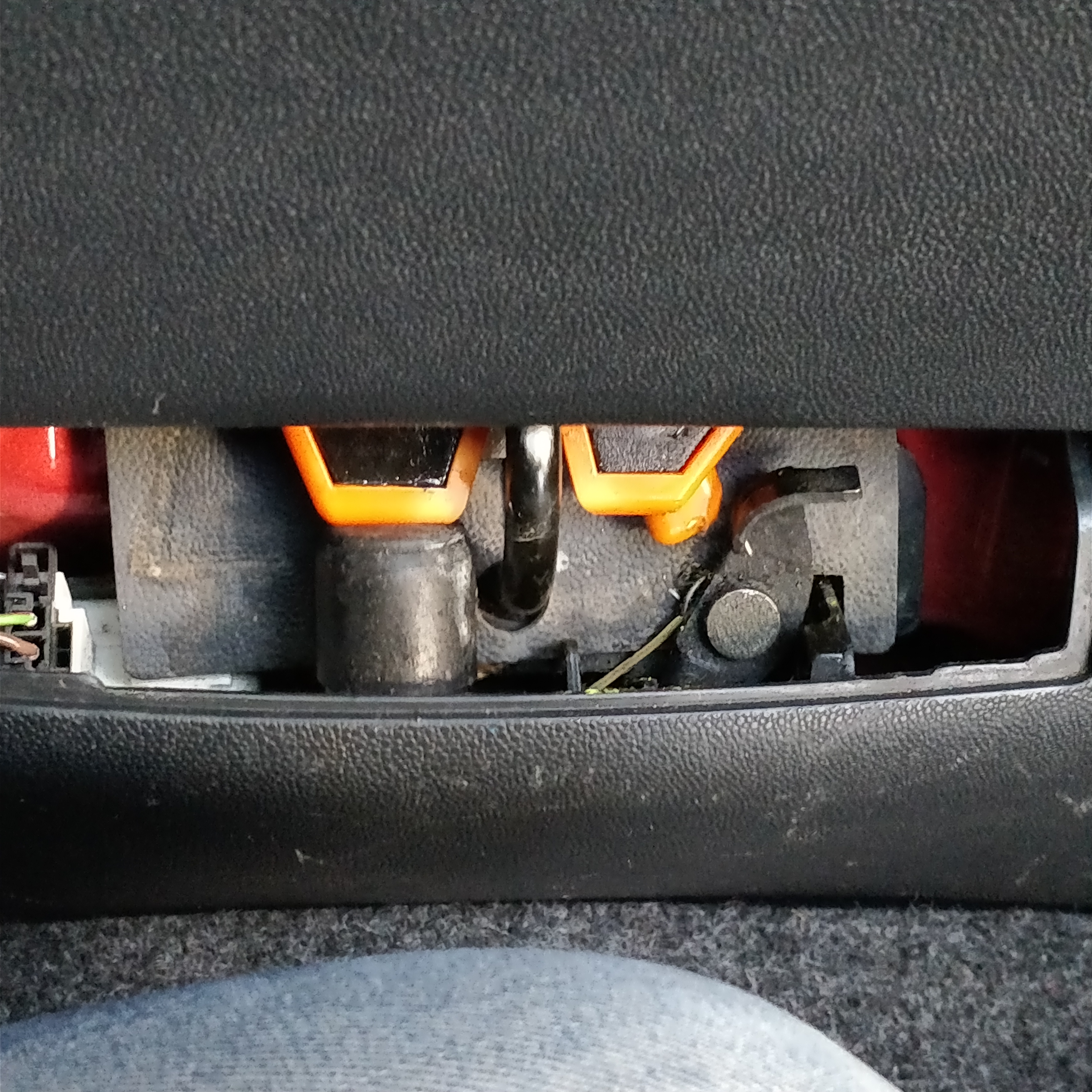

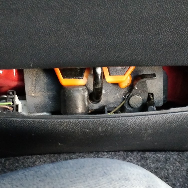

New to the forum .Need bit of advise on my skoda fabia 2005 model. The boot seems to be stuck. The switch works fine and locks opens a bit bit does not release the boot fully and it is stuck...
Attached couple of photos....what can be the issue ? Thanks in advance.
Welcome along :)
Wondering if the spring-loaded plunger has failed. That's what pops the boot lid open when you operate the release/switch.
Try opening the lid from inside the boot by operating the orange lever on the catch and then check the plunger.

Thanks for the reply....the plunger does move when i push the boot button....i will try the lever and revert back.
