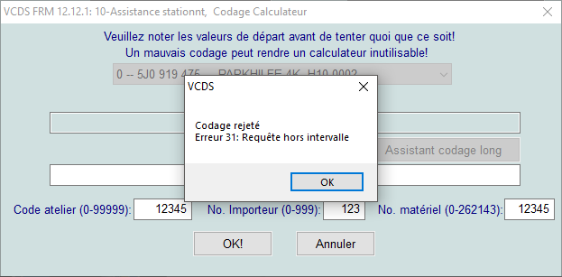

Hi,
Same issue. I try to apply the 12345 123 12345 solution but still the same problem.
Any idea?
