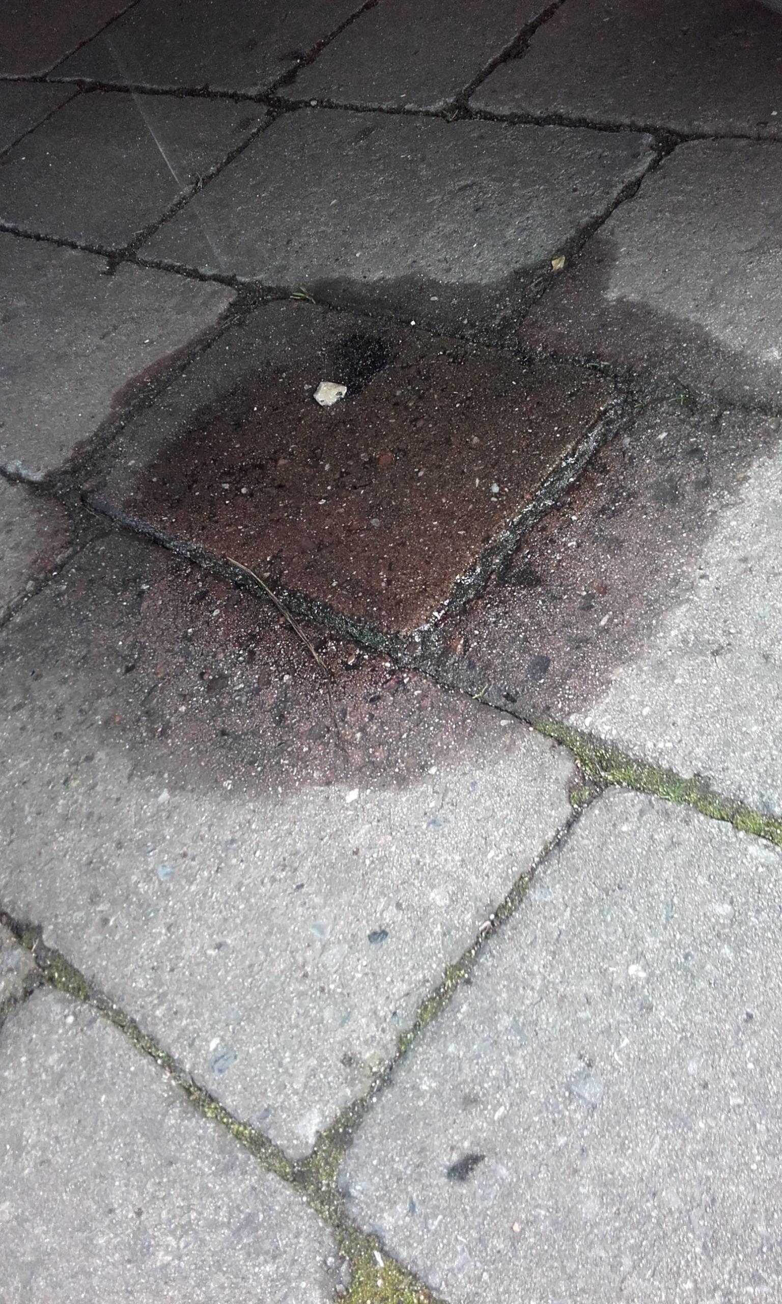

Last August I posted as follows - "Anybody had fuel expansion issues in this rare hot weather? My 280 estate was at roadside for an hour in full sunlight.An hour later neighbour tells me fuel running on to road behind o/s rear wheel. Tank was less than half full. I eased pressure at filler cap and fuel gushed out."
On 25 March exactly same issue arose, but this time weather cool and car straight and level on my drive. One third tank of petrol, neighbour calls and tells me car is leaking petrol. No Skoda breakdown available so AA attend  - decided against calling Fire Brigade as suggested!!. AA Guy says fuel line solenoid working OK. There is no vent to the tank as rules say no venting to atmosphere it seems. AA guy suspects fuel pump pressurising tank after engine stops. Car now with main dealer. Any clues??

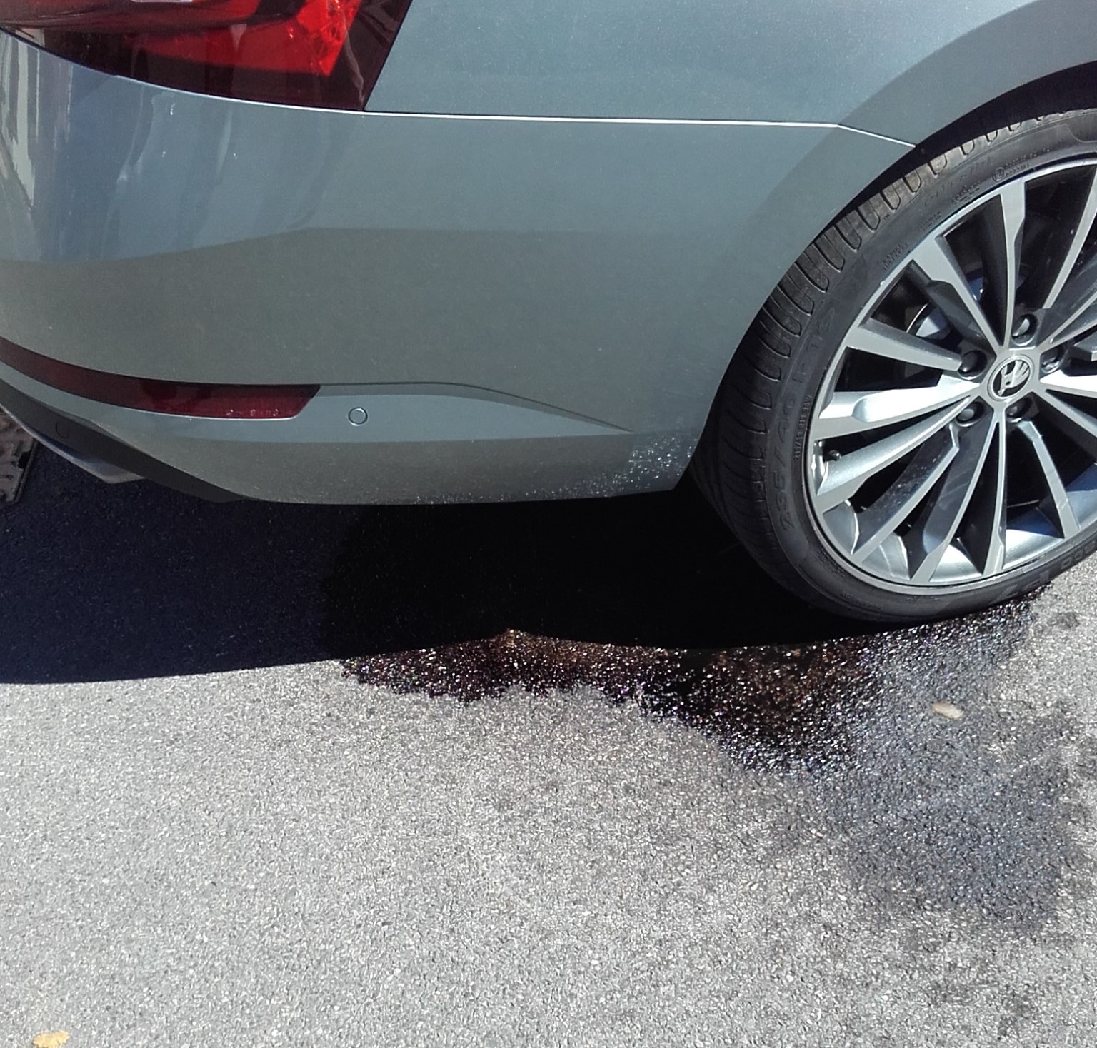

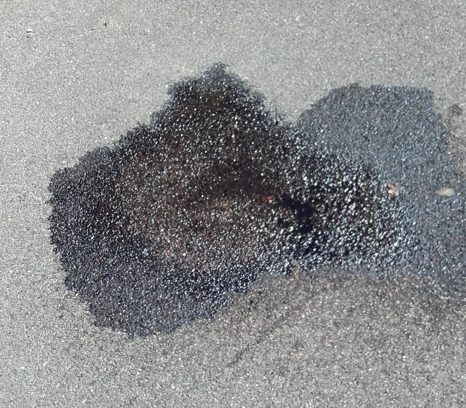

After 3 years of hassle free driving, my 280PS Superb has started to purge fuel onto the drive. Has the AKG fix held?
Noticed a fuel smell at the back of my Skoda III 280 a few weeks ago. Ignored it.
Today I check the back of the car and on the offside rear wheel is a pool of petrol. Opened the fuel cap and about 400ml of fuel runs out of the fuel inlet, into the fuel cap area and onto the wheel and driveway.
