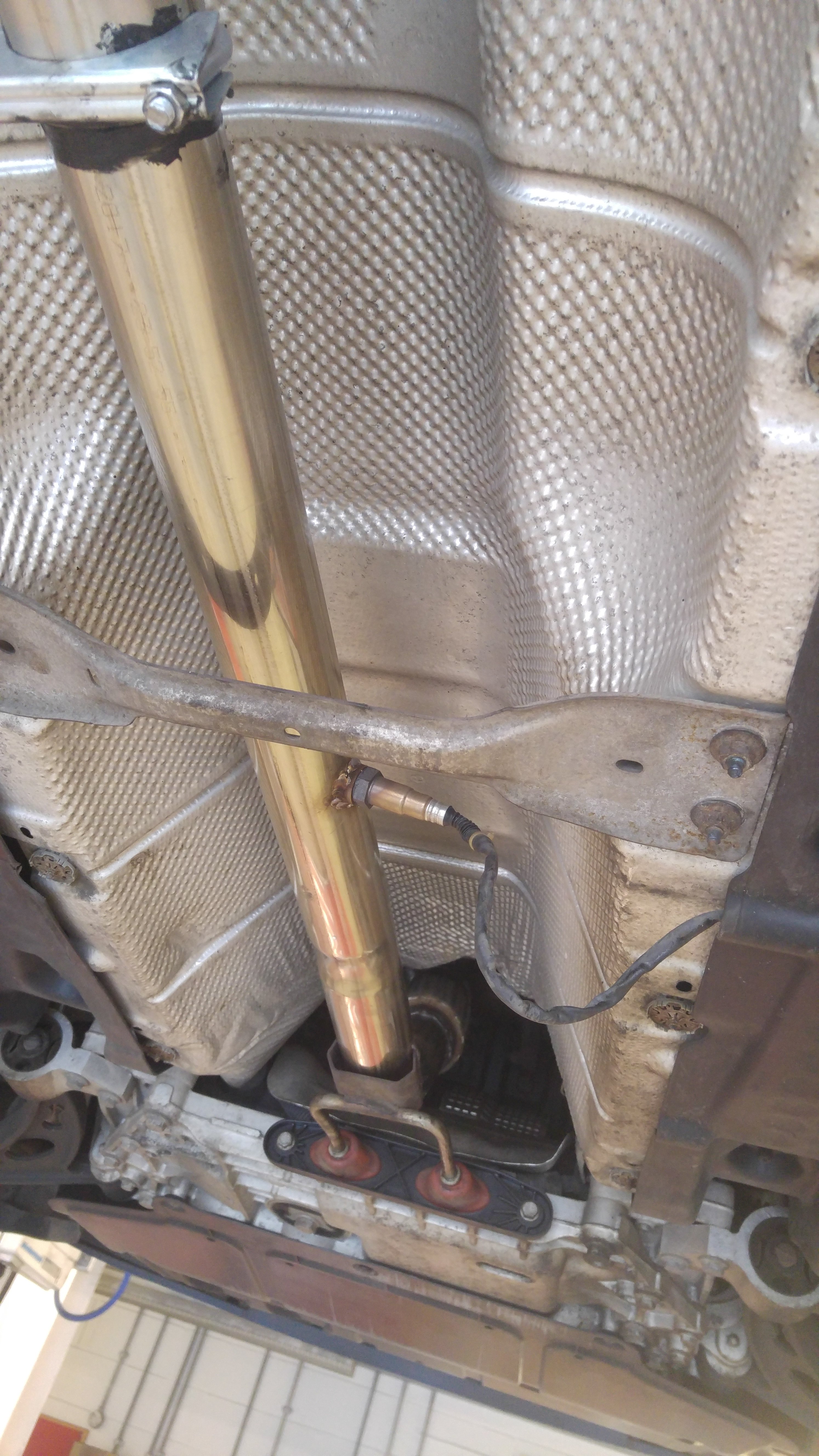

im stage 2 r tech mapped 265 bhp 325ftlbs with a 2.5 inch custom made exhaust decat to 1 back box at the back sounds nice on boost cost 450 quid aswell
That looks great altho a pain in the ass come MOT i bet having to change it? When u say sound great on boost.. is it loud? Can u hear ur car coming from miles away? Lol. I quite like all the pops and bang you hear from the likes of st focus, leon cupra etc. Does this make any?

unless your friendly with an mot guyB)
