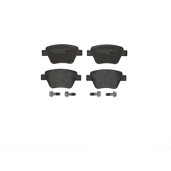

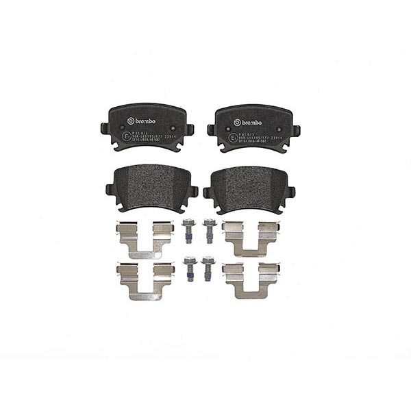

Correct ones as asvised...
Ones I ordered...
I will return the wrong ones to CP4L and pick the correct ones up from ECP, works out roughly the same with the discount code I can use,
