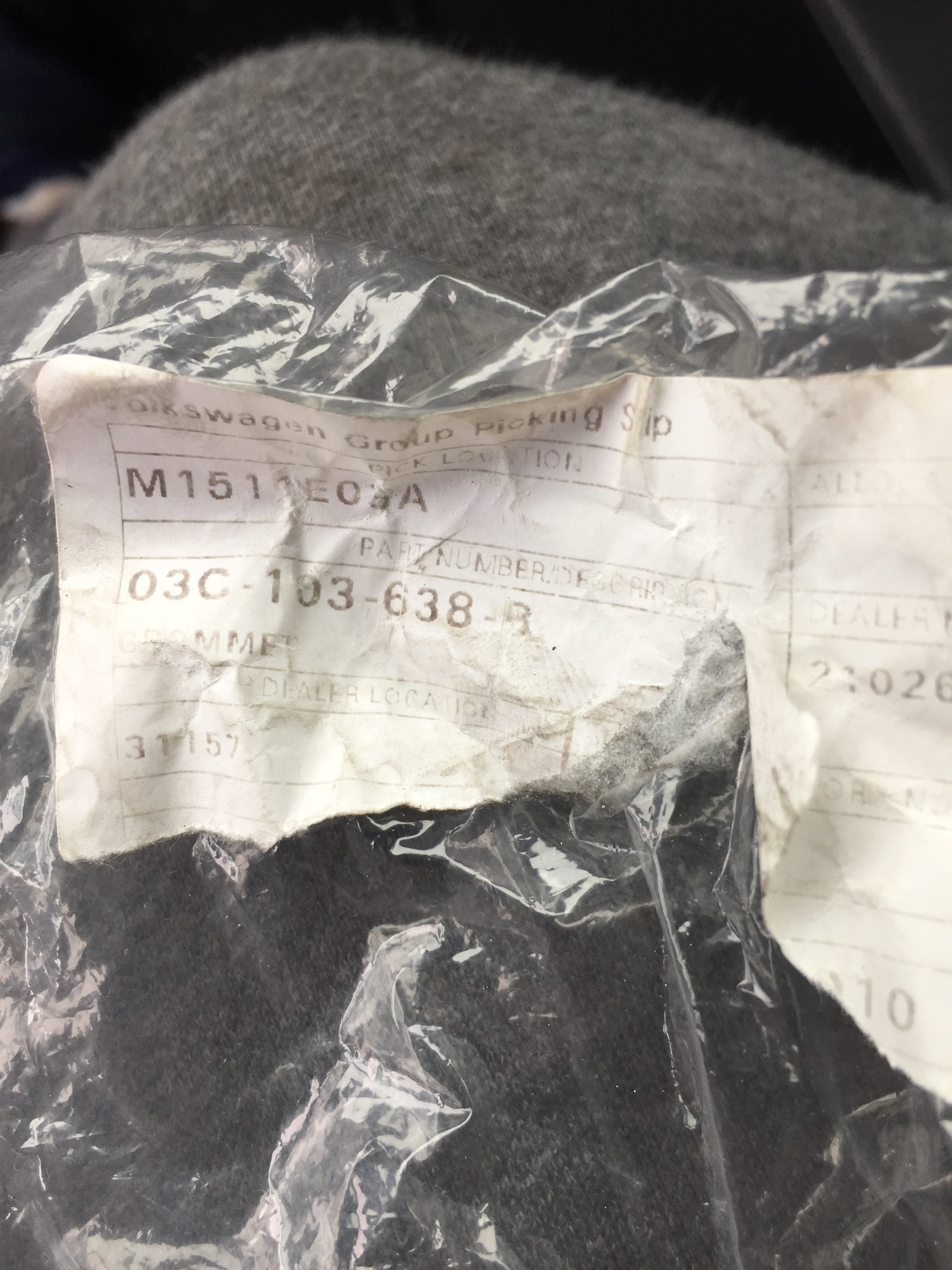

Part number is a bit faded on the packaging so I'll attach that too and see what you think. It looks like 03C 103 638 B
Looks like you've got the right part number although google doesn't seem to pull up much for that part number. Although it did bring up one of your old threads from when you were looking for it! I think you're on the money that rubber part is missing. It's currently plastic on plastic hence why it's not sealing.
