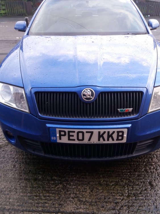

This is my effort. Not too bad imo out of a rattle can. New badge looks better too imho.
