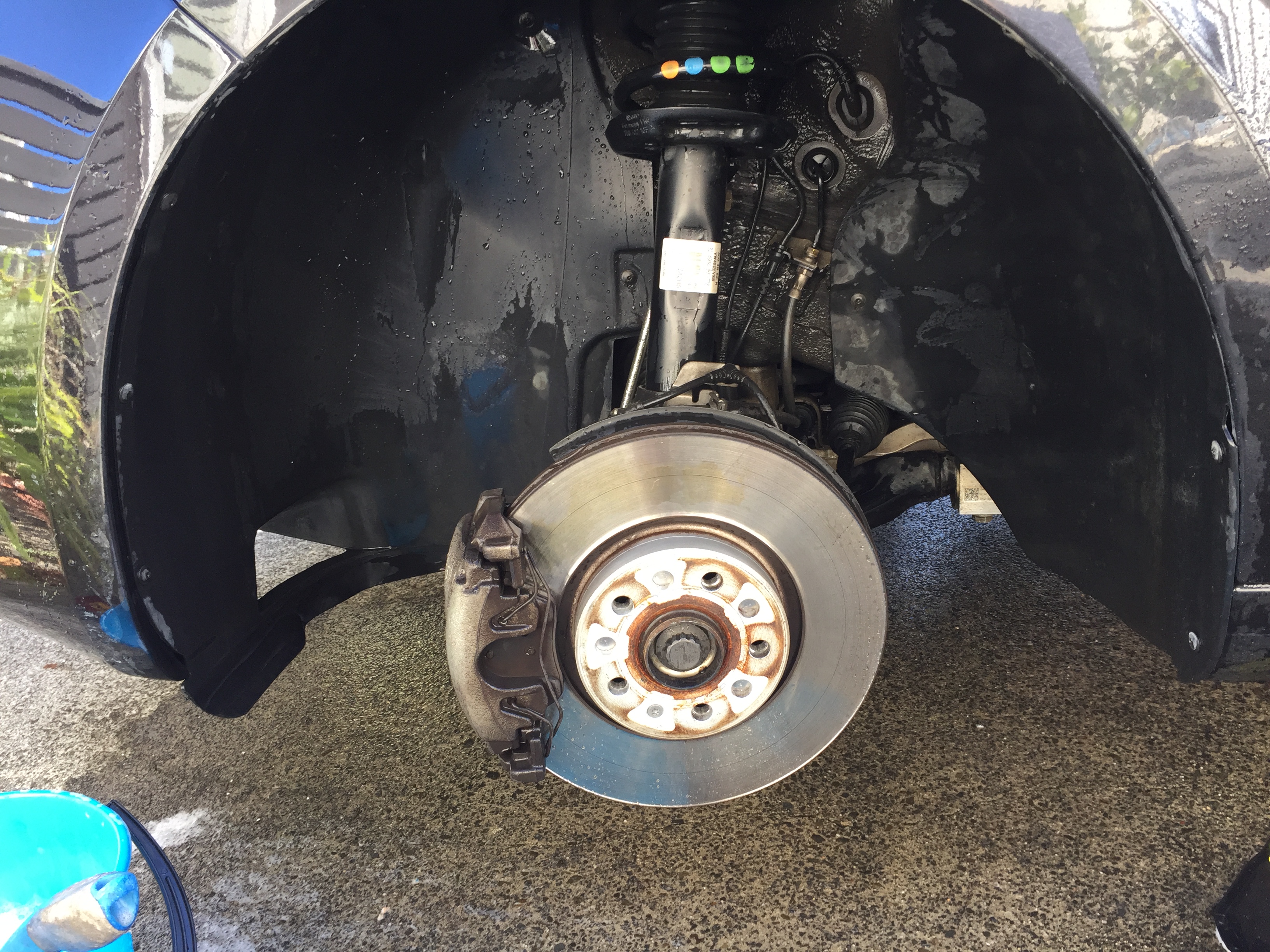

Interestingly I fitted my winter wheels yesterday and gave the suspension a good wash and grease, I noticed the 'Sach's' stickers on my shocks.

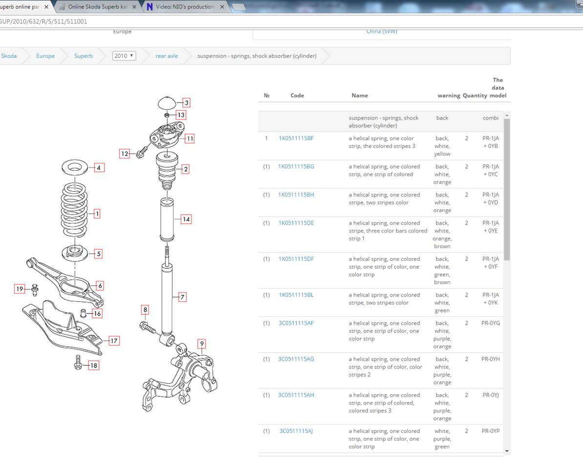

The springs have painted dots on them to identify spring rate. Each spring should have a matching shock absorber. Consult a VW parts specialist to make sure you get the right suspension bits.
Watching this with interest as I have a saggy rear end.
Here are the dots you will be looking for (note mine are the lowered factory sports suspension), and the paint codes below....

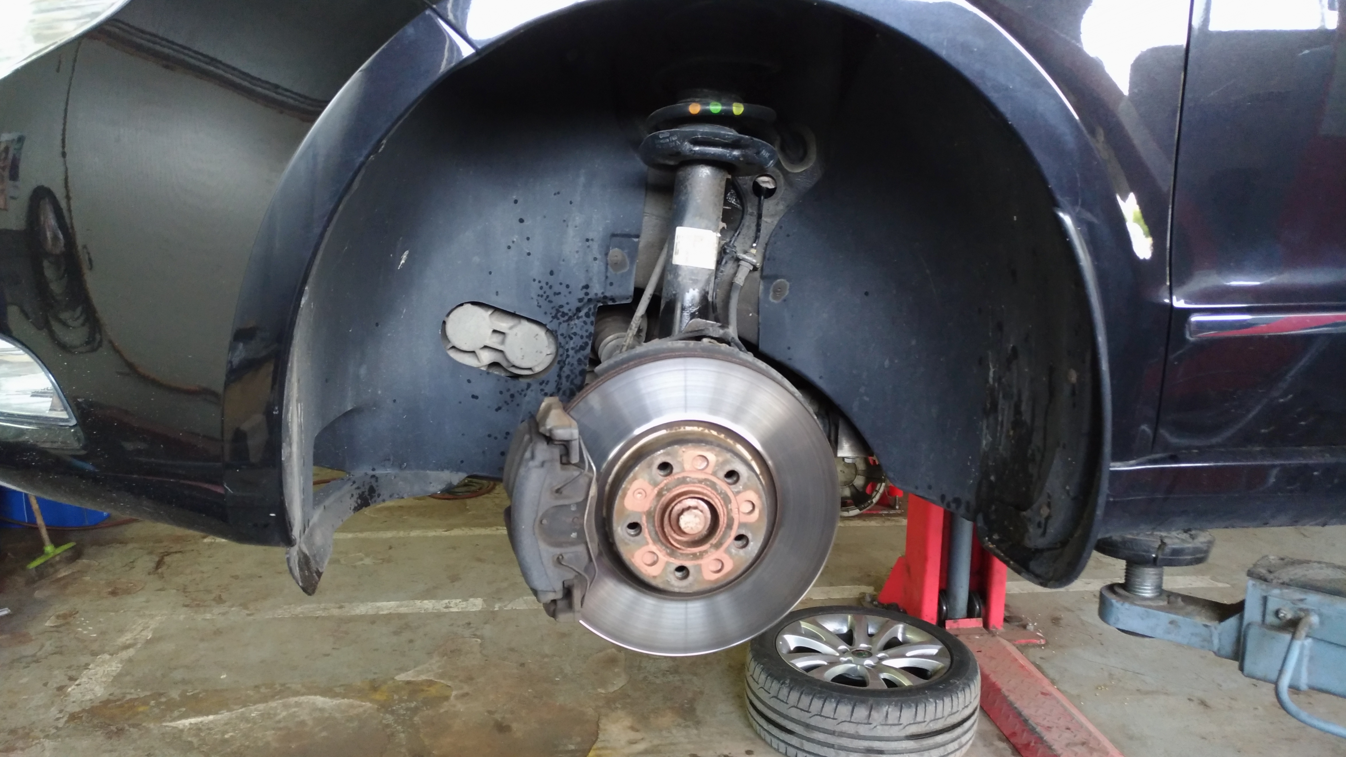

Photo removed at OP's request.
19 hours ago, safari hunter said:
I had Sachs as original option and for 200 km I replaced them after 160K km with KYB Excel - G for comfort ride.
Probably a stupid question, but why is that hub a 4bolt arrangement when these use 5bolt wheels?
Edited by john999boy
Sorry I uploaded a incorrect photo, from a Peugeot 207.
