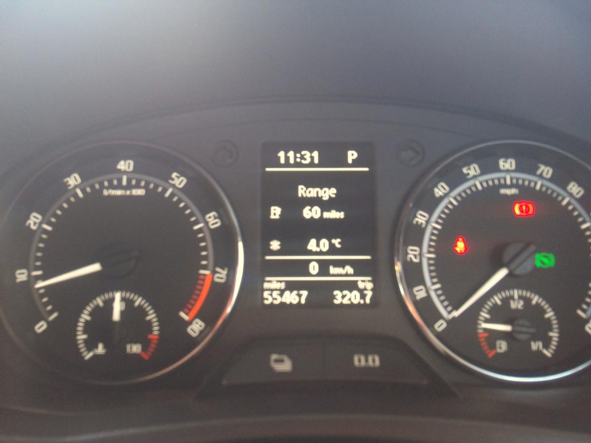

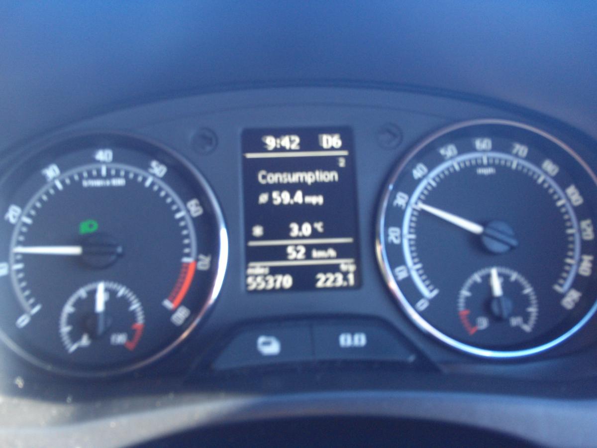

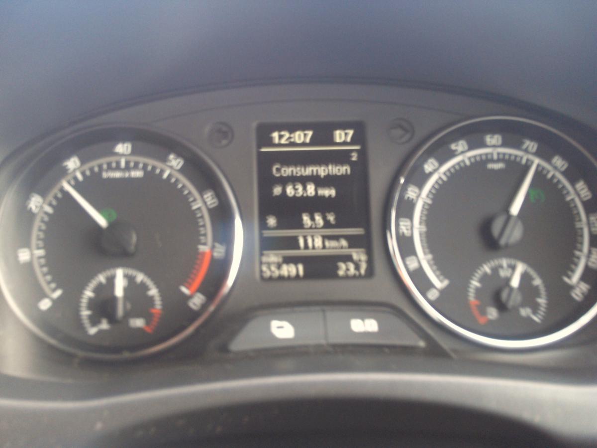

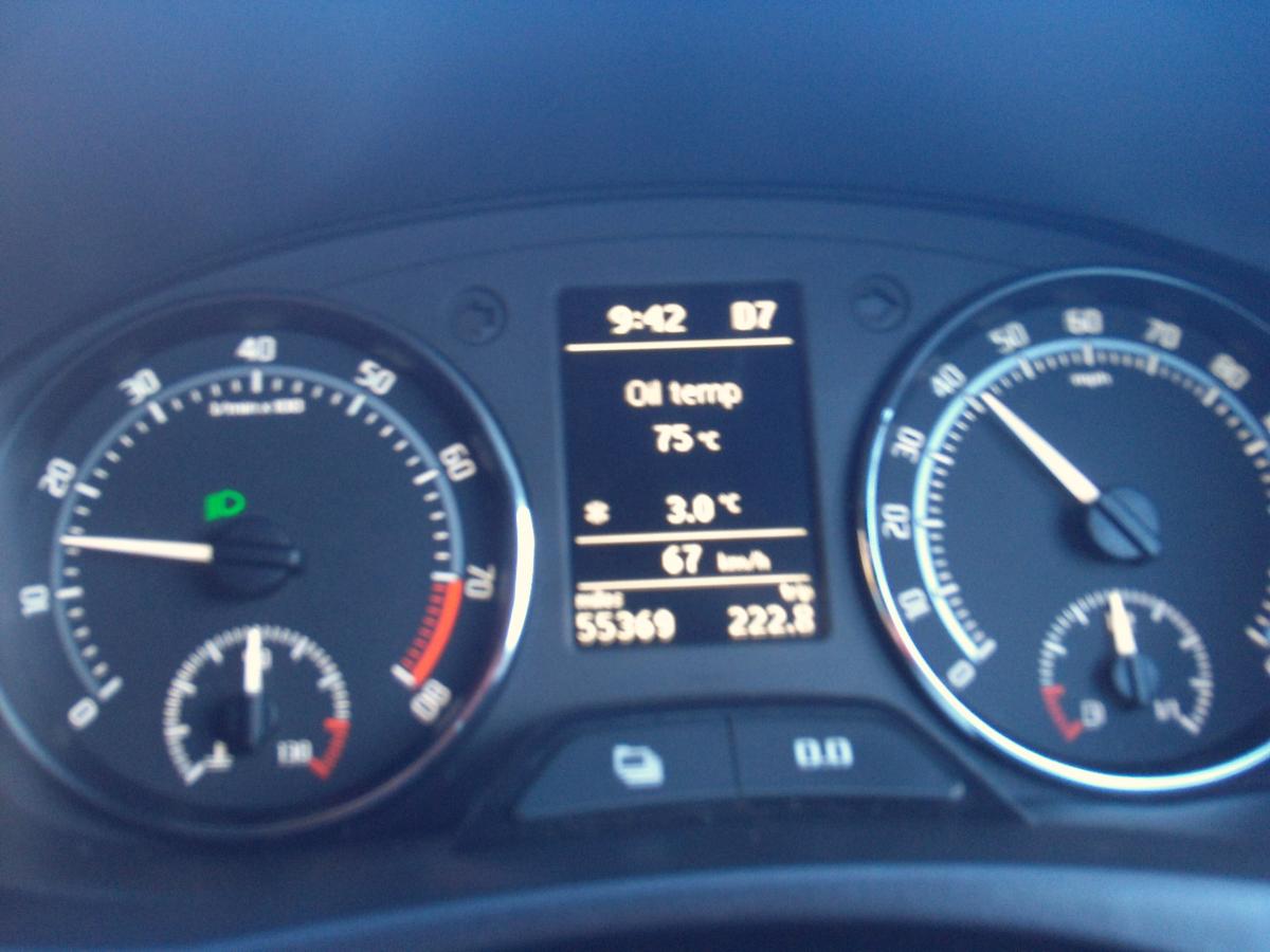

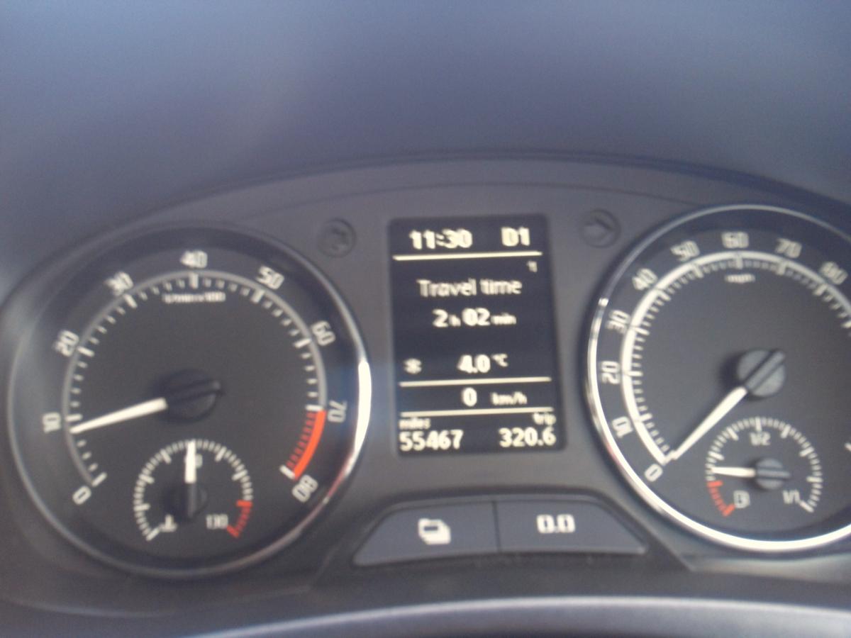

If you have a Twincharger engine see the difference of the MPG at about 6*oC or below on a route in calm weather,
and another time at temps of about 16*oC and up to 26*oC and compare if you do the same speeds, same weight carried etc.
http://briskoda.net/forums/topic/352088-vrs-miles-to-a-tank
^^^Found some of my old pictures in that thread.

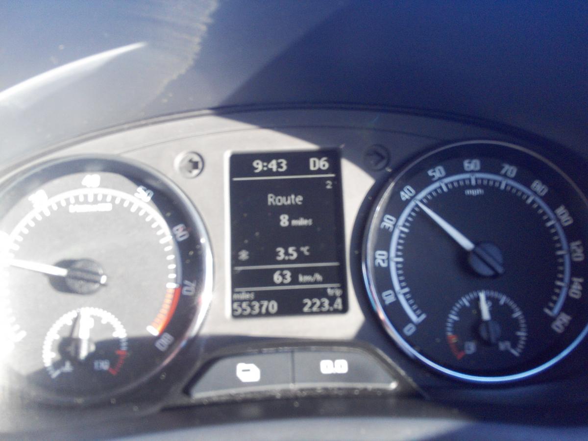

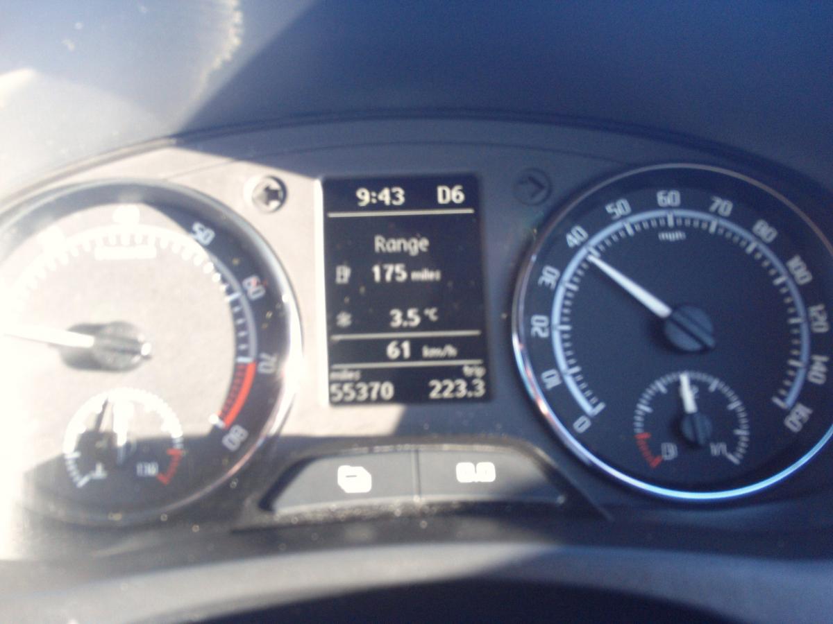

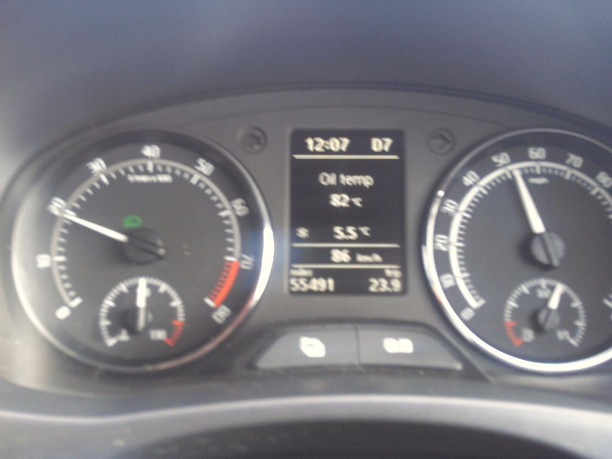

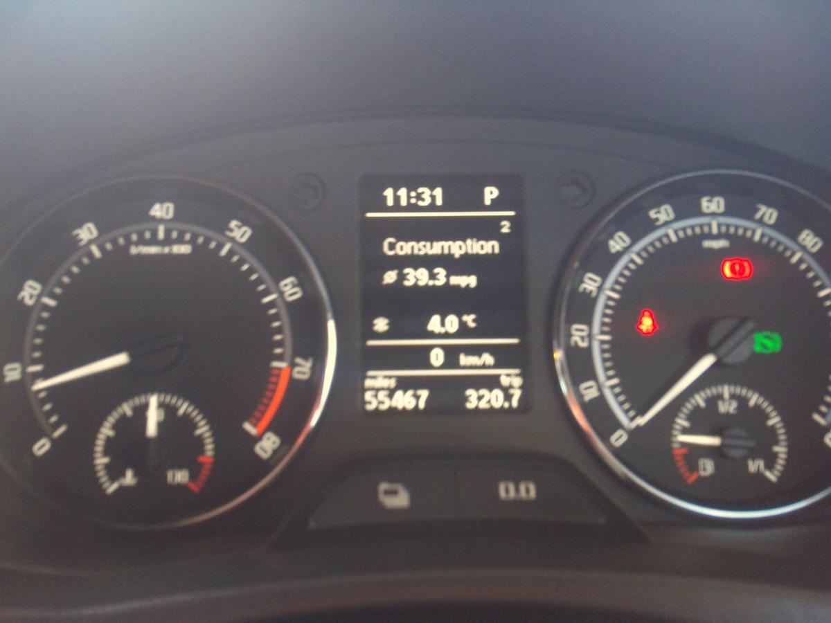

122 miles through Glasgow - Perth fuel in at Scone and home, Cold weather usual Twincharger MPG in the cold.
