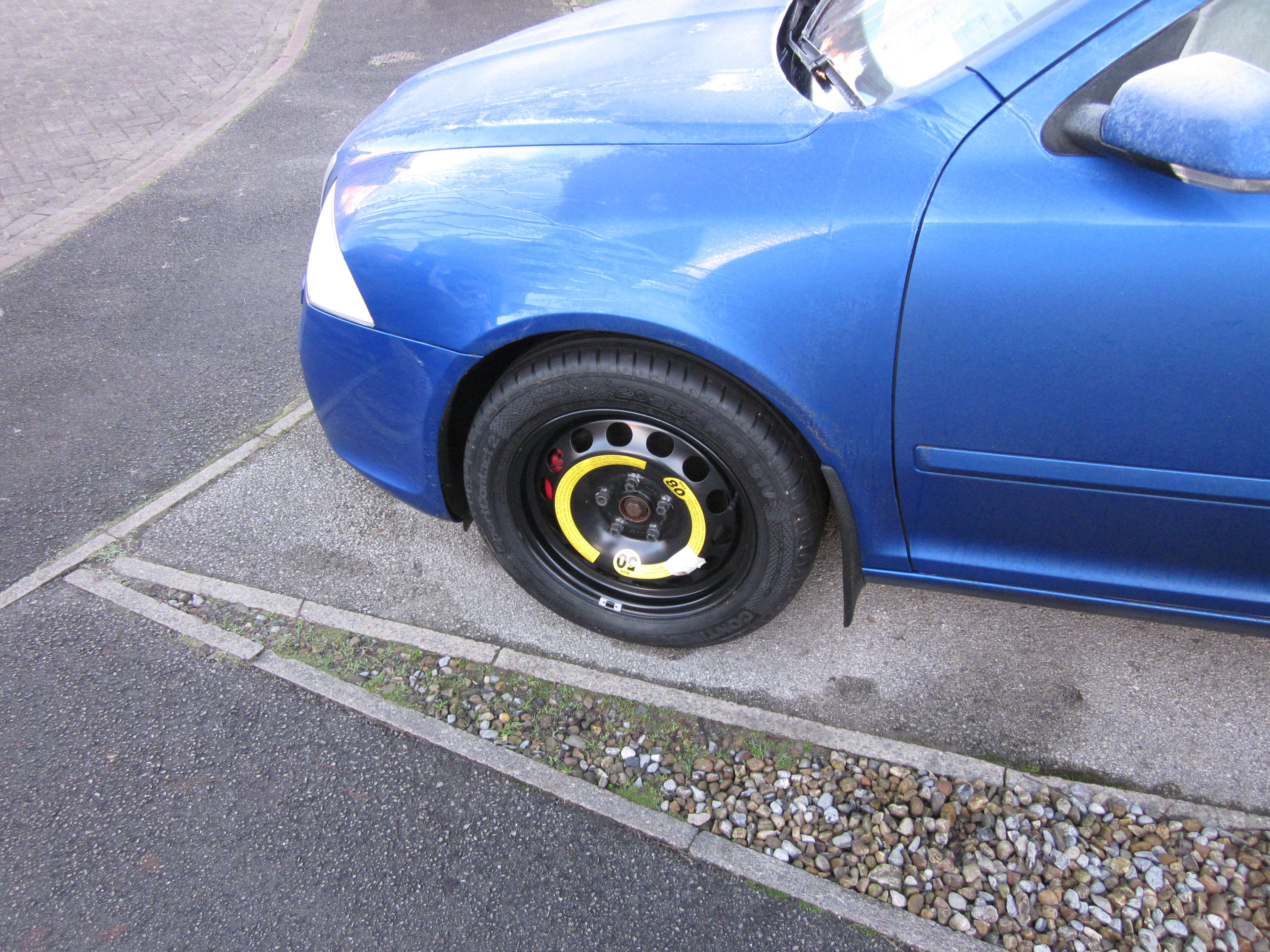

  • The "temporary" spare on a SE with 17" wheels is a 16" steel wheel with a 205 55 16 tyre fitted. That means it has a smaller circumference than the 215 55 17 tyres fitted on the car.   The b
  • The 205 55 16 in my boot was not cheap, its a Continental which are about the most expensive in this size.   The Octavia uses this size on SE spec cars so no need to put them in Superb boots

I've run a genuine 16" steel spare wheel for several weeks at motorway speeds without issue. The speed limit applied to the wheel is purely a precaution due to the different sized wheel (compensated by a higher profile tyre) and different tyre tread pattern. They can be picked up online with a tyre, jack and brace for a little under £150.
The steel wheel is exactly the same as you'd see on cars leaving the factory without alloy wheels so they are more than capable.

The "full size" spare in the superb iirc is 205 55 16 tyre. So not full size at all
I'm sure you are all aware that running two different size tyres / wheels on the same axle is illegal except when an odd size spare is used as an emergency get you home measure. Hence the speed restriction label on the spare wheel. If there was solid evidence you had an accident while exceeding this speed restriction it would almost cause you problems with insurance and plod, likewise if you didn't have the punctured original in the boot to show it was on for emergency use.

The space saver should be fitted to the REAR.
As to running a miss-matched on the same axle wheel / tyre,  ie different weight / width / tread / compound, maybe even tyre pressure at higher speeds.

One of the main reasons for putting the temporary spare on the rear is to avoid having 2 different diameter tyres on the front. This causes the diff to work extra hard and in some brand has been known to cause severe and expensive damage. You are probably OK if its local to use the spare on the front but if you are on a motorway etc get to a pace of safety and swap them round.
I have been considering swapping the Skoda supplied 205 55 16 for a 215 60 16 as fitted to the poverty models. Its virtually the same diameter and should fit in the wheel well fine.
