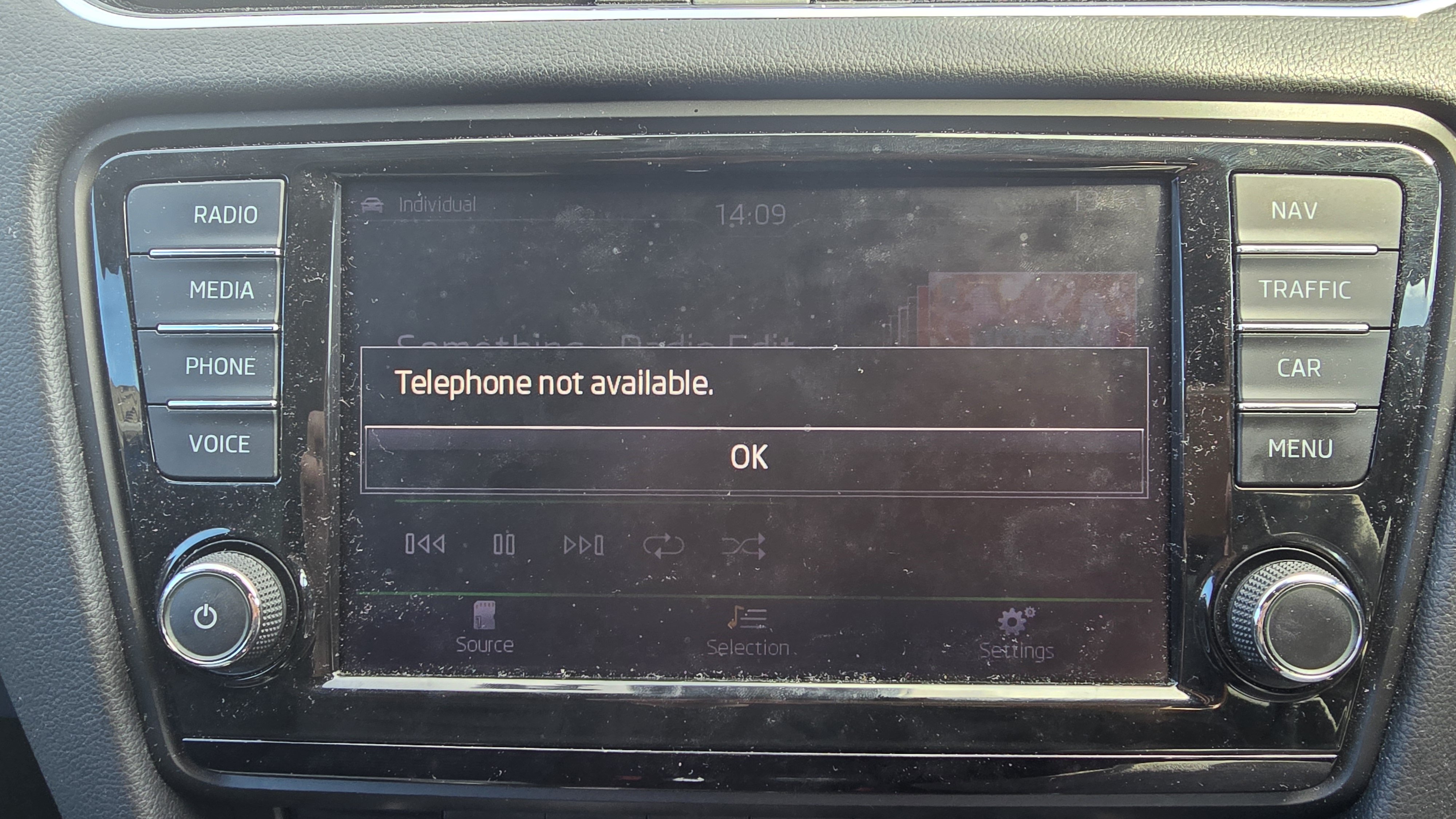

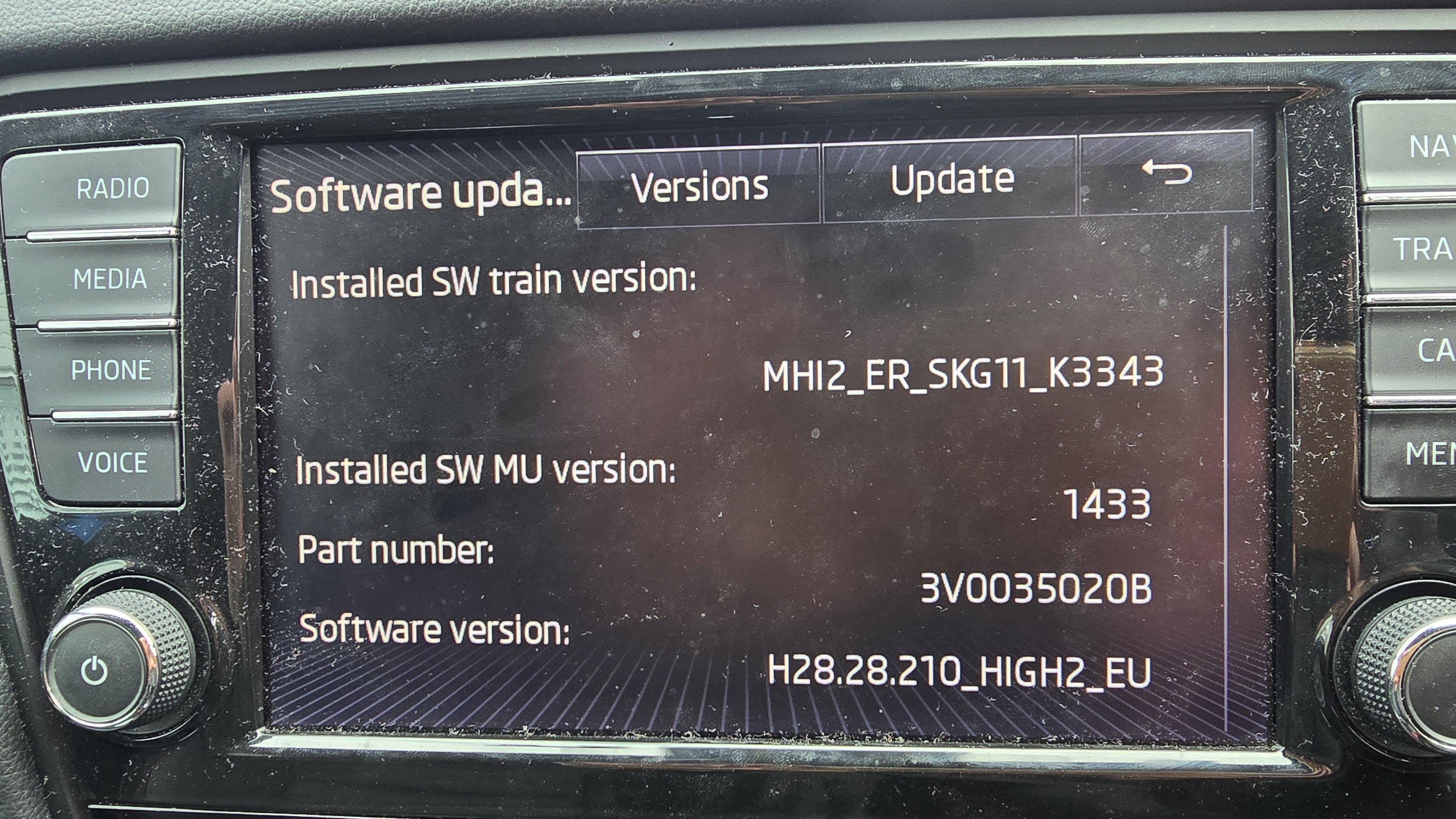

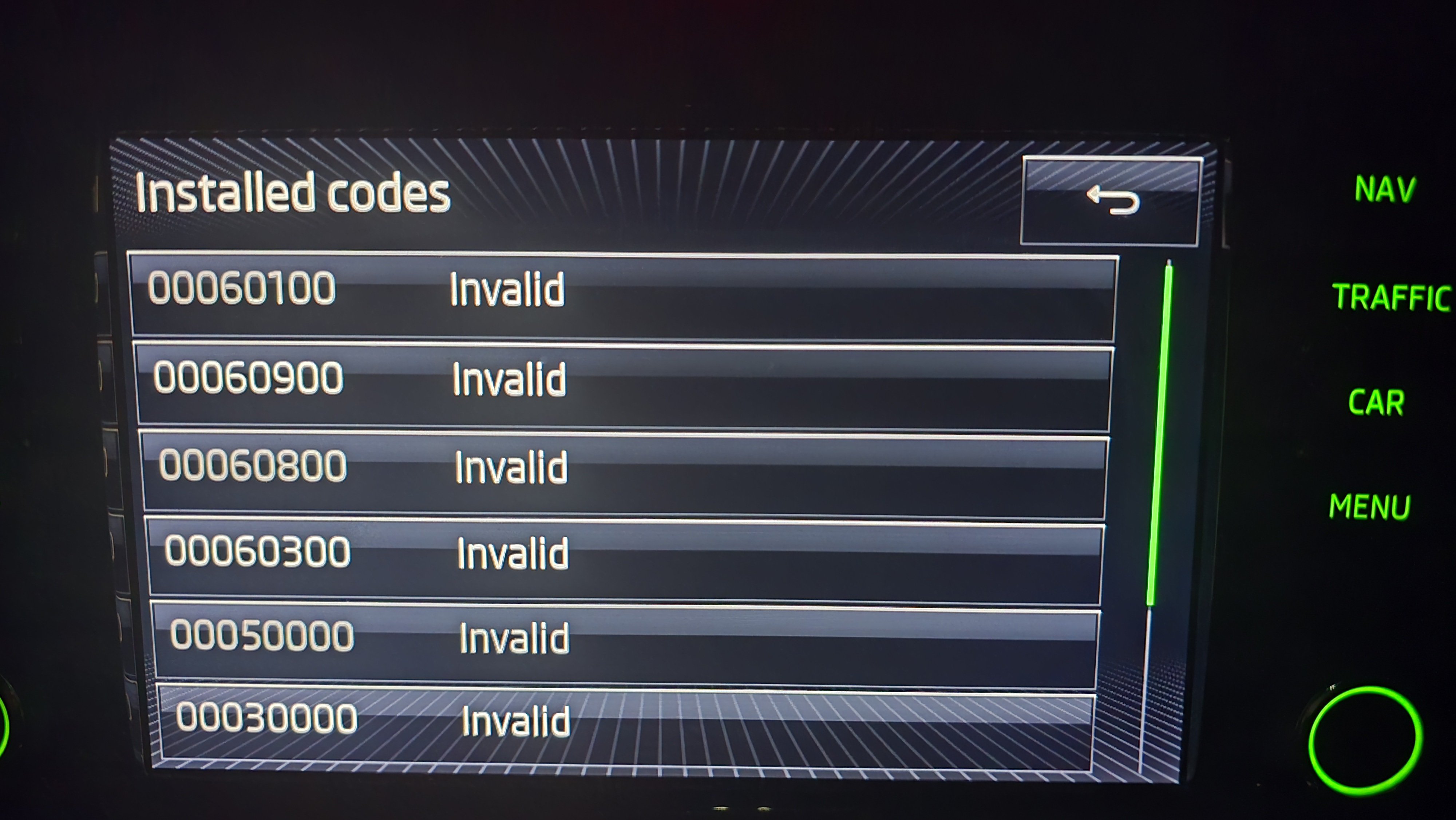

Columbus MIB2 CarPlay/Bluetooth/Satnav not working
- Columbus MIB2 CarPlay/Bluetooth/Satnav not working
Yep. MIB2 in a 2016 MY16 Octavia- Columbus MIB2 CarPlay/Bluetooth/Satnav not working
Right, apologies to hijack your thread, but I've been having the same fault as you (no Bluetooth, Nav, android auto), and I've tried software updates, but no to avail. It's been in the garage for some other age related bits, I got them to check the score with it, and they've just come back and said they're unable to communicate with the control unit. After getting my jaw off the floor having been quota £2500 minimum. I've checked on VCDS and 5F infotainment is unavailable. Similar to the OP, is there anything we're able to do?ChoonDoode started following Tuning and mapping , Advice on tyres , Can I tow a caravan? and 1 other- Advice on tyres
