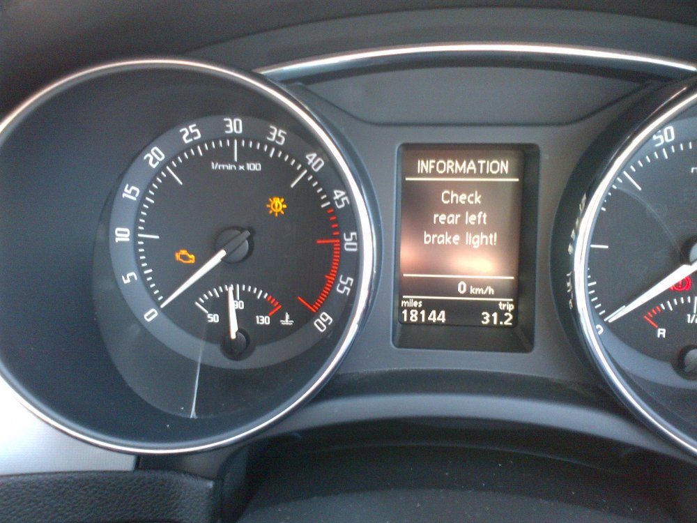

But the dash warning made specific reference to the "dipped" headlights?
My Superb tells me exactly which function requires attention...
