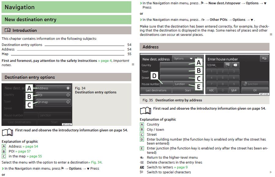

It's explained in the online manual for the Amundsen (page 54 on the version I have) - once you've entered the first waypoint and let it calculate a route you again press Route and you will see an option for "New dest./stopover".

Marvellous. I'm not sure I followed the above instructions exactly, not quite sure if my system is the same, but I got it to work. Basic gist, I saved the end destination plus the waypoints, although they are not termed that, in my Destination section. I called them route x, step 1, step 2, step 3. I then chose the end destination and selected one of the three route options given. Instead of just driving off I then select Destination again and choose the first saved point back from the end destination. It asks if you want to drive straight to there or Add it. Add it . Repeat the process but then choose the next point going backwards. Add again. When they are all added you set off, the route follows the stages you have set but in one flow.
