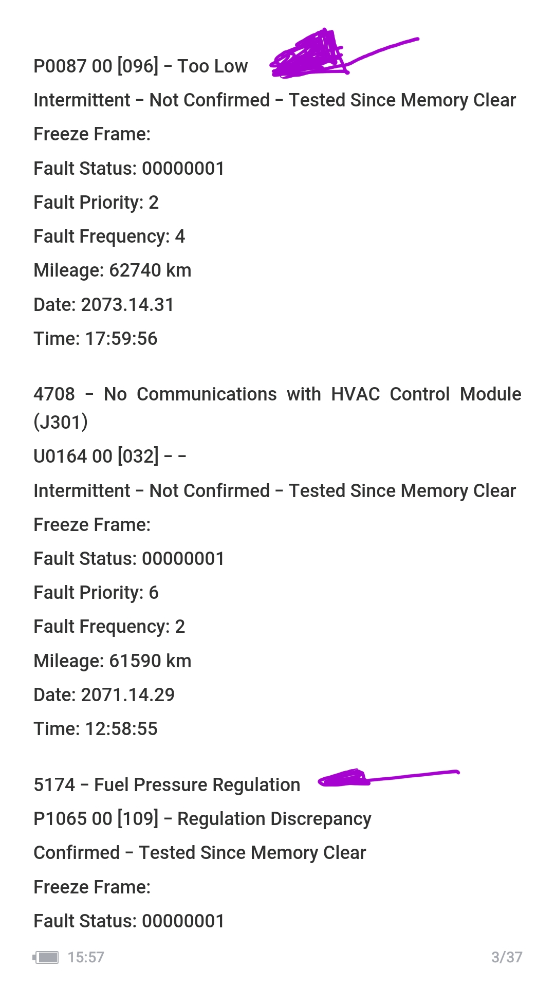

Actually through VCDS, we are getting only the P008x code related to low fuel pressure.

attached fault codes
If the filter has been changed it could be the fuel pump itself, a bent or restricted fuel line or a bad fuel pressure sensor (or wiring).
