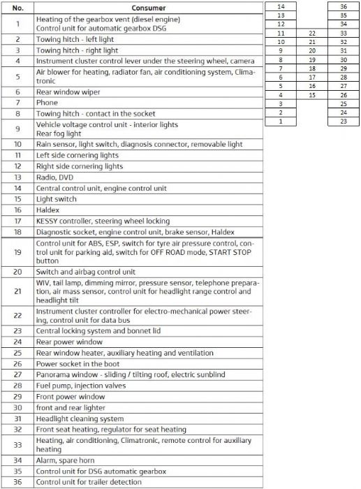

Hi need some advice on which ignition live fuses are safe to piggy back onto for installing an additional dash cam hardwire kit onto.
i already have one for my dash cam which is plugged into fuse 6 .
I want to install an additional hardwire kit for my DAB Adapter but unsure which ones are only live when the ignition is on

You should be able to work it out from here.
PS: if you put the piggy back adapter in the wrong way round it will not be using the fuse so will be an un-fused connection.
The fuses are as you look at them in a right hand drive Yeti.
Thanks Urrell
wasnt sure which were ignition live and which were safe to use.
