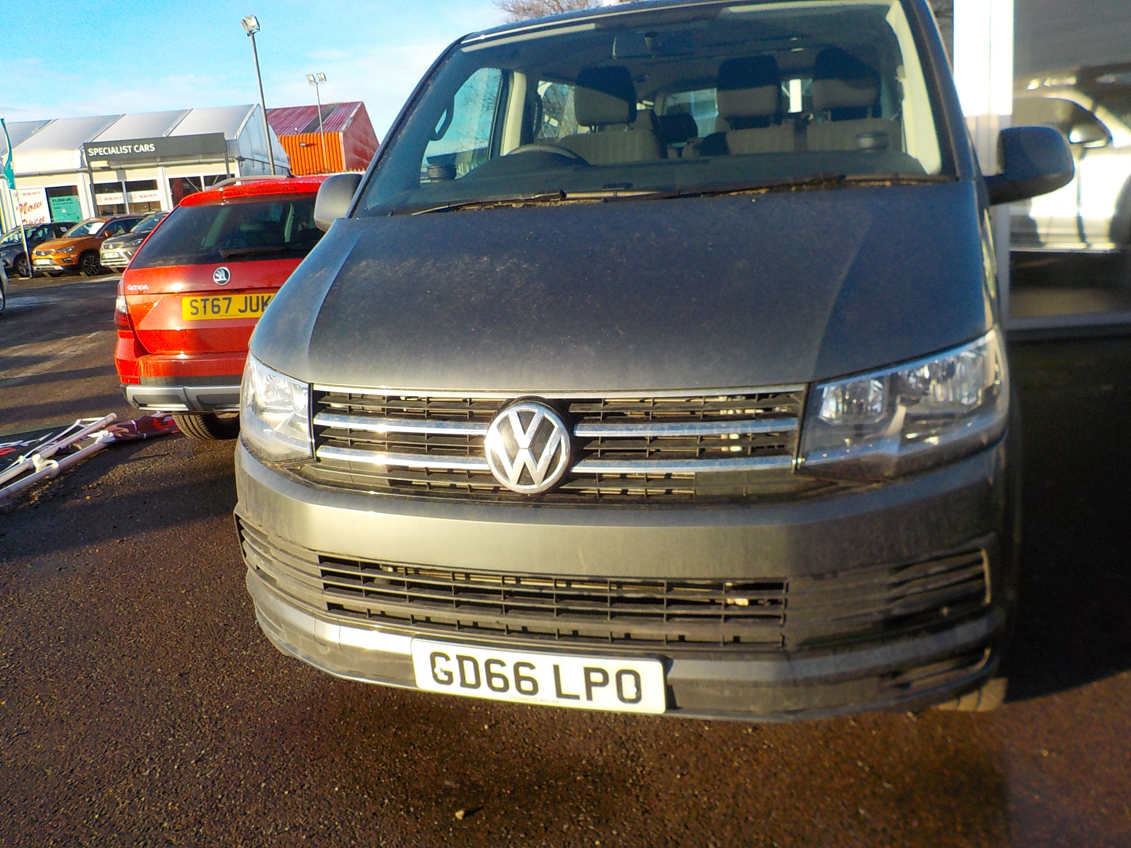

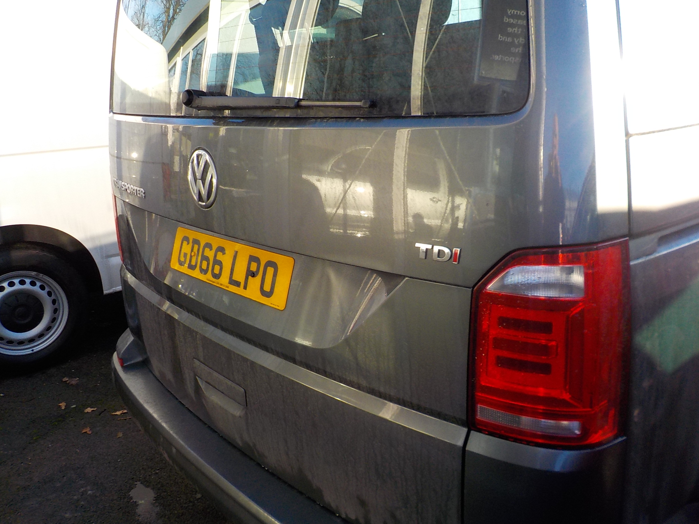

I had a quick look this morning at this Minibus that was already sold. a 2.0 TDI 150 ps DSG.
I asked what the DSG was and he said 7 speed, so i asked 7 speed twin dry clutch.
He had not a Scooby, what is a Twin Dry Clutch DSG he said, the engines up to 250 Nm says me. Do not need oil changes @ 40,000 miles.
No they are all 6 or 7 speed says he, they will be different from in the cars.
EDIT.
So that is a T30, 7 speed DSG,
& the 204ps are T32, 7 speed DSG.
MY18_passenger_carriers_pl.pdf
Edited by AwaoffSki
mac11itrI,
just wanting someone that knows to confirm the 150ps ones come with a 7 speed wet clutch DSG, so will need 40,000 mile DSG Oil changes.
@AwaoffSki
My reaction was to the sales guys lack any knowledge on what hes meant to be selling :D
Lack of interest really, he has been there long enough, i got his card, because it is not for me, but he just lost out on a £32,000 sale.
They think they are smart sometimes with a price on a window, and when you mention it they say, that is without VAT.
Well that is not unusual with a Commercial, but then do not stick them next to the road with ones with prices that do include VAT.
