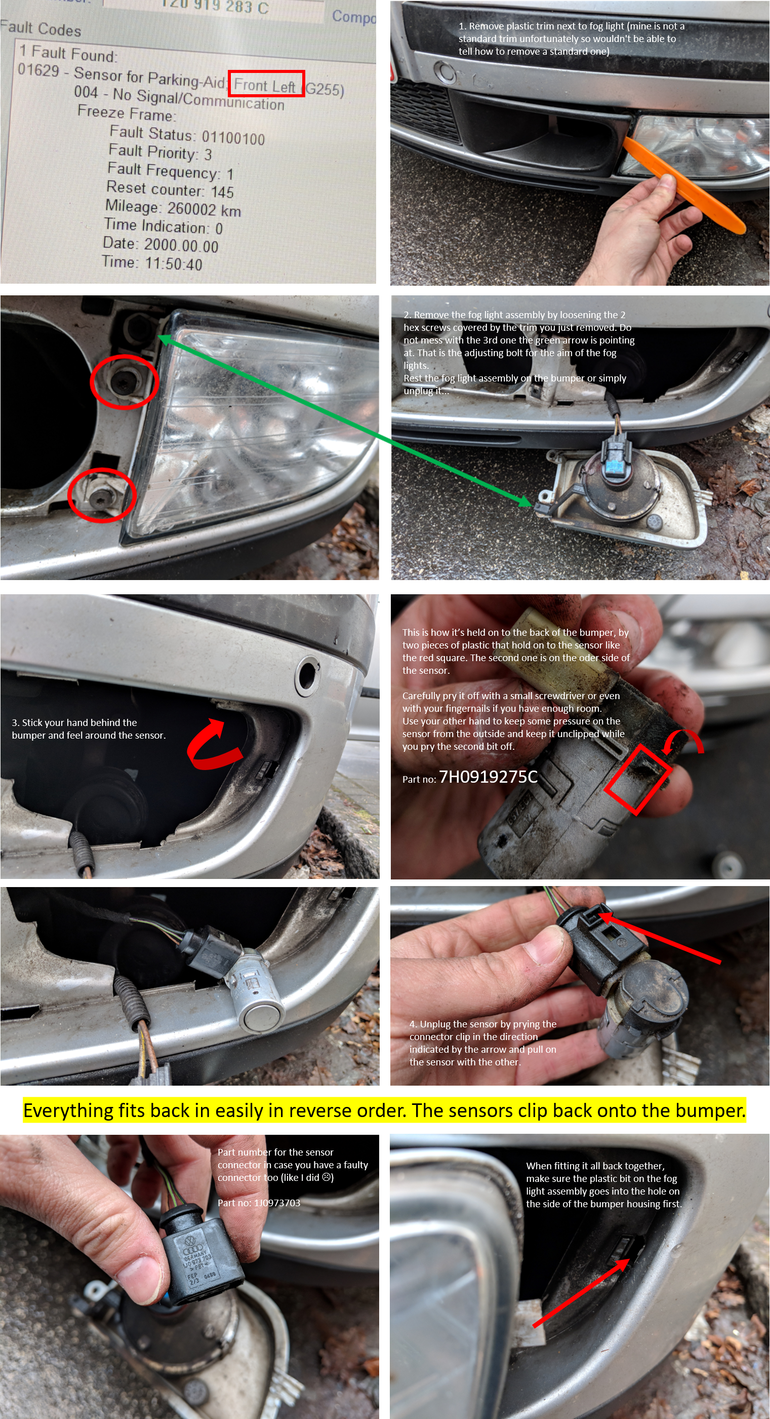

I've just gone through the experience of changing a faulty sensor on my 2007 pre-fl so I thought I would document this a bit for future reference and helping others too. Trying to keep it short and picture-based.
To begin with, my car is fitted with PDC parking assist and the part number for the sensor is: 7H0919275C
Personally I had a faulty sensor connector as well (perhaps that's why the sensor ultimately gave up. Part number for the connector: 1J0973703
You should be able to zoom into the picture to read the text - It's the only way I could fit all the pics in under 10 MB :)
