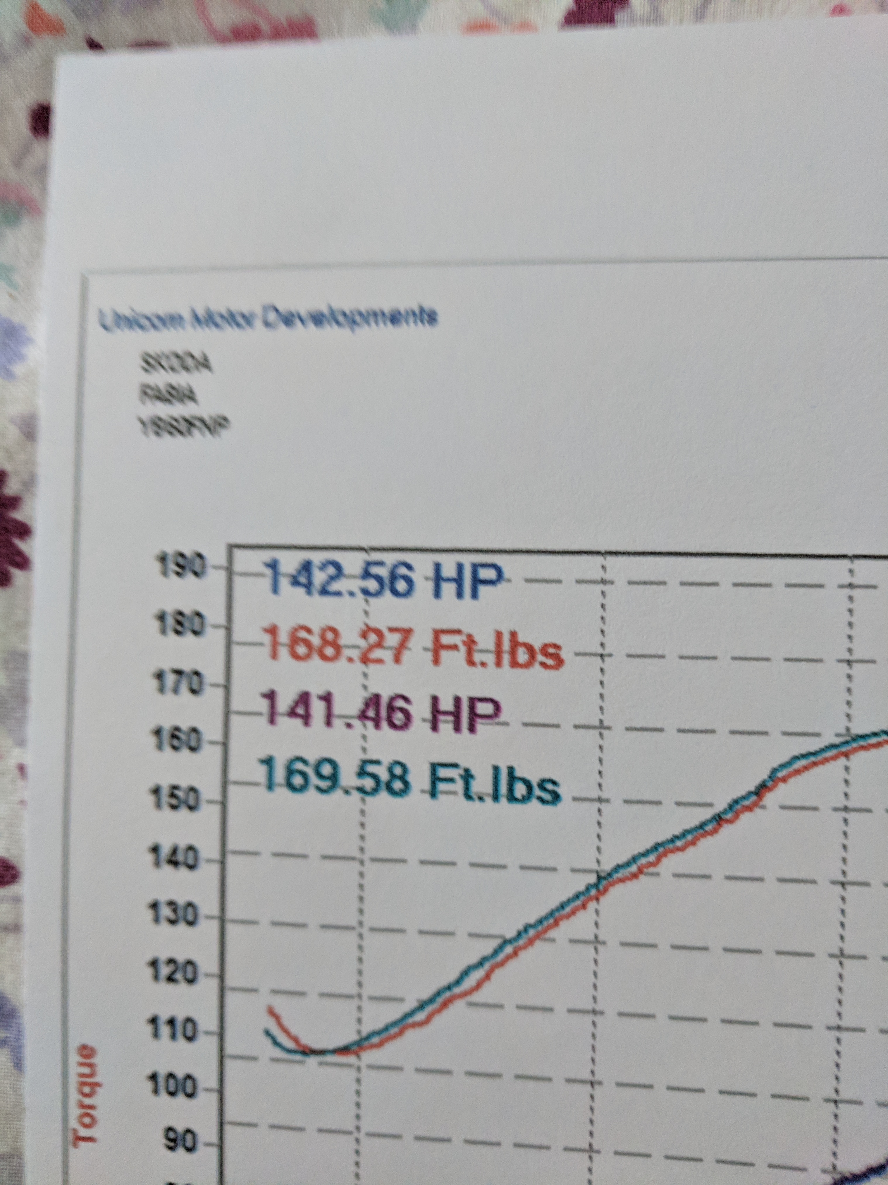

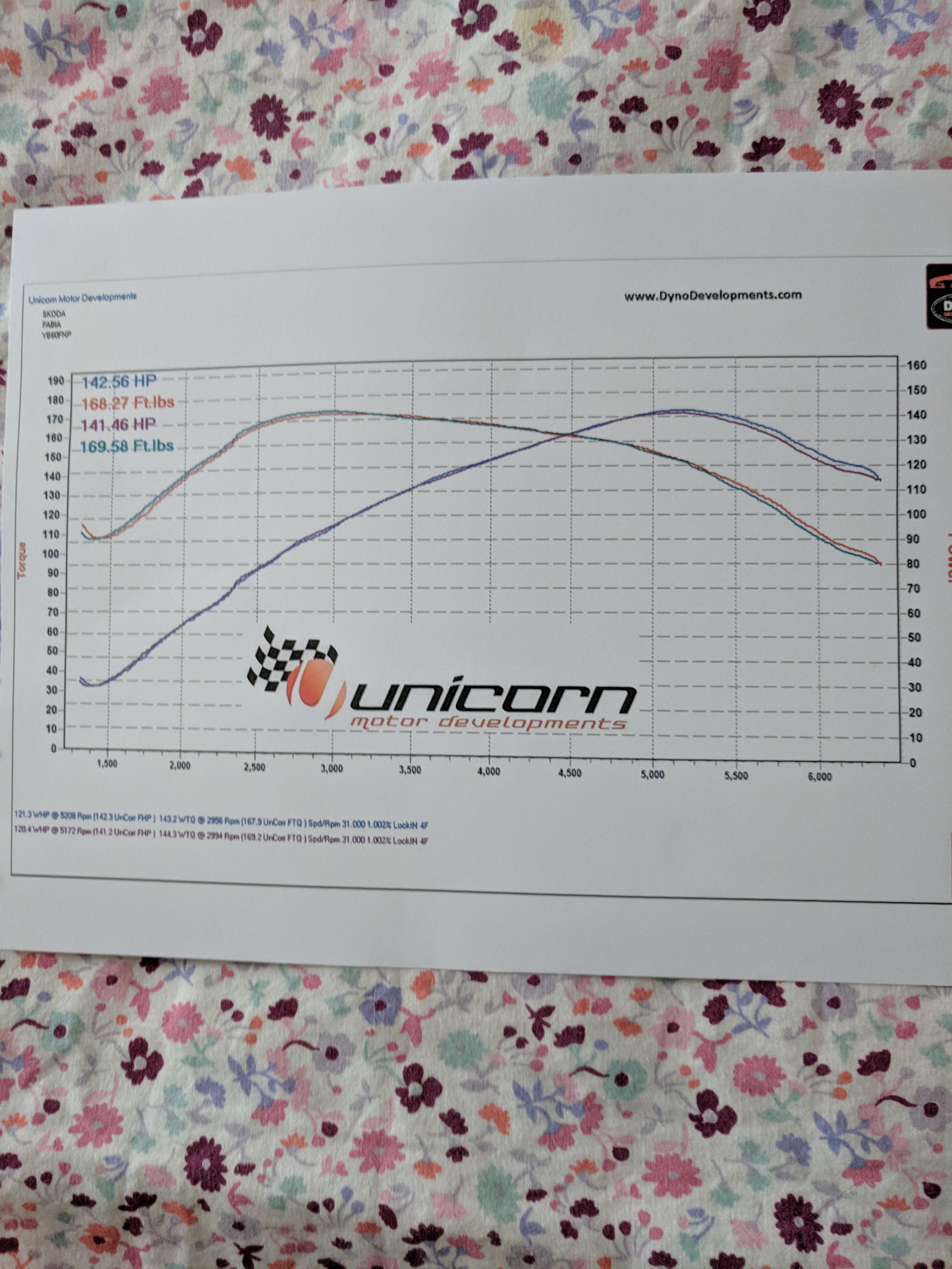

Right had the on the Dyno and now 142hp 160 lbft
That's a great result was that from just getting a sports cat, or, was the map adjusted to suit the sports cat?
The sequence Oct 16 122hp remap , Nov 16 cat back then April 18 sports cat and pipercros filter and May 18 Dyno 142 hp  result. No remap tweak, have been and was running using Tesco 99
