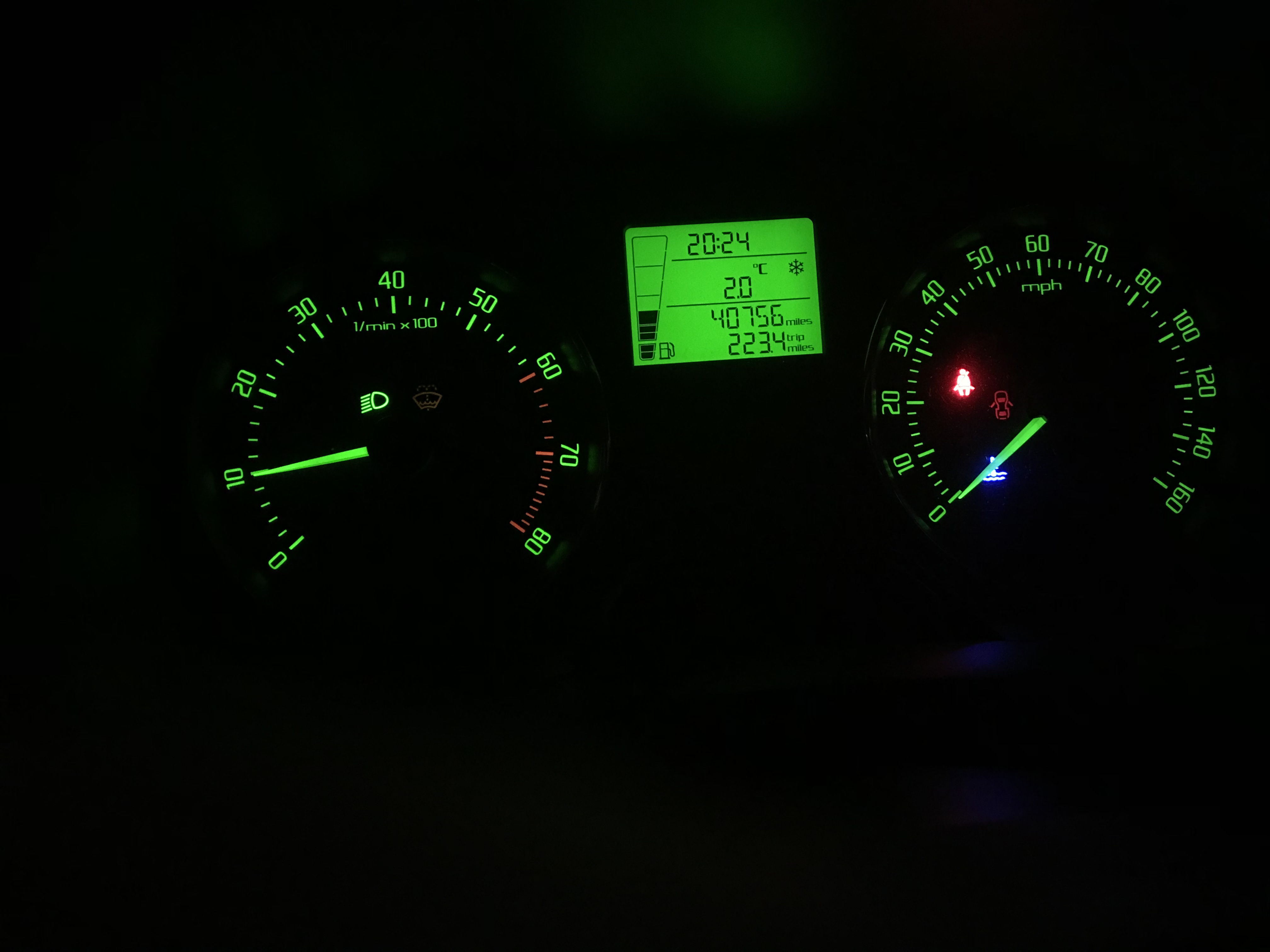

Please help I’ve notice the washer light and door open red car are faintly lighting up
when main beam is on
turn ignition on there on
switch to side lights they disappear
soon as main beam is on they light up again why is this
there not fully illuminated as if the door is open it’s fsint but enough to see in dark it’s annoying

main beam is top photo

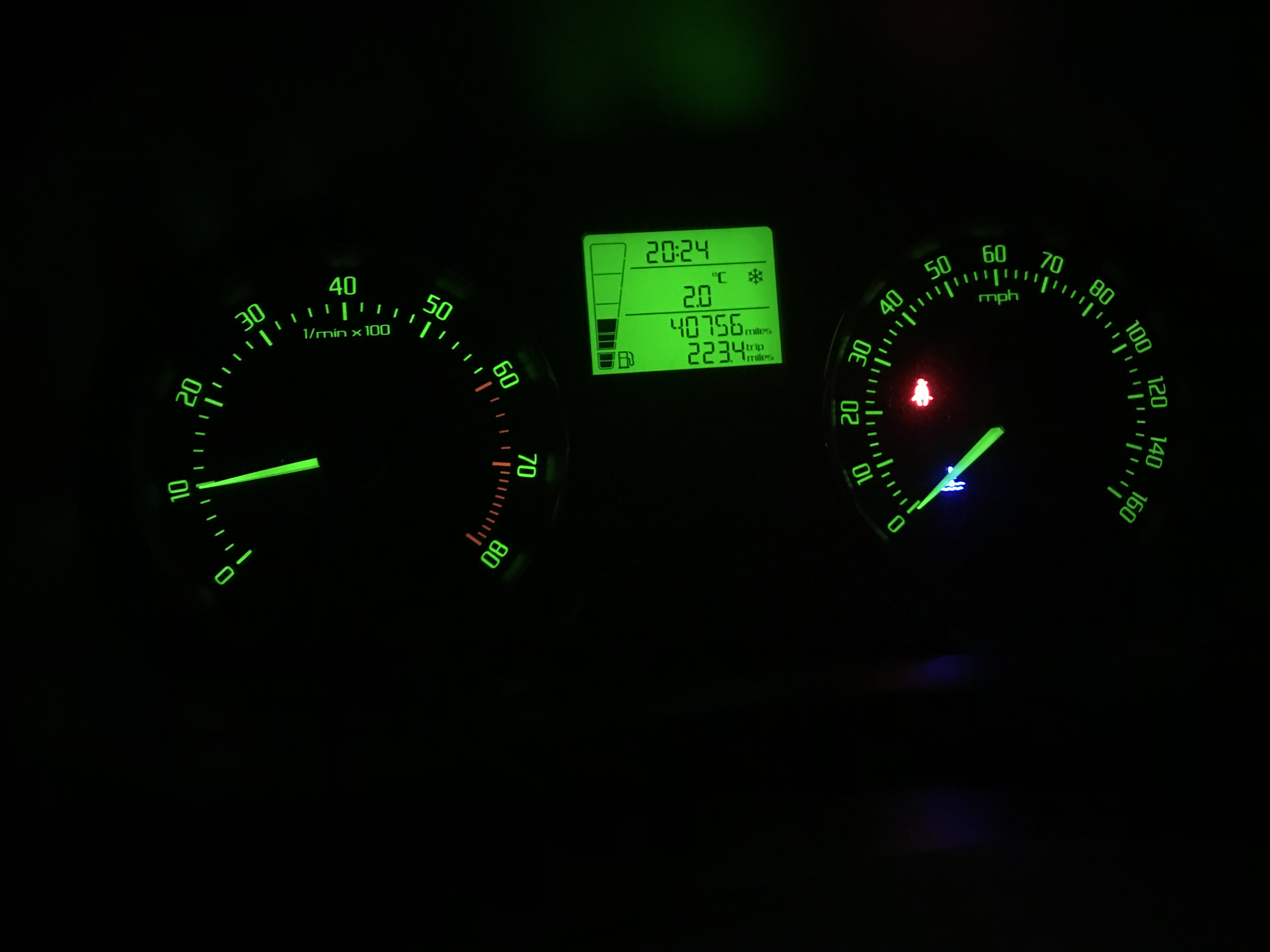

Bottom is side lights
there is either an issue with the eeprom on the cluster or one of the mosfet on the pcb is failing

you might be able to send it to a dash specialist that can fix issues like this
£600 would be a new one, you can do it for a lot less than that
