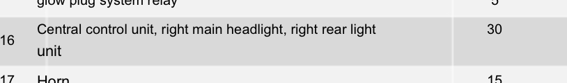

Good, we now know it's the correct fuse - thanks

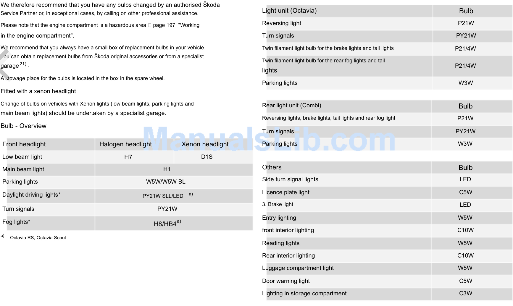

Gerardf, have you changed any of the bulbs to non-standard?

30A seems a lot for lighting...........  that's 360 Watts which is more like a heating load or a pump.  Does anything else fail apart from lights?

Well over the years maybe one or two bulbs have gone, but only ever put in the normal h7, the only thing modified in the car is a phone kit, which looks to be well done and I don't even use...
Sorry and also the f16 fuse is a 30 amp on the manual....
A 30A blade fuse will carry a 10% overload almost indefinitely.  But a 100% overload will 'fuse =' in 5 seconds or less.  I guess your circuit is sometimes overloaded, but not for long enough to melt the fuse part.

I’d check all the offside bulbs are correct, front and rear as F16 is for both. If they’re all alright then it’s either wiring or the central control unit.
