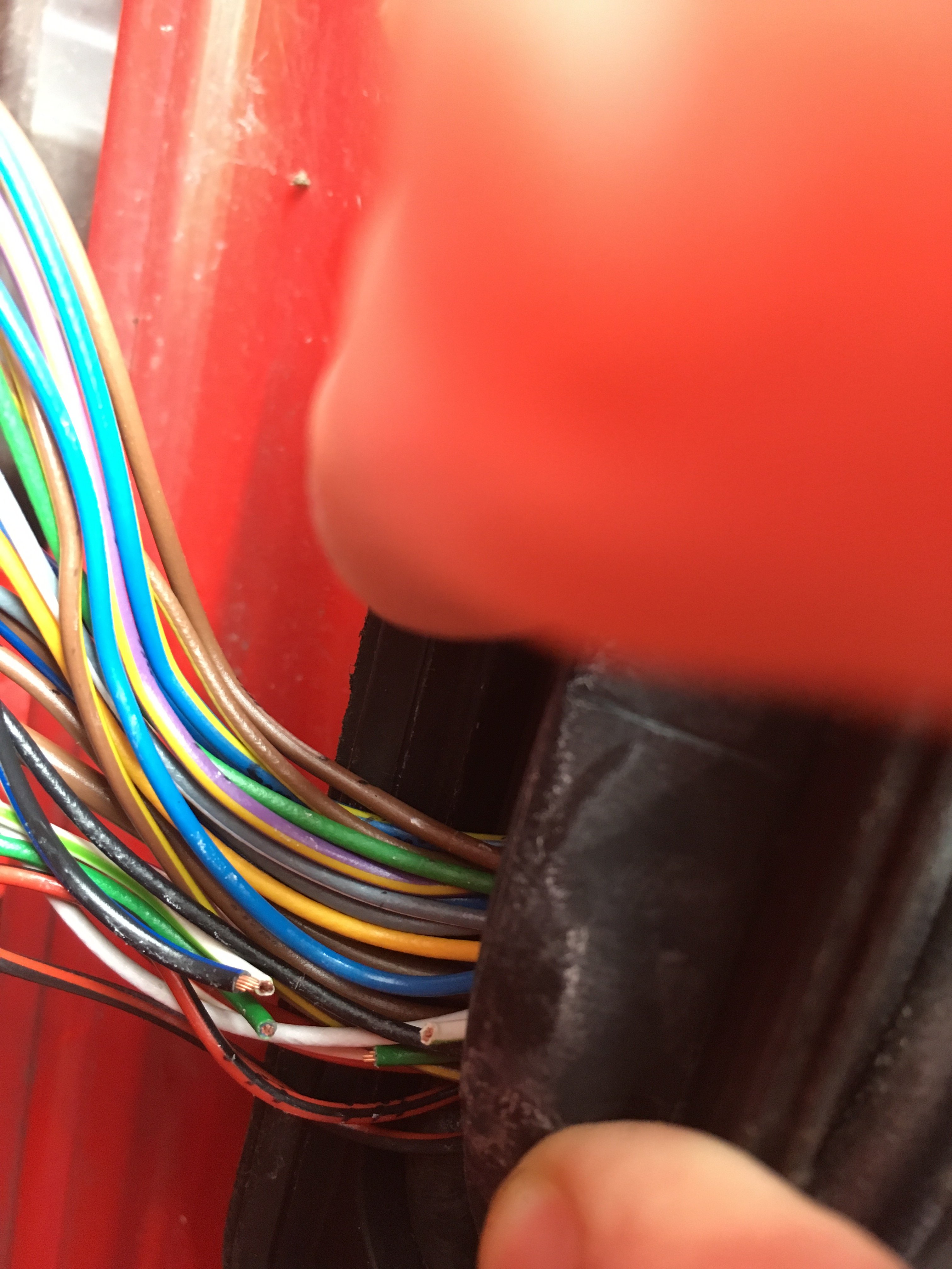

Thanks so much everyone. I took off the interior of the door and no flooding (as suggested on a google search) and also found some wires between the door and car body that were cut (stuck in door I guess) - however the wing mirrors have never worked via the switch so I suspect it could be that. Have checked fuse on dash but not engine so will have a look there next.
Really appreciate your help thanks.
Pic of door wires attached
Yeah, door wiring always a worthy suspect of window and mirror gremlins!
