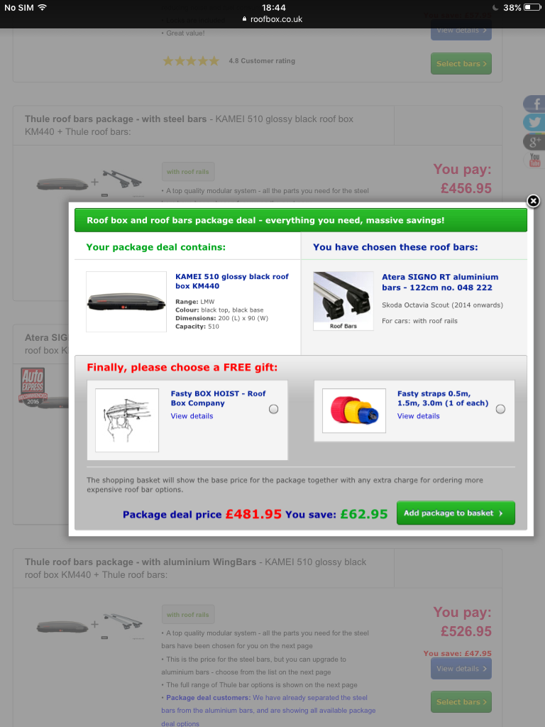

Looking at reviews the Kamie 510 looks to be a good one.
Has anybody fitted one of these to their Scout, and if so, what roof bars did you use and does it do the job?
Or can you recommend a similar box and bars?

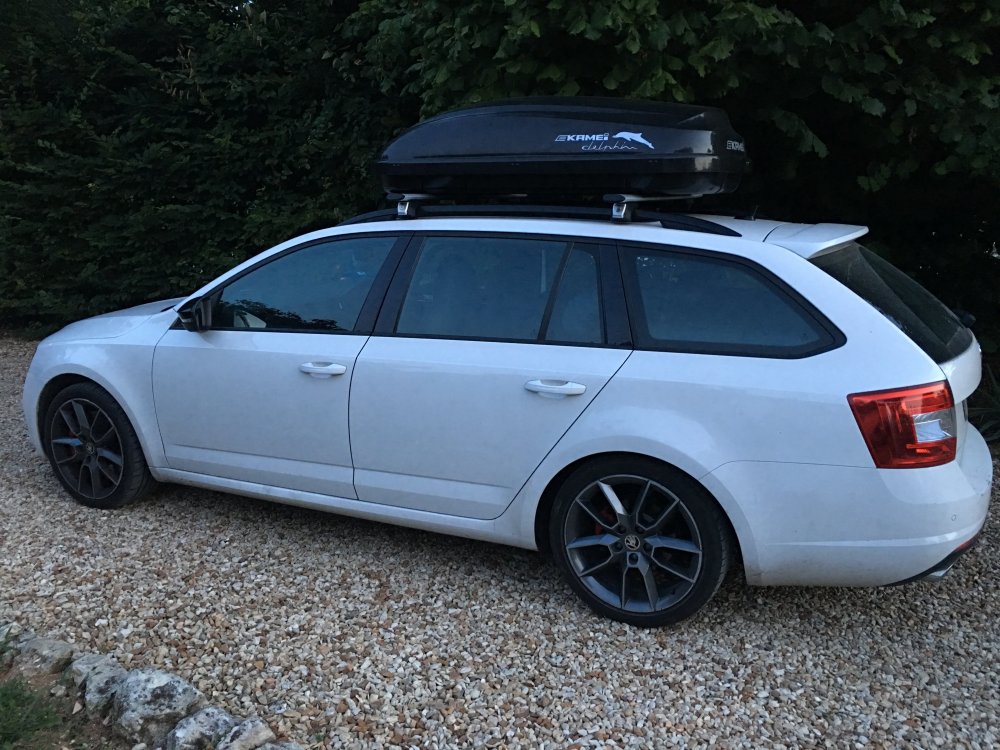

I bought a Kamei Delphin last summer.
Very happy with it - quality piece of kit.

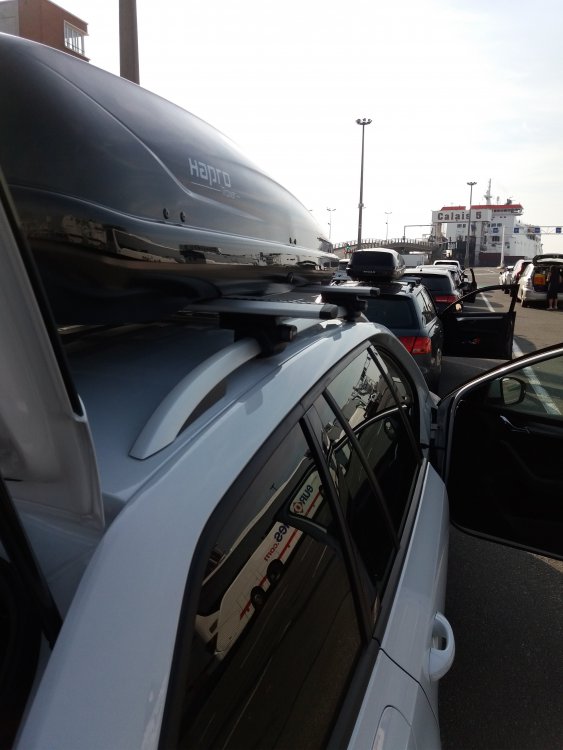

Hapro Traxer fitted to our Scout, with Thule Wingbar 961 and the 757 foot pack...

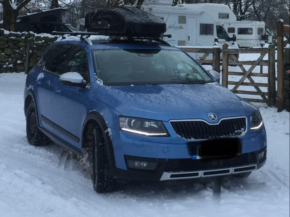

I’ve got the Kamei Husky XXL with Thule wingbars on mine. The box is great quality and really spacious.
The 510 looks very similar, I think the only difference is it’s dual opening and the husky is one side only.
I’d go for bars you can get different foot packs for, so not the Skoda ones or you’ll have to change the bars when uou change car. Also the T track fittings are well worth it.

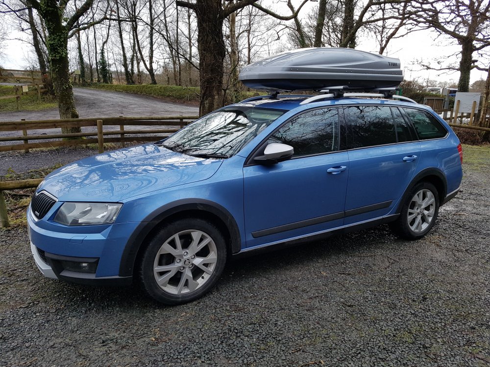

I've got the Thule Atlantis 200 with Thule bars.  I bought the roof box new 12 years ago and have used it loads.  Getting them onto the car is ideally a 2 person job and you need somewhere to store them.  Mine goes on top of a cabinet at the back of the garage to save it from being damaged.
The best way to pack them is get bulky items in first and pack smaller stuff around them in small bags or plastic bags - I keep opening and shutting it as I go to ensure it will lock.
If you haven't driven a car with one on before then make sure you know the height of your car with it fitted ( for low car parks / barriers), they can produce wind noise and will effect fuel economy. I fit mine as far back as possible (whilst allowing the boot to open).

Let’s start a scout roofbox club:biggrin: got mine off  an auction site,.good bargains to be had, mine leaves room for my kayak and it’s easy to carry/store as half width, ps Scoutcjb, nice colour car you got there

If I order the Kamei 510 box with the Altera Signo Roof Bars without the "T track" will that be enough kit to mount and use the box?
Is it straightforward to fit myself (I'm pretty competent as long as the fitting instructions are clear)?
Also, as I don't have a garage, is the hoist any use to me or should I opt for the straps as my free gift?

John, mine is a vRS so lower than yours.
I did a rough calculation before a ferry trip last Summer.
Roofbox = 146.5cm car + 46cm
