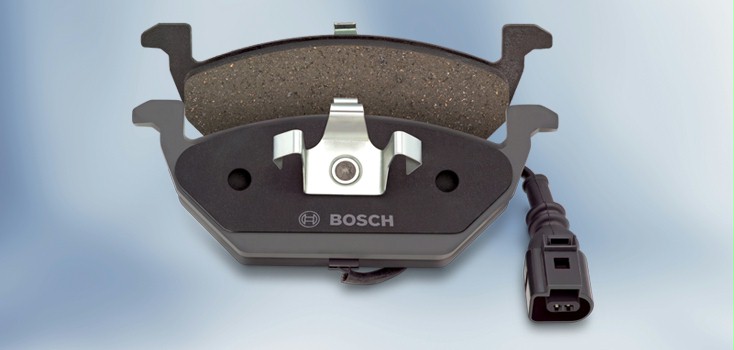

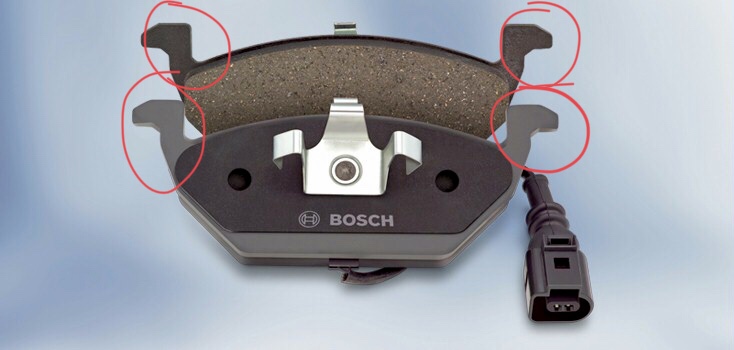

You’ve cleaned up the original calipers before replacing them and the pipes. I assume the disc and pads are still the same.  If this is the case then remove the pads and file the tabs down a bit so you remove the burrs. They should fit into the anti rattle clips easier then. I had this problem with the Octavia brakes that would bind and it was nothing more than the pads fitting too tight due to the burrs not removed. Also ensure the sliding pins are only lightly greased.
Ok thanks.  Will do.
Yes the pads (fairly new looking) and discs are still the same.
I've only seen the pads off during the initial calliper clean up.    From a quick google image search they looked like this minus the cable.
Which bits on the pads do you mean (sorry newb question)?
Thinking about it, It took a lot of effort to fit the pad back into it's holder on the outer face of the calliper.  No probs with the piston side.
The tabs or ears on the left and right

Good to remove any rust from the surfaces that those tabs slide along too.
