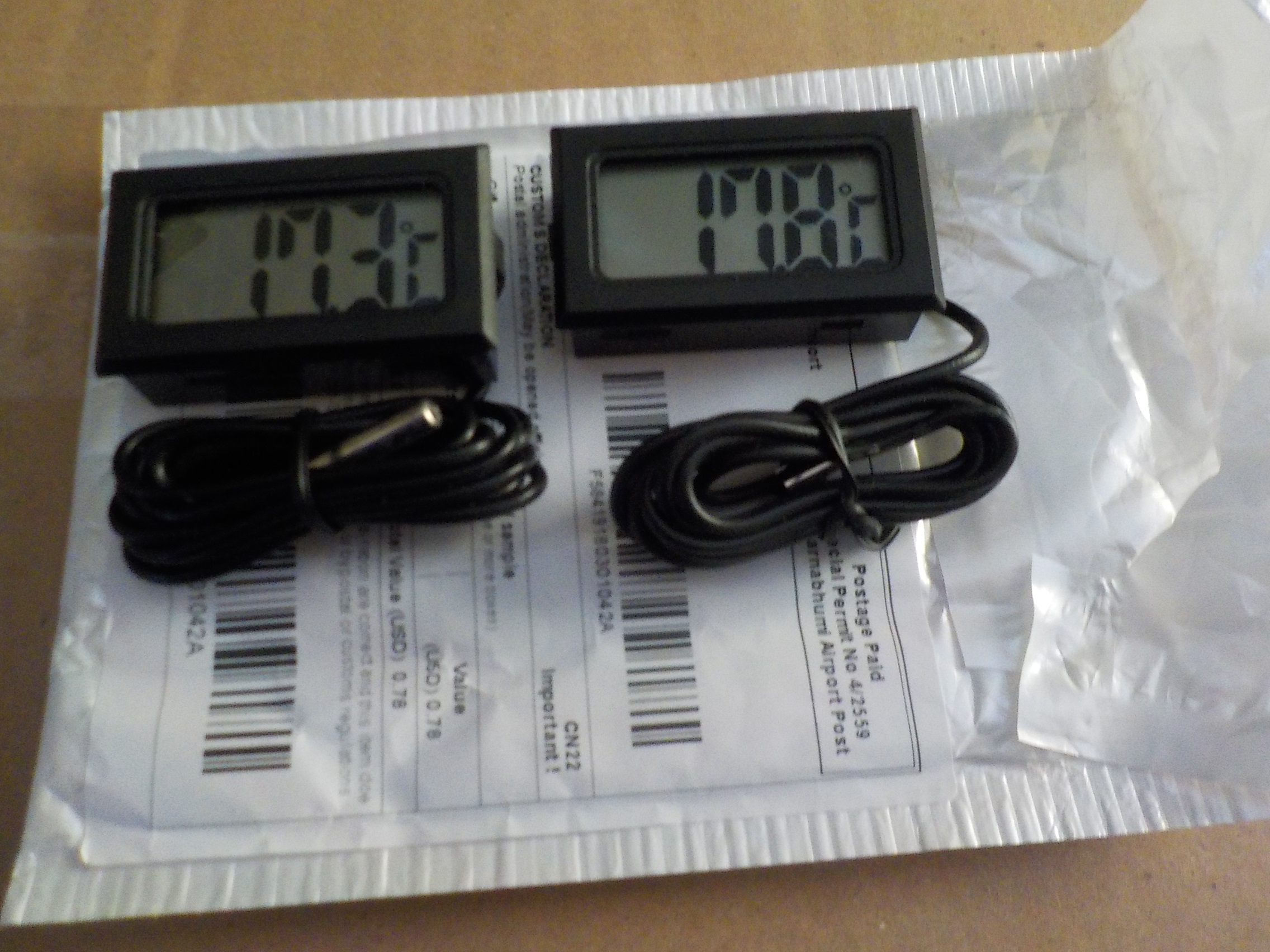

Many years ago i learned that putting a finger on a disc to see if hot was a mistake and spitting on them a bit Kerb Side Autos.
A Cooks thermometer as for checking meat is so handy (edit), as is cheap digital fridge thermometers, checking brakes, tyre temps,
and Cold Air intakes etc to see if you get them right for cold air being getting in.
