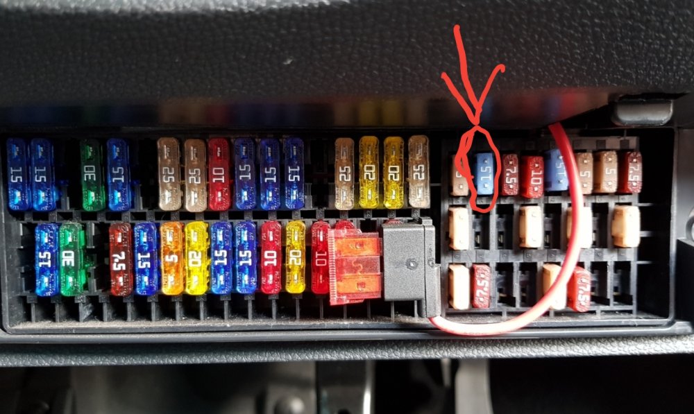

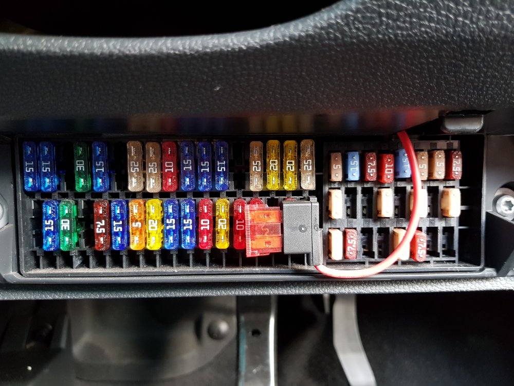

Can somebody help out a complete noob, when wiring in a bluetooth Mic into the interior light I think I have blown a fuse as the light isn't working any more.  Can anyone point out the interior light fuse? I know it's meant to be no.23 but for the life of me I can follow the fuse diagram
The fuse panel is likely Left Hand Drive in the car (ie wrong way round) so here is the corrected RHD version. Its defo no 23, (7 from end reading from RHS top row)
5ab16afc7fff3_fusebox2.png.b2c3076400f373243e3ffc606c1b9d2f.png5ab16b0891055_FusePanelCorrectionRHD.png.f81d78dfcb6babf8d632ecb74426f444.png
For me looking at that diagram now the only one that looks like it would be the interior light is the blue 15amp fuse I have circled, I'm terrible at this stuff
yes thats correct
Ok so the plot thickens
Turned my head lights on this morning and the DRLS completely turned off also no rear lights other than brake lights.  On the plus side the fuse on the interior light has blow so it should be an easy fix!
All issues solved with a 30p fuse
