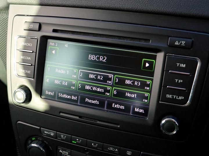

What headunit do you currently have? A picture would be great :)
This is the one :) A Bolero. I have noticed most of the Yeti's from 15' onwards have the newer Amundsen I think it is?

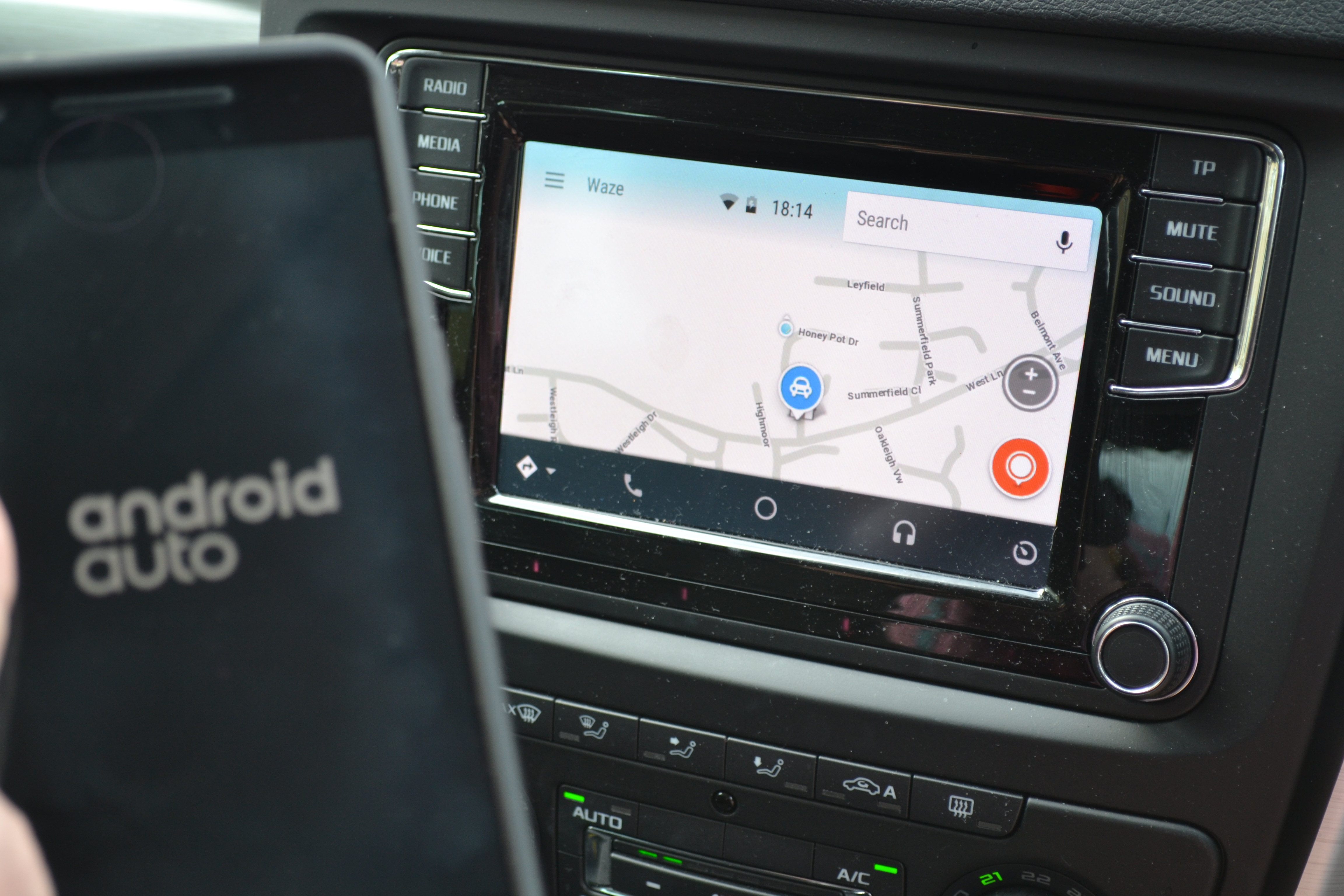

I think it's still Bolero, but a newer version, in our 16 plate.
This is ours, running Waze via Android Auto.  CarPlay support, along with AA and Mirrorlink, comes with Skoda's Smartlink, I think included with 2015 cars on, and needed unlocking at the factory, or as a dealer job after.
I think you'd need a newer Bolero or above, or a CarPlay compatible third party unit.

I bow to the clearly greater knowledge of langers, but my understanding had been that all screened units had Skoda's Smartlink built in from around early summer 2015. The software needed unlocking ("licensing") either at the factory, or via a dealer after. Cost was £125 IIRC.
We specified it with our second Yeti order in early 2016, and it was done at the factory, ready to go on day 1.
Smartlink is what Skoda call the feature giving access to Android Auto, CarPlay, and the older third party tech Mirrorlink, which Apple don't support.
Again, my understanding is that Smartlink is coming through now as a standard feature. It certainly is with our Karoq on order.
I've no idea how you'd recognise a compatible head unit, or the factors involved in fitting it to a car without it originally, but good luck :thumbup:

Your Bolero is a different shape to either the RCD330+ or MIB2 headunits that were fitted from mid 2015. It's only a facia change that's needed to fix this.
