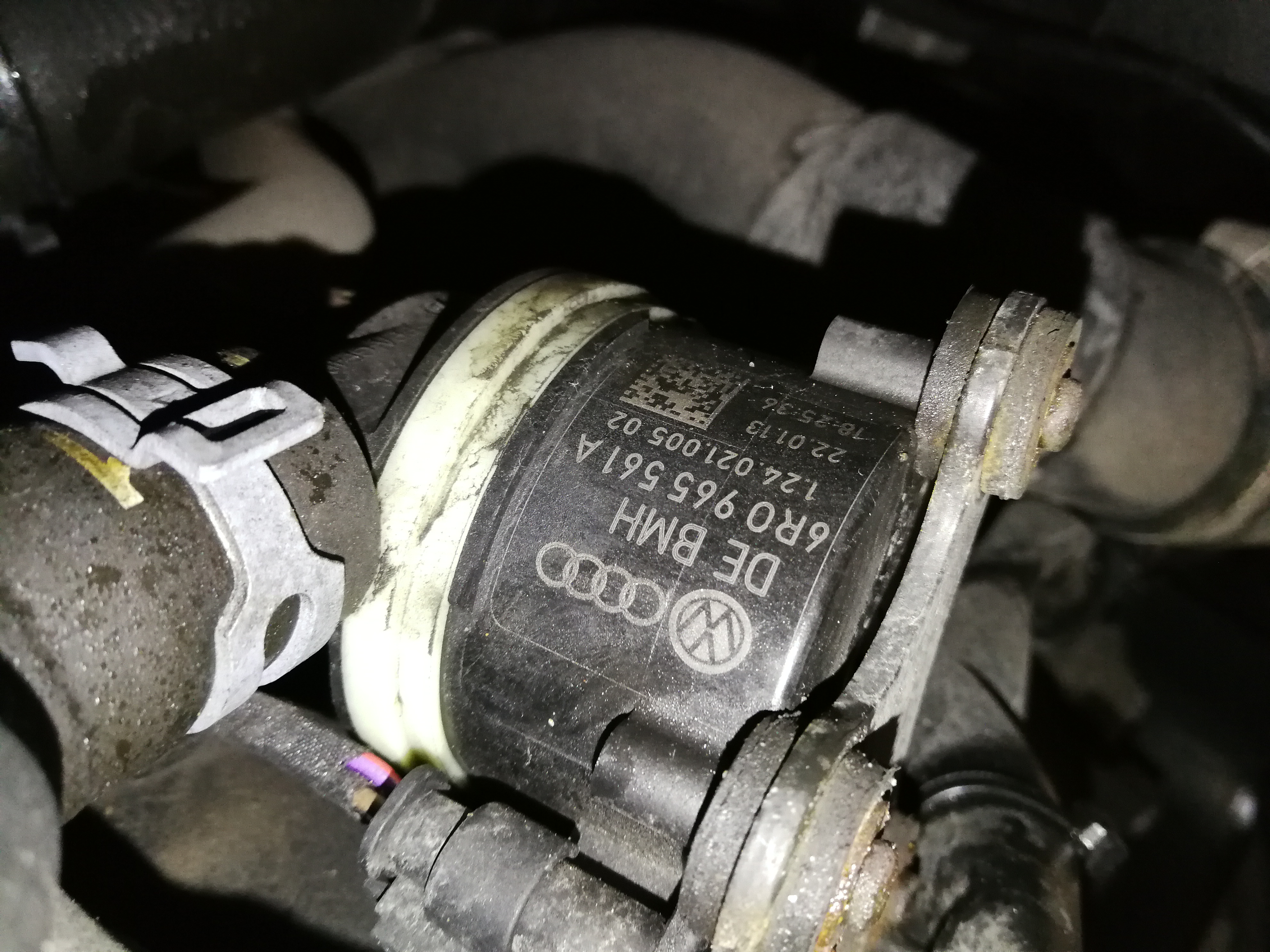

     I had the engine light come on and a friend used a gadget and found out the fault code related to an auxiliary water pump that was intermittent.
Apparently called water pump b.
Does anyone know the correct part number for a new one.
Engine is a 1.6tdi 105 fabia Monte carlo. Year 2013.
 Thanks for the help anyone that replys
Found a part number .on the pump it's self
6R0 965 561 A,
But I can't really find them online . Anyone here know if there is an alternate part number which will fit .
Thanks jim
When searching for part numbers be careful inputting "0" (zero's) and "O" (oooooo's) - 6RO965561A
Also - might be worth trying a QR scanner AP to attempt to read the QR code on the part (might need a clean though)
Is this the same part?:-https://www.ebay.co.uk/itm/AUDI-A3-8P1-8P7-8PA-1-6-2-0-TDI-2003-2013-AUXILIARY-HEATING-WATER-PUMP-5N0965561/232566719086?hash=item36260e826e:g:ePgAAOSwHHFY-iRi
Try part no's 5N0965561 or 5N0965561A "Auxiliary Water Pump"
