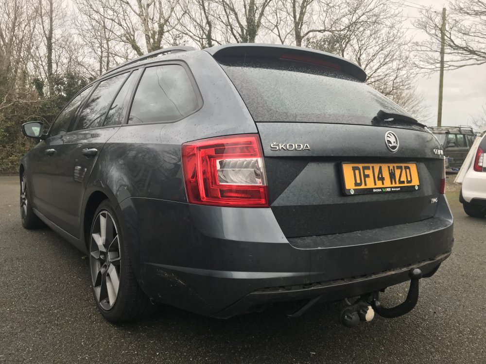

This is a Witter swan neck with twin electrics, all is out of the way of the sensors. Please ignore the missing reflector strip and exhaust trims...

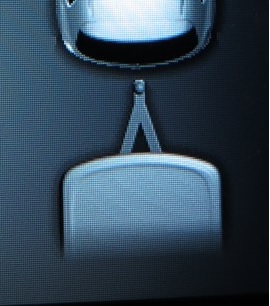

I coded with VCDS on my old Oct 2 and it is simple to do (even getting it to show a trailer in reverse on the screen).  My old Oct 2 was a Scout and its important to programme another code (to do with traction control/4wd system).

- there is no picture of a trailer on the (Admunsen) "CAR" screen

* Rear Parking Sensor / Auto-brake disabled - Infotainment display shows trailer attached
