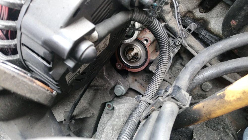

Back in bonnet use 10mm long nose six sided socket to remove the two bolts.
Pull thermostat housing out of the way.
More liquid to the bucket.
Note thermostat orientation.
Remove rubber ring and thermostat. Which was the hardest bit as the thermostat did not want to come out.

Insert new thermostat in correct orientation.
Insert rubber ring.
Put housing on gently and ensure all is lined up.
Put two bolts in.
