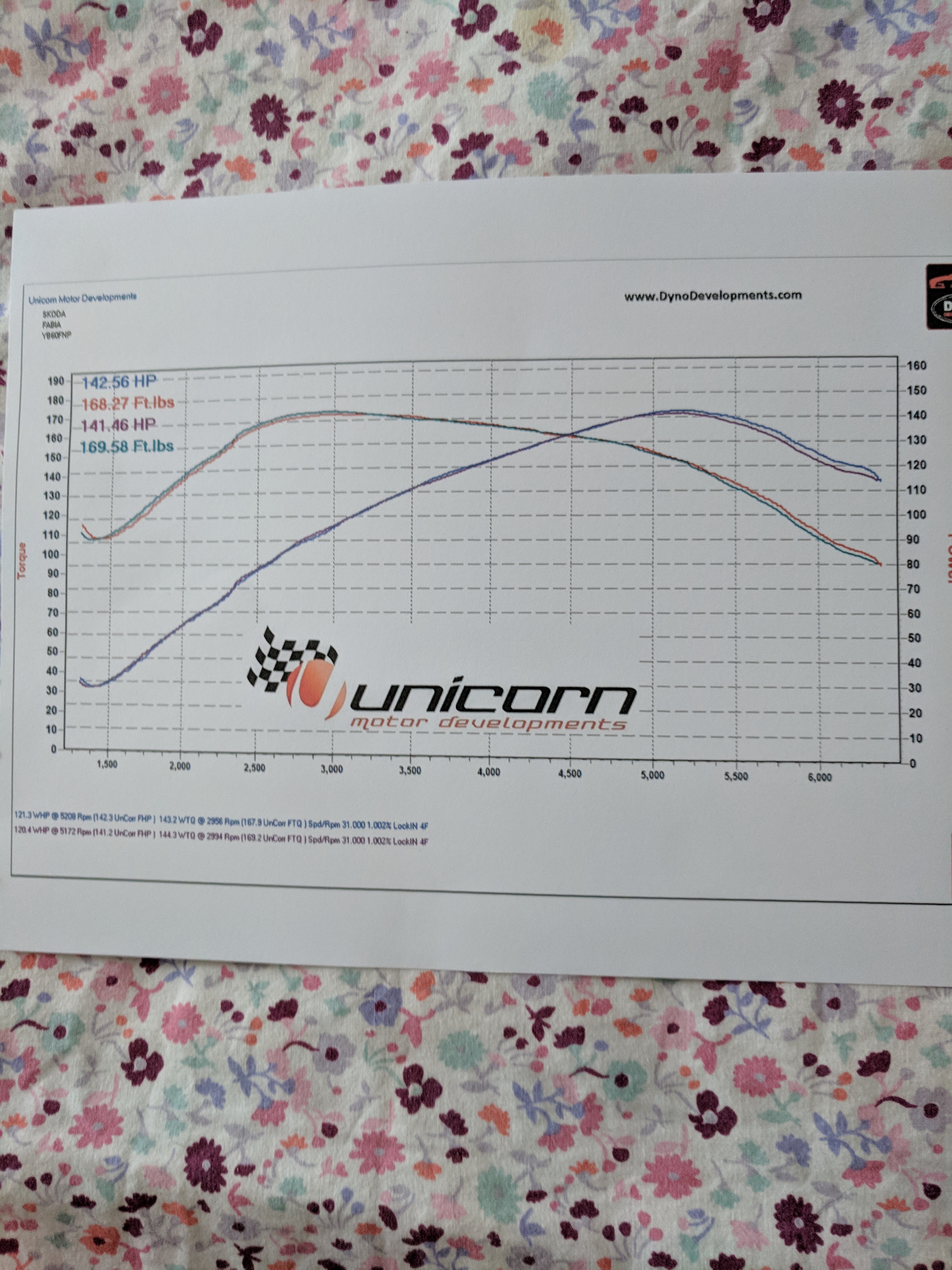

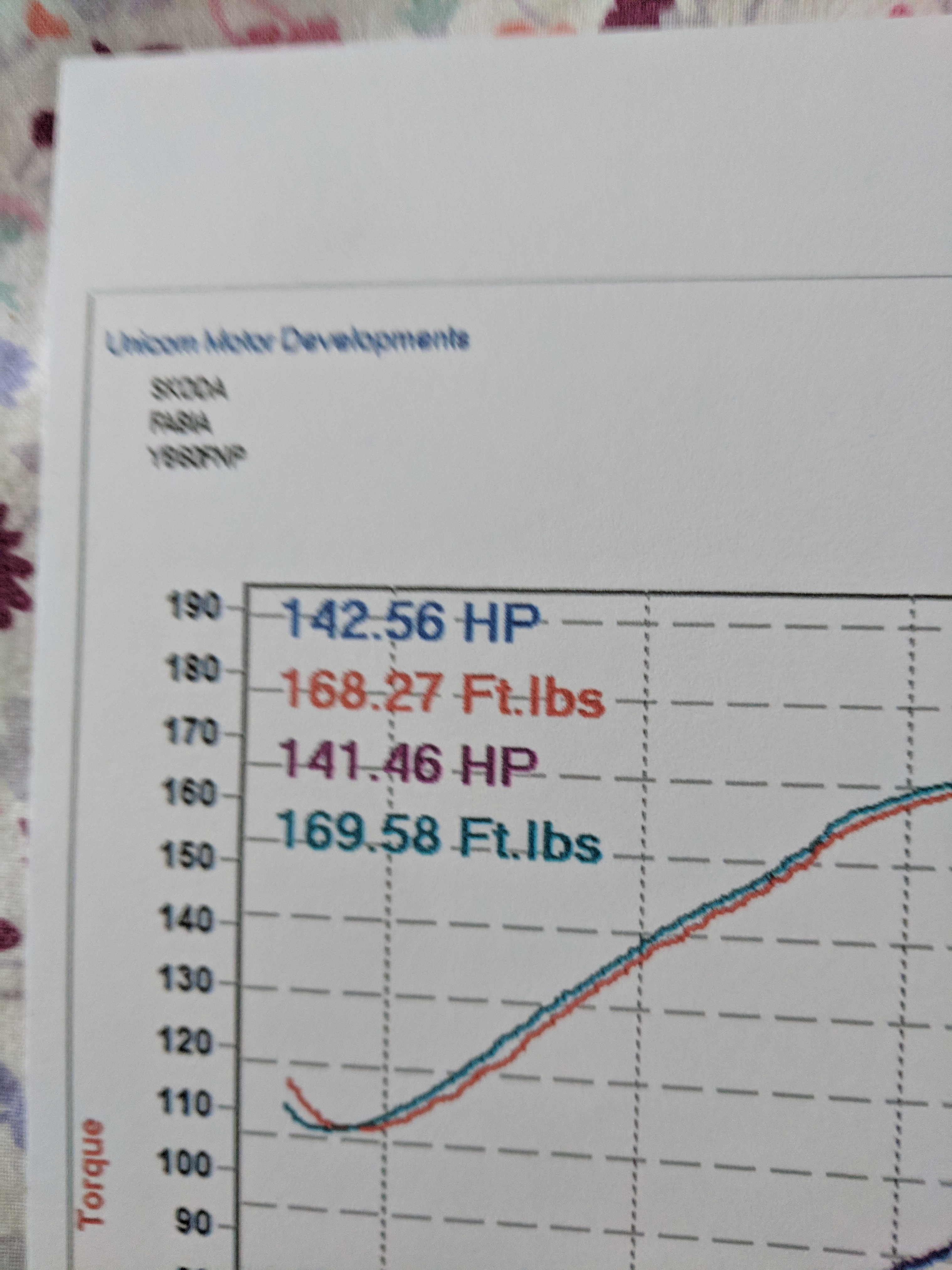

And the car on a Dyno so hp up 84>122 now 142hp170ftlbs

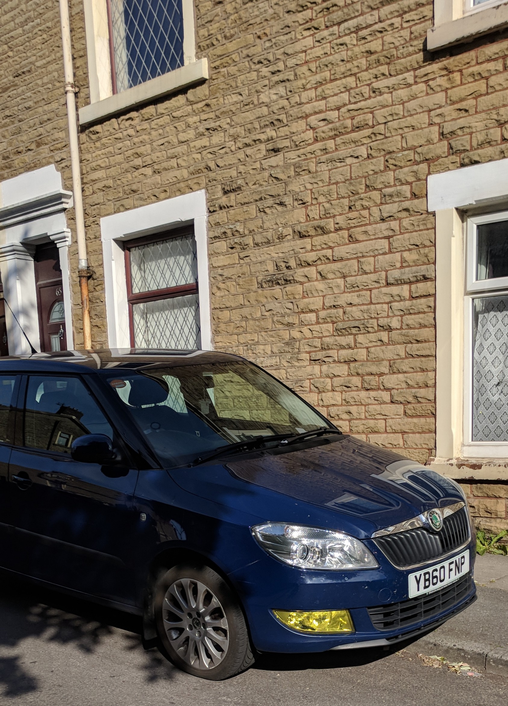

Any pics of the mods you have done to your Fabia?
Davy
Sorry no, I do plan to go skodafest at end of the month. Outwardly the looks no different apart from the lights.
