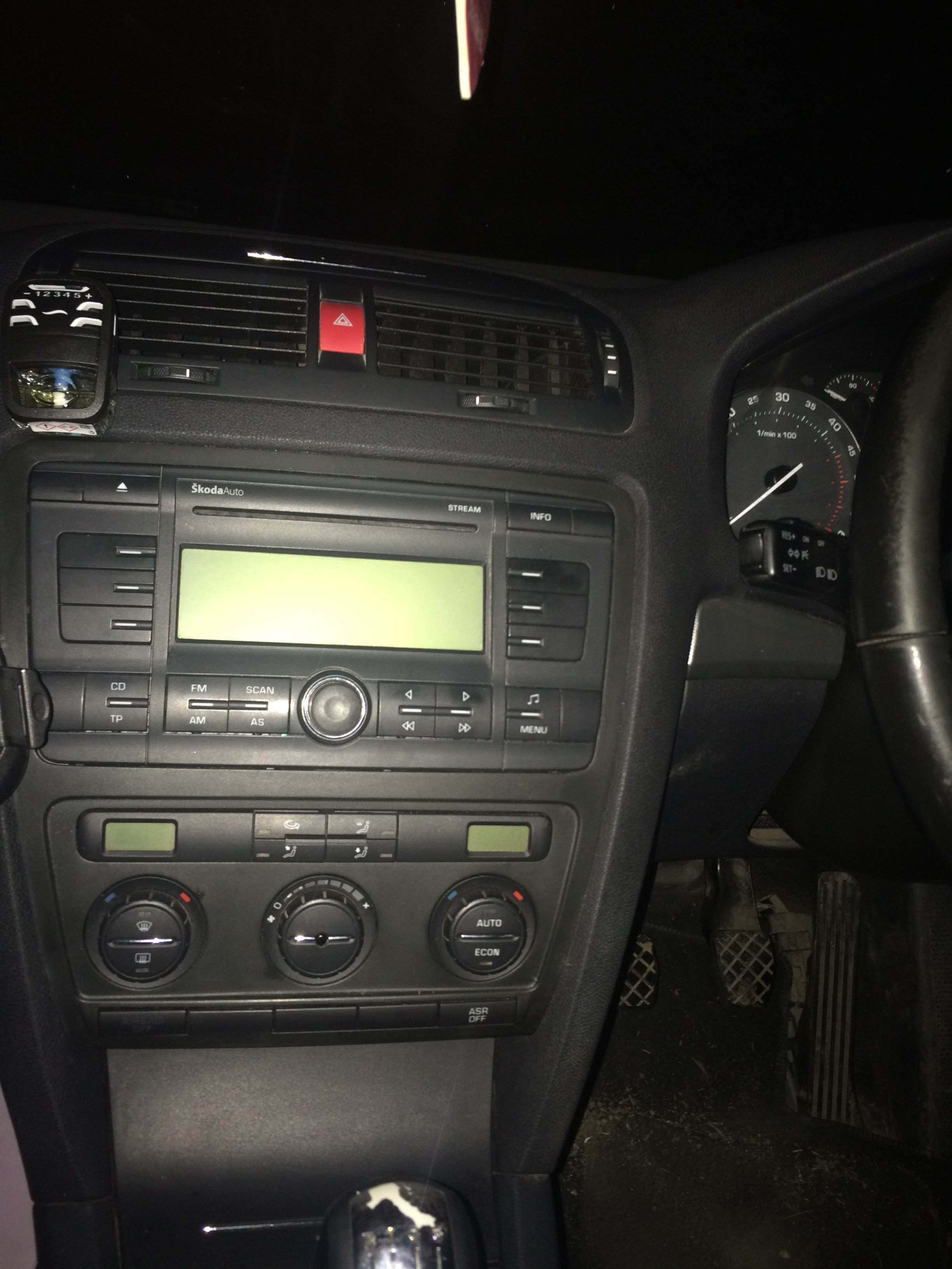

This is a picture of the dash in my car
you have the climatronic panel - the trim you are looking for is having the part # 1Z0 858 069 C 9B9 ( Radio trim navigation "satin black" ) - you can order one from your dealer or buy it online

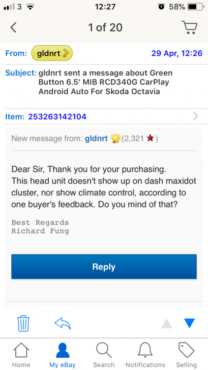

Also I got this message off the guy about the headunit and don’t really know what he is on about if you could shed some light on it that would be great
Thanks Dan
Edited by Octavia2006mk2
Not sure what dash maxidot cluster is??
dont mind about climate control!
Thanks again
There are a few levels of instrument cluster in the MK2 Octavia, the best of which is called a maxidot. It lets you change various settings and will show audio/navigation info when paired with an appropriate OEM headunit.
None of this works with the RCD-330/340/+/g headunits, the only thing displayed is incoming call info.

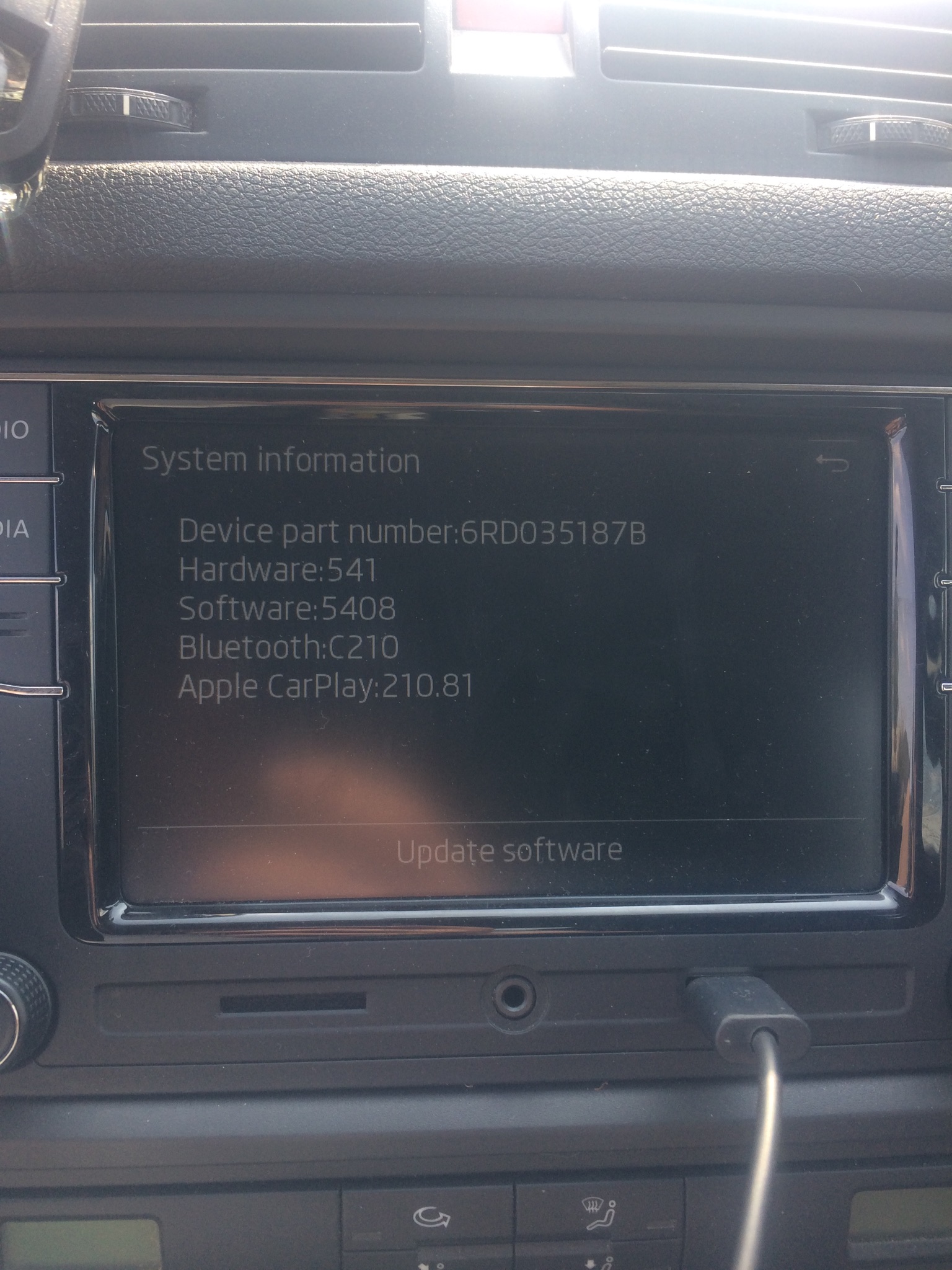

All working fine and a really nice fit the maxi dot is not a issue on mine as it is a pre face lift

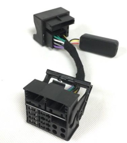

I used this adapter to stop battery drain and you can get different ones to add features if anyone gets one make sure it’s a 187b noname verisiin of the rcd330/340
If anyone can tell me what I need to install that would be greatly appreciated for pre facelift Octavia mk2?
And I will upload a better picture of the head unit tomorrow
