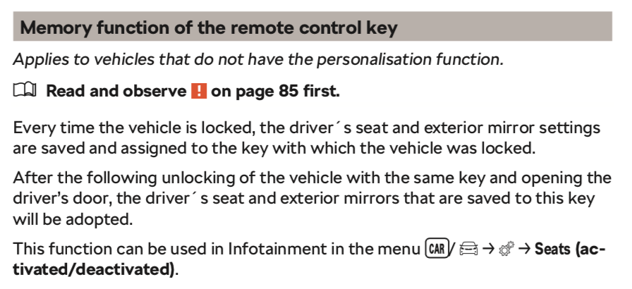

5 hours ago, Macdemon said:
Yes, but if you lock the car with key A and then unlock the car with key B the mirrors and seats do not automatically change.
That seems to contradict what the manual says. I must admit, I haven't tried it because we only ever use the one key, so have it disabled.
