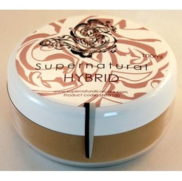

dodo juice supernatural, hybrid a very nice wax ive used it on several light and dark cars and it cures hard and gives a brilliant shine
Image result for dodo juice supernatural
