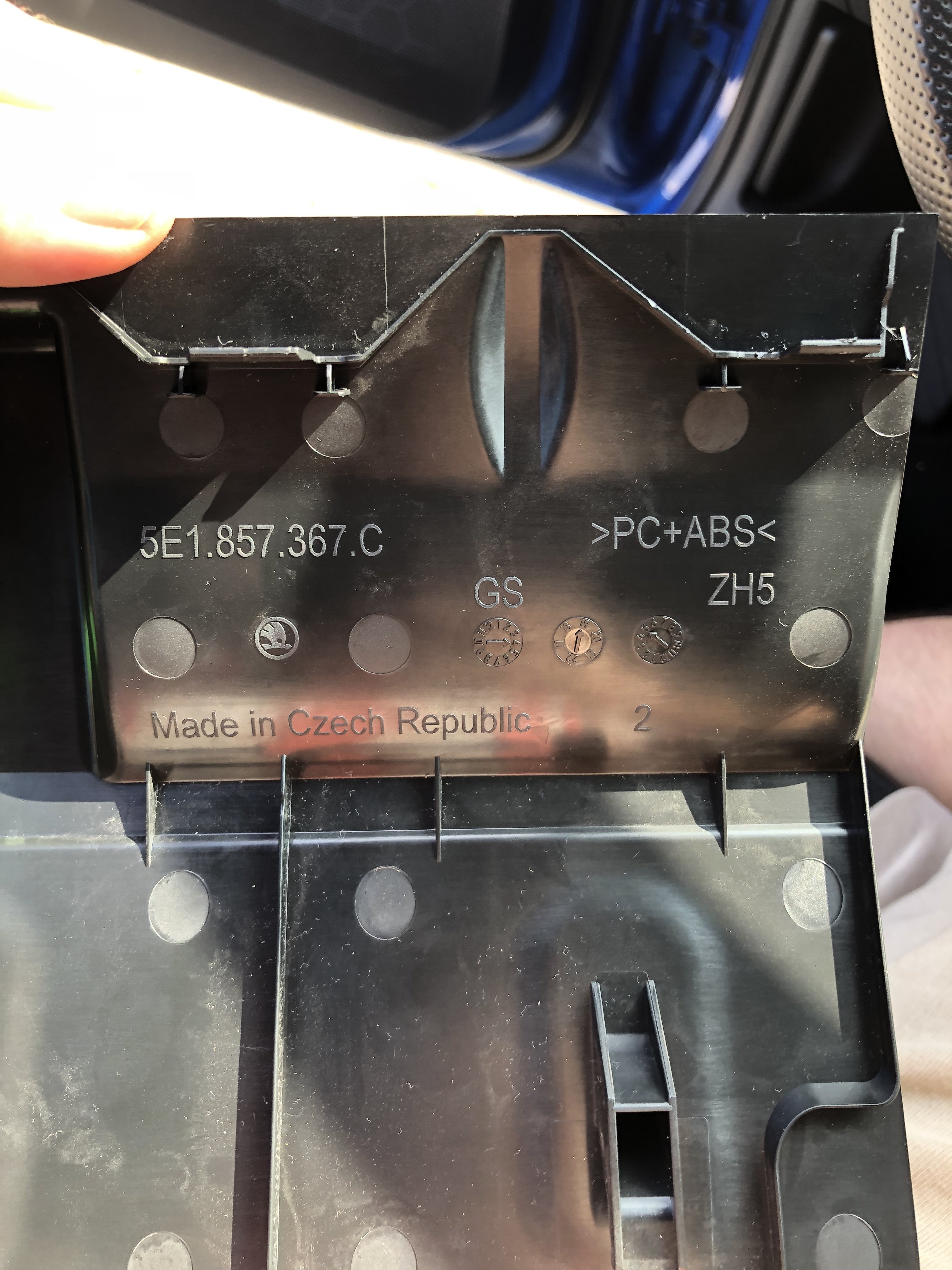

I needed to change from old USB-plug [5Q0 035 726 B] to new one [5Q0 035 726 E] for Smartlink -support, but couldn't find good instructions to do so - so here's my try on those.
Sorry if I'm being picture heavy.
After removing the display

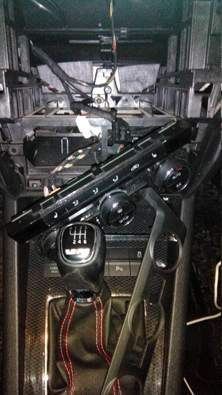

- Carefully detach Climatic control panel (I had 4 plug-in plastic bolts and a plastic trim), electric connectors have a red locking pin
- USB-plug-panel detaches downwards

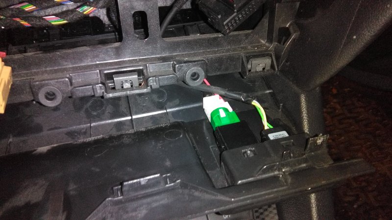

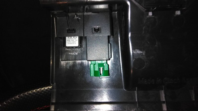

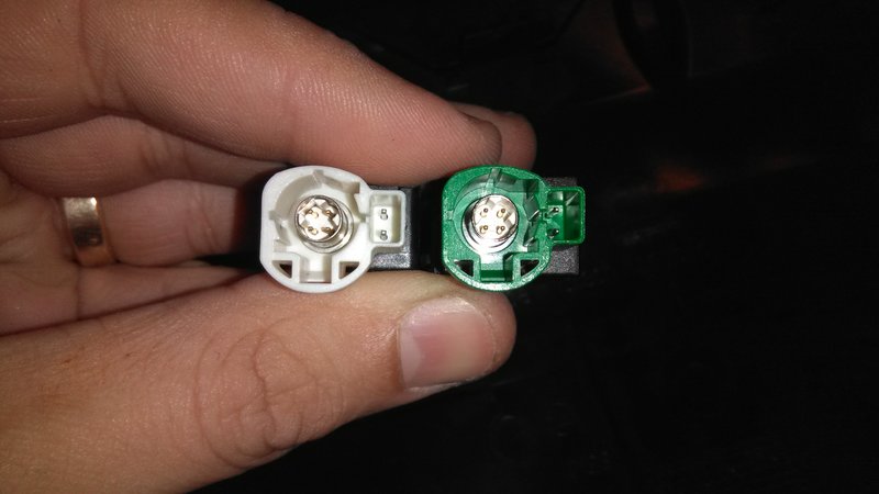

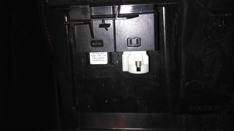

- USB & AUX-plugs are in a cradle, connector for the USB-plug is different than original

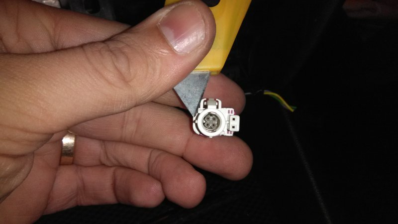

- ...which can be fixed with a sharp knife (or replacing the cable with a real one up to the main unit in the glovebox, i was lazy)
- Reassemble in reverse order

The AUX -plug [5Q0 035 724]? I just left it there, my original part number was identical with the replacement. There are clips on top and at the bottom holding those in place.

Just changed my USB plug. It would have been a 5 minute job if i'd realised the clip underneath needs pulling down rather than pushing up :D
I managed to do it without unplugging the climate connectors, resting the climate unit where the screen goes whilst changing the USB plug
