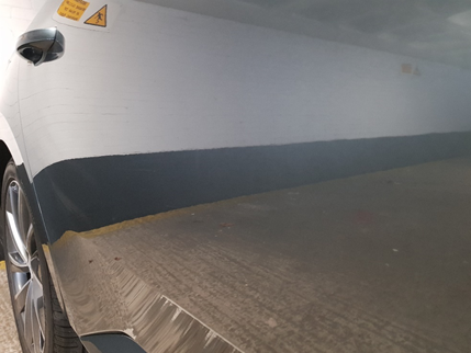

Looking for some advice (as usual):). I am planning ahead for when I next give the car (2017 Quartz Grey metallic Superb) a full clean back to bare paint before waxing. The car is pretty decent with just slight marking and a couple of minor scratches. After decontamination, washing and claying I was planning on using the Meguiar's Ultimate Compound and polish to get rid of these, (and scratch x 2.0 if needed on anything that the compound doesn't get rid of).
image.png.b763dc84fe4691ddfc5c5ca9798c301e.pngimage.png.dc7756473e9227c77236c99c77bb9db5.png
I've been very happy with the Megs products I've used previously, but also happy to try something else. Any recommendations? I will be doing the car by hand as I don't have a DA. FYI I will (definitely) be following it up with Fusso 99 dark and (probably) Meguiar's Ultimate Wax on top. Thanks in advance.

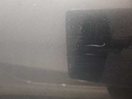

Hi @Wardy and thanks for the detailed answer. The car isn't in bad nick...
I took out the deeper scratch in the shot below using Megs Scratchx2.0, but you can see the little horizontal scratches around it. It's this level of marking I'm looking to get rid of. It looks worse than it is in this photo - the spots are dirt as I took the pic before washing. I haven't noticed a huge amount of swirling, though I'm sure there is some.
The car is a daily driver and gets 25k+ miles a year on it, so I'm never going to get or keep it to concours or anything like. I'd just like it to look as good from a foot away as it does from 6ft.

In your position I'd go with a small bottle of the Menz Medium Cut - ideal because you won't use a lot on specific areas:
http://www.polishedbliss.co.uk/acatalog/menzerna-234.html
Then I'd go with the Megs polish you've been given, which will be useful as it'll refine the finish. I'd then really recommend the Black Hole glaze, which will fill, enhance and give you a great base for a sealant. A sealant stage I'd really recommend given that annual mileage, as you've then got a great barrier in place, for when any wax or LSP breaks down and diminishes. Especially in the winter months when it can be tricky to top up protection.
