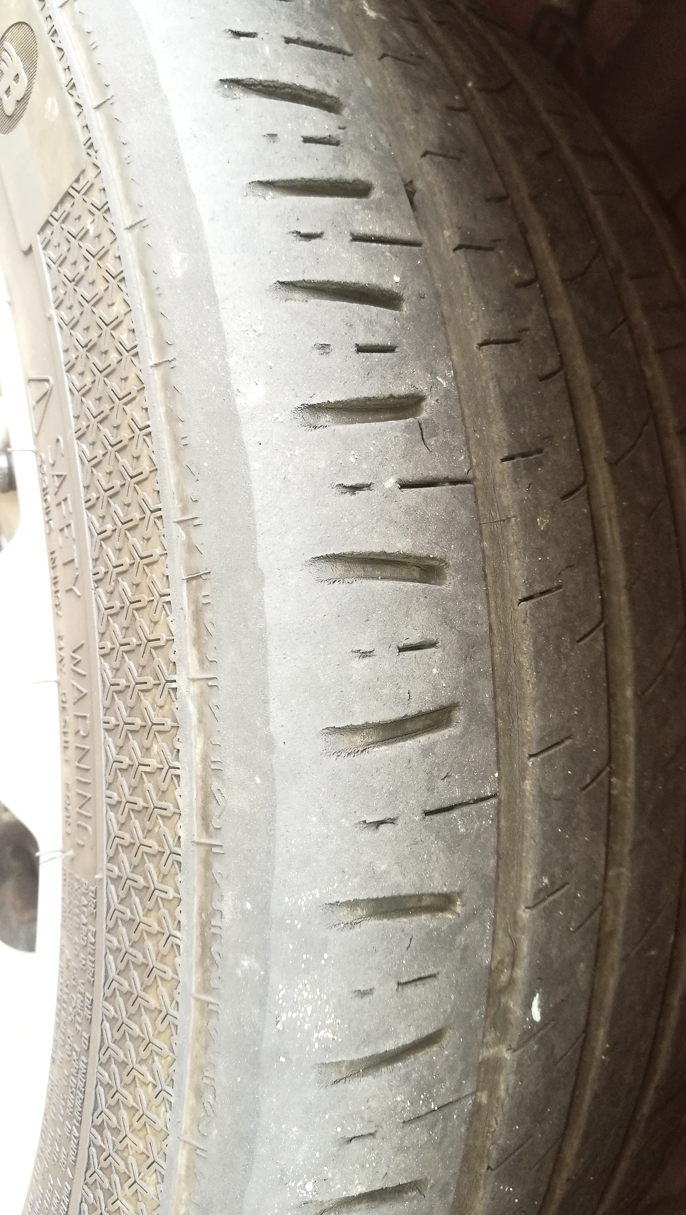

has anyone else experienced this issue with the fabia  mk2?
The sidewall of both front tyres are wearing out pretty fast compared to the rest of the tyre. Some topics say it's because I take roundabouts to fast but that's not really my case. It had it's wheel alignment and tracking done about 8 months ago but it's still wearing out pretty unusual. The tyres I had before were bridgestones, now i'm running barums and have the same wear pattern.

I believe you mean the outer part of the tread, not the sidewall.
Forget that you had the tracking done X number of months ago-- get it done again by someone using a Hunter alignment machine.
Your wear pattern suggests that you are toeing in too much. Also check that you not running under inflated

You are correct, not the side wall but the outer part.
They too used a hunter with all the gizmos. I'll go to a different garage then.
I would also suggest swapping fronts for rears as you will otherwise wear them to below safe limits. The sides do wear quicker but only to a degree, hence the legal limit (1.6mm for cars, 1mm for motorcycles, visible tread for mopeds) Is measured from the central 3/4 or 75% of the tyre.
If you had the tracking domne 8 months ago, it is hard to say they did it properly or not as, within a month, say, you could get them to re-do the job if you noticed an isue but in 8 months and a tyre swap, you could easily have hit a kerb or pot hole, etc and ruined the setting. I had mine done some time back by a very reputable shop and they advise that the tracking was not quite tweeting close enough for their liking, despite being within tolerance (Fussy garage) The guy suspected a slightly bent suspension leg so suggested if they wear again too soon, get the front shocks replaced prior to new tyres and  a fresh tracking check. Do not rely on any garage changing any suspension part, such as bushes, c.v's etc, without a full proper tracking check as unless they do it properly, they are just guessing where the setting LOOKS like it should be. Proper, accurate tyre inflation will also help, not the old "Kicked the sidewall, it looked fine" Routine!

Is this excessive? Both look the same. They have 4000 mi

I've experienced this strange wear on our 2013 Fabia but not on all other Fabias we have/had.
This particular Fabia has had front suspension work done at Skoda because of recurring problems with steering rods. "Front suspension totally stripped and rebuilt" is what it says on the report. The alignment was done on the factory approved Skoda/VAG rig.
To me it looks like a camber issue. I am told by a master tech that camber can be adjusted by moving the subframe but is very difficult to get right.

OK this is an Octy, not a Furbie, but I've never had had edge wear like that on Barums, so I'd agree it looks like a geometry issue.

Turns out it's the control arms bushes. Apparently they are too soft and there's a lot of play when wiggled around.

"Turns out it's the control arms bushes. Apparently they are too soft and there's a lot of play when wiggled around."
Whilst this may be true - I do believe you are a little over expectant that this will produce the final required accurate result. Scores of other cars have this same play in evidence - but are not ripping out tyres to the degree of your illustration. The illustration clearly indicates the the car is toeing in excessively - therefore the outer edges of both tyres are presented as the primary contact/wear point.
Fit the bushes if you think this to be the answer by all means, BUT, nevertheless ensure that the tracking is checked / corrected by a competent person using the hunter machine.
When this is done (as suggested by another poster) it is necessary after say a month, to carry out a second check.
You really are at the mercy of the machine operator, and truth be told, not many have a complete understanding of full and complete accurate application of the machines capability'
I assume that a full check of the subframe position and security has been made?
