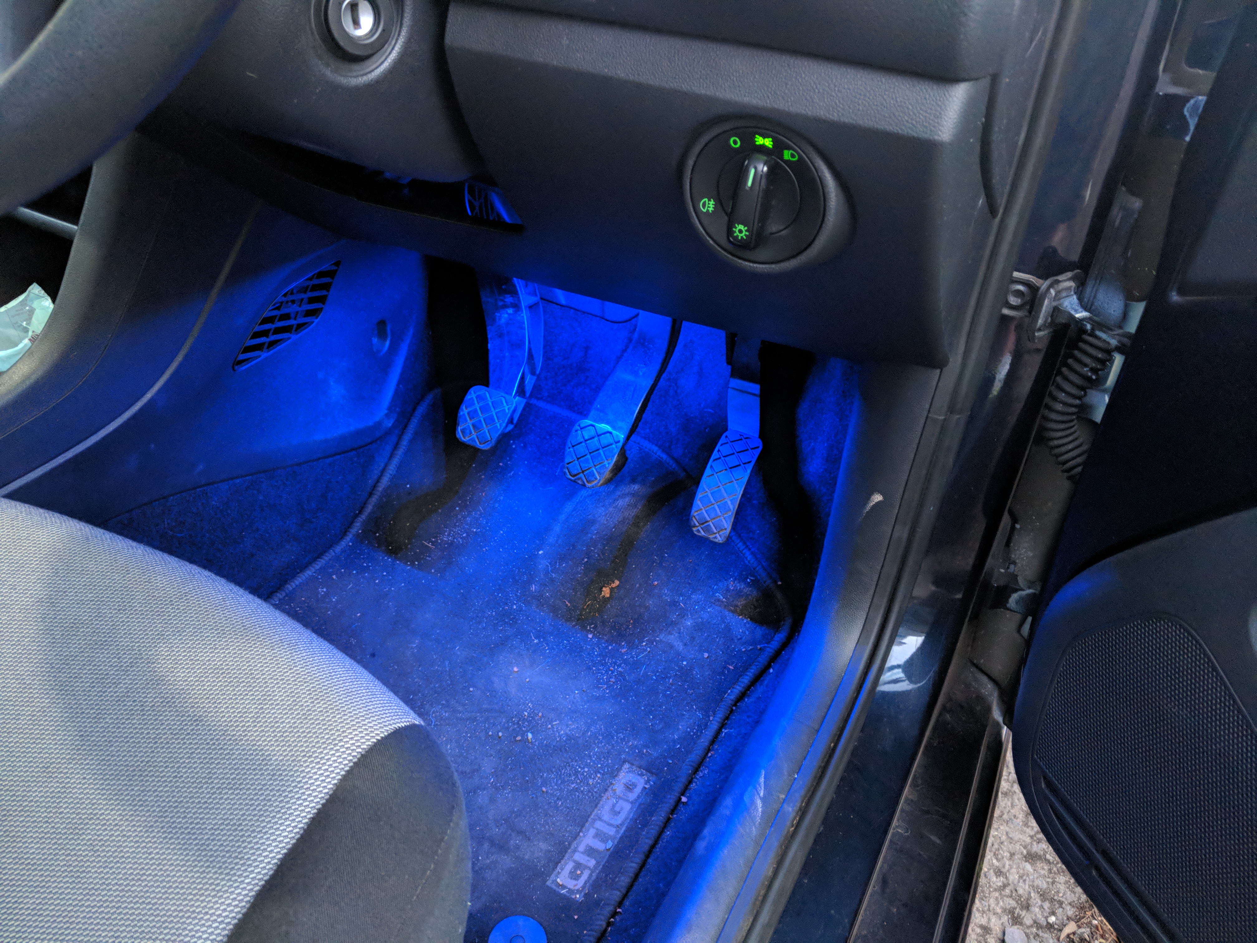

Well what a pain in the bum that was
never took a car apart that was so difficult and stiff
nothing broken thankfully and dash cam and led footwell lights installed
