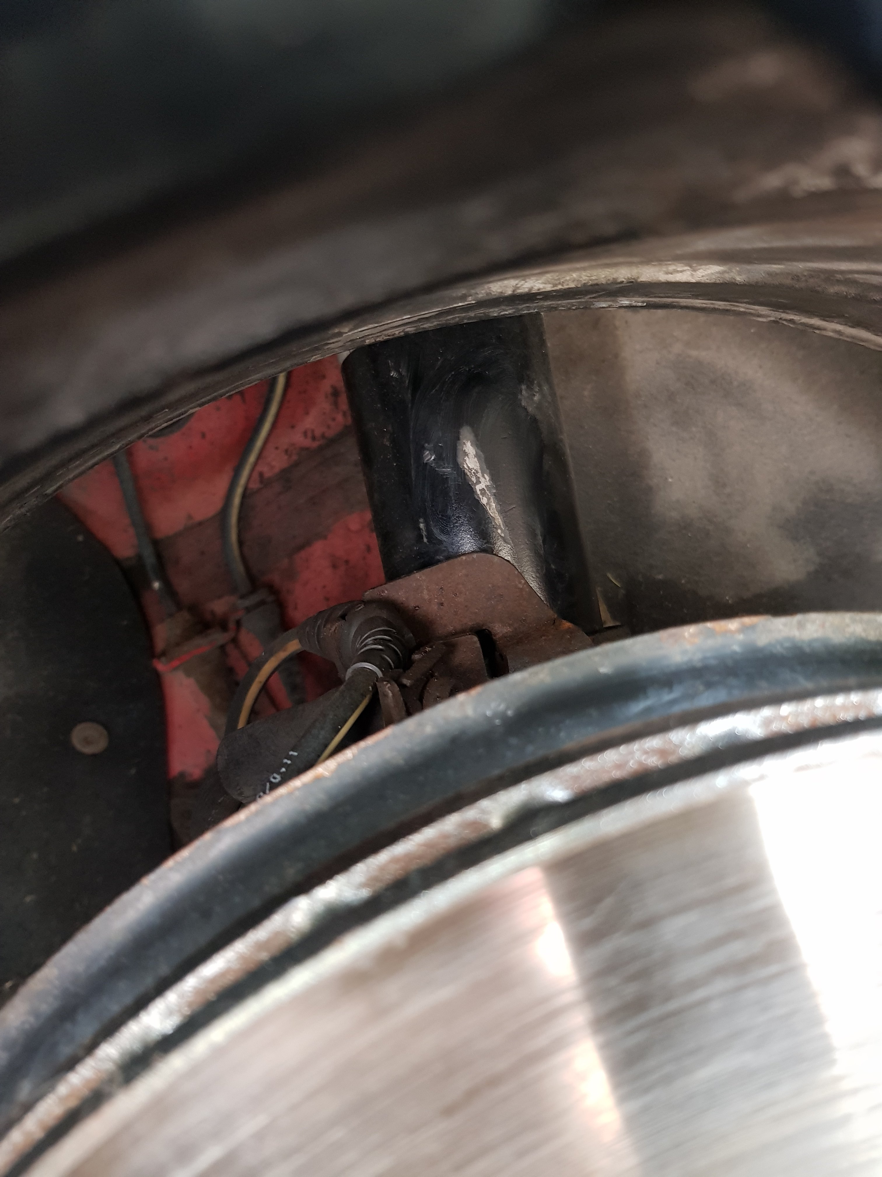

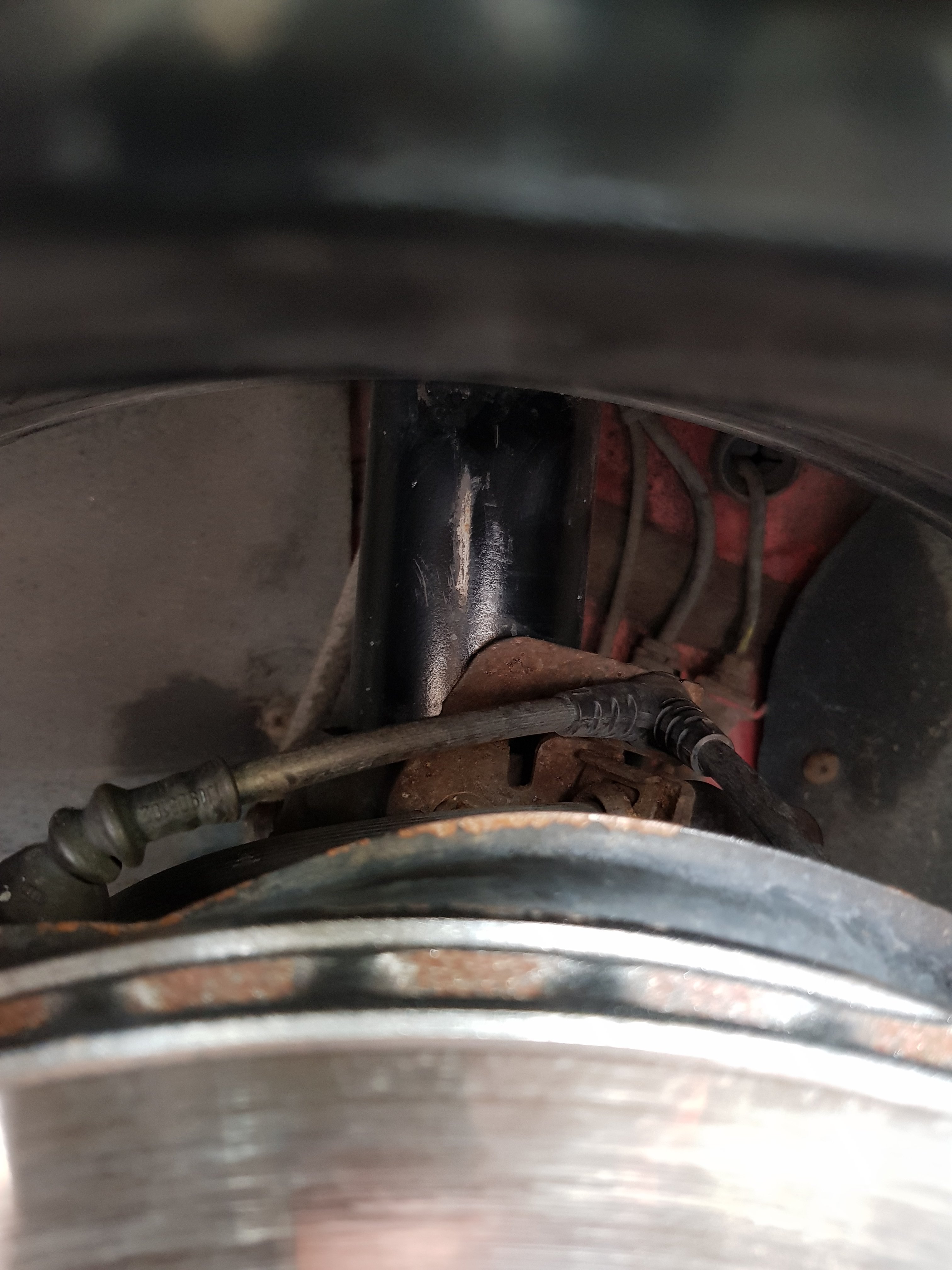

Metal plate hitting/rubbing on dampers.
Been getting squeaking when going over bumps for a long time. Recently upgraded springs and dampers as it was on my to do list anyway. Still getting the squeaking or squeal noise.
Cleaning the alloys properly today I noticed this, as they are new dampers it was easy to see the paint being rubbed off. Looks like the rusty looking metal part is hitting the dampers when going over bumps.
It could be this at fault but either way has anyone got any advice?
MK2 Facelift. Both fronts are like this.
I would ask myself if the same scraping was evident on the old units... Did you do the replacement yourself or had a workshop do it/ If they did it, go back and ask them to check the clearance. Might just be a little bit of bending/straightening needed but might be worse!
Well I was getting the same noise on the old dampers when hitting bumps.
A trusted independent garage did the work and the old dampers will be long gone. I have gone out and bent the plates back a bit. Apparently they are there to hold the ABS wire. Also sanded the backs of them down slightly.
I will report back after a few days of driving!
Nope, annoying squeak or squeal still there when going over bumps and touching the brake pedal. Back to square one!
