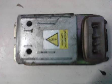

Thanks for your help. I found the solution but do not understand how come.
It was that thing in picture
That is the electronic ignition module. It has nothing to do with engine overheating.
Once i had changed it, every thing went alright. May be some hesitation in electricity?
Not possible as far as i know even if the spark was weak out of time or whatever it would NOT cause the engine to overheat this much
Even the leanest of conditions wouldnt cause such dramatic overheating
Did alongside this module change had anything else done to the car?
The car was suddenly stopping. And this disappeared after changing it. And by the way i do not understand too what happened. But there is no more overheating.
