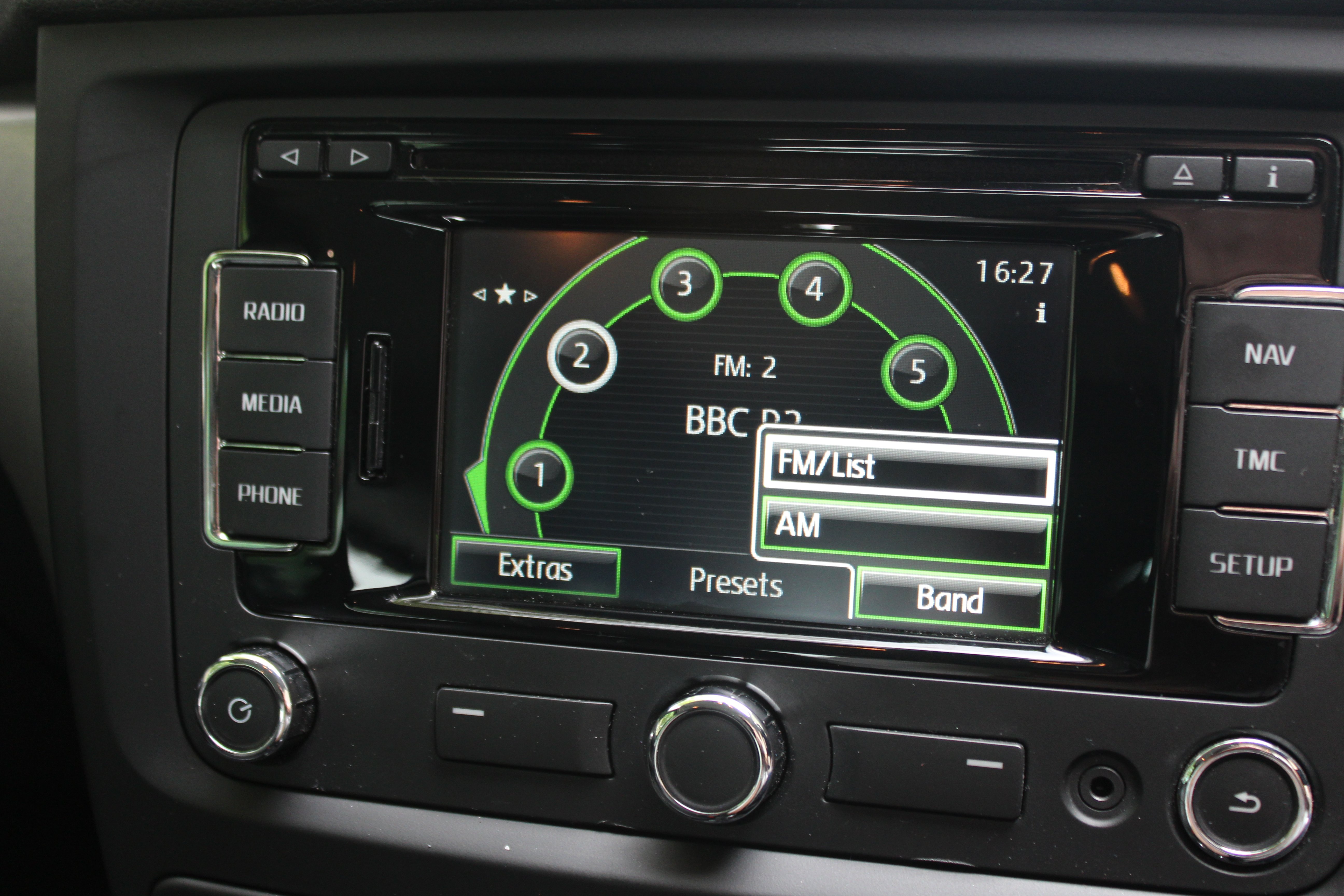

I recently retro fitted a Amundson + unit (thanks LGM) and
I notice there was black plug on the rear is that for dab ? as
I also fitted a dab aerial (thanks Rustynuts) but no dab
what is the black plug for ???
Black plug is the DAB aerial. You need to connect the black extension cable I sent you to the black plug on the rear of the Amundsen, and then onto the black plug on the aerial base.

hi mate
I have done that but no sign of dab on the stereo listings
if I go in to the band it only shows FM/listings and below that am?
It should show DAB if it's a DAB unit, and the black plug on the rear would indicate that it is. Try a disconnect of the quadlock and then reconnect to see if that works.
just removed the quad lock and no difference
Not sure then. Are you certain you connected the black plug to the black connector on the aerial base rather than the burgundy one?
ill double check later but im sure I connected the black lead you supplied to the black lead on the aerial
surely the black plug wouldn't fit the purple one would it??
No, it shouldn't. Even if disconnected you should still have the DAB option on the head unit.
had a reply from the seller and he thinks dab needs to be enabled via vcds
the unit works ok other than the dab so hopefully it just needs to be 'coded' for dab
There certainly is a bit to deactivate DAB on the RNS-315 so it could be that :)
ok mate cheers for that

Was it just a VCDS coding then?
yeah
looked into the 'hidden bluetooth' coding setup as described
didn't realize that you had to turn on dab
me being 'old school' thinking just plug in and all is ok !!!
